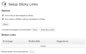

This screen shot shows how internal links look like in the database, once Sticky links are enabled:
Links turned Sticky by WPML
Your users will never see these “strange” links. Instead, WPML will replace them with the current permlinks when displaying the pages.
Sticky links controls
to enable Sticky links, go to WPML->Sticky links.
Select ‘Enable sticky links‘. Once enabled, WPML will let you batch replace all regular links to sticky links. It will also report any existing broken links and help fix them.
You can always revert this operation by clicking on ‘Revert sticky links to permalinks
