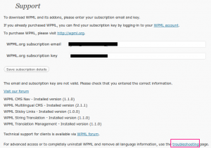

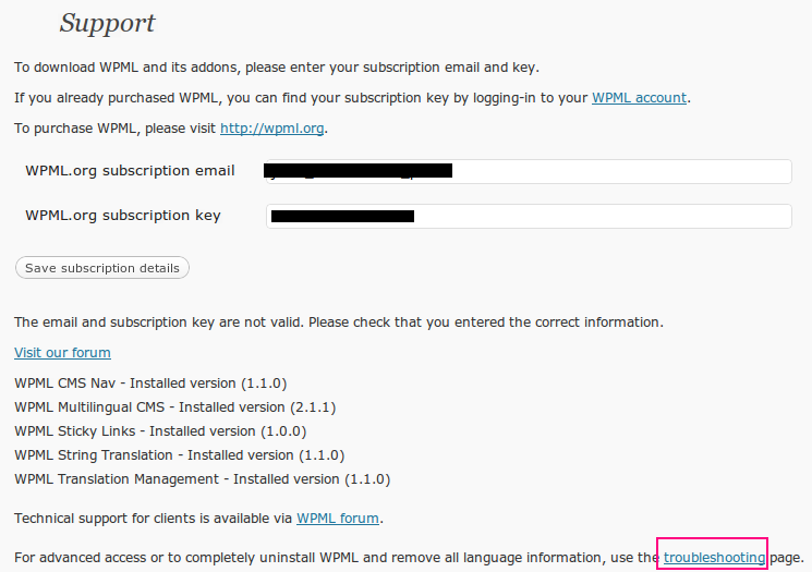

Go to WPML->Support->Troubleshooting. The troubleshooting link is located at the bottom right of the page.
