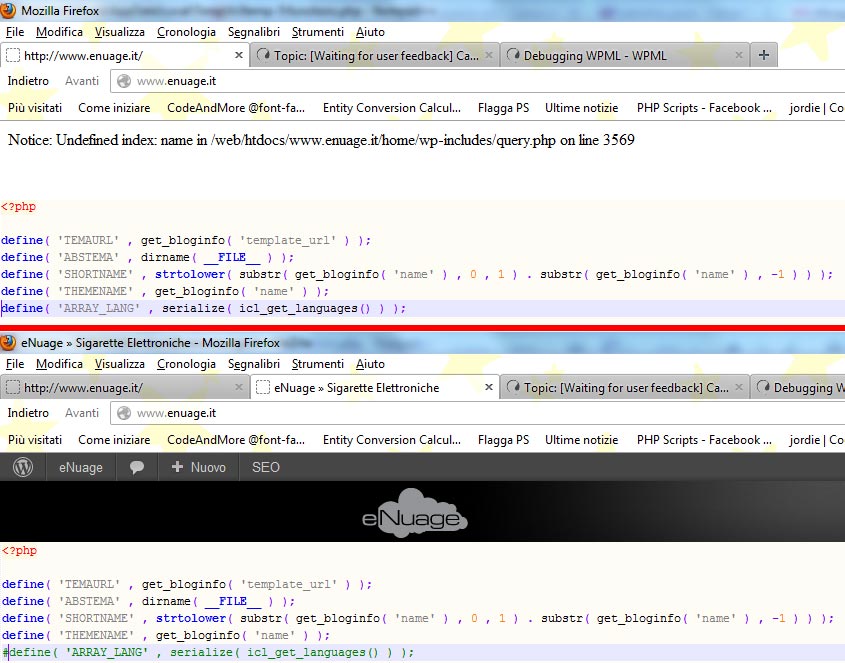

December 18, 2012 at 2:11 pm #91675
benedetto
Thanks Harshad for your reply:
i did exactly what you said to do, and the only output in error_log.txt is
[18-Dec-2012 13:59:04 UTC] PHP Notice:  Undefined index: name in /web/htdocs/www.enuage.it/home/wp-includes/query.php on line 3569
That output is also visible when wp_debug is set to true.
If it can help you, im going to attach my home status when icl_get_languages is declared and when it is commented out.

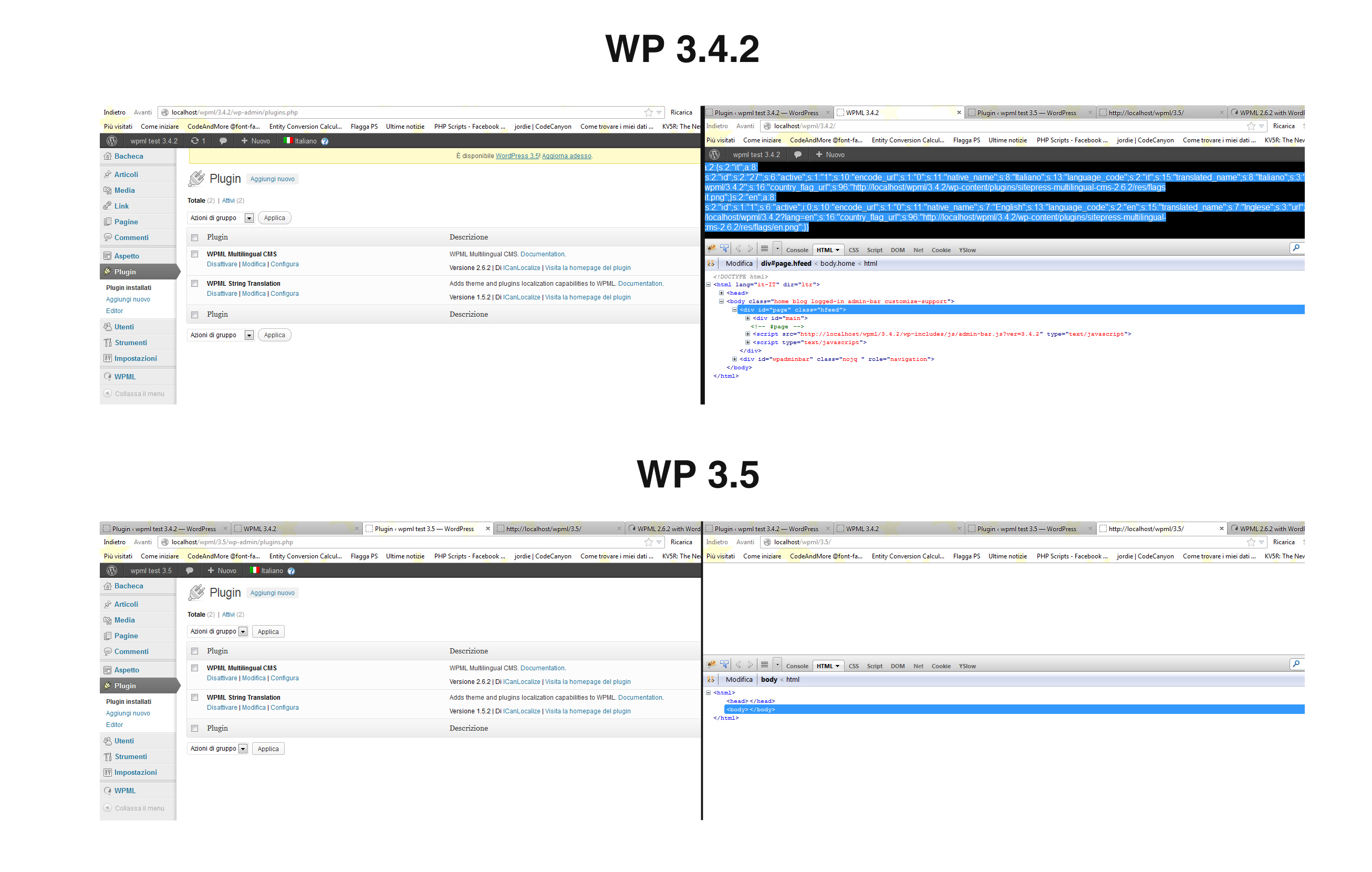

December 19, 2012 at 10:54 am #91907
benedetto
Hi Harshad,
unfortunately i can't give you those details, but i can give you some information about debugging:
I tried WP 3.4.2 with the latest version of wpml and string translator, and it works fine.
Upgrading WP from 3.4.2 to 3.5 causes the crash of the frontend when i declare that define.
I suppose, then, some incompatibility with the new WP.
I'll attach my results as image and i'll send to your email the theme i'm using.

December 20, 2012 at 10:33 am #92229
benedetto
Ok, with the new version you sent to me, it doesn't crash in 3.5
Hovewer icl_get_languages() returns " a:0:{} " when defined in functions.php, but i guess it's not a big problem to solve :D
The theme is always the same.
I'll attach the output.

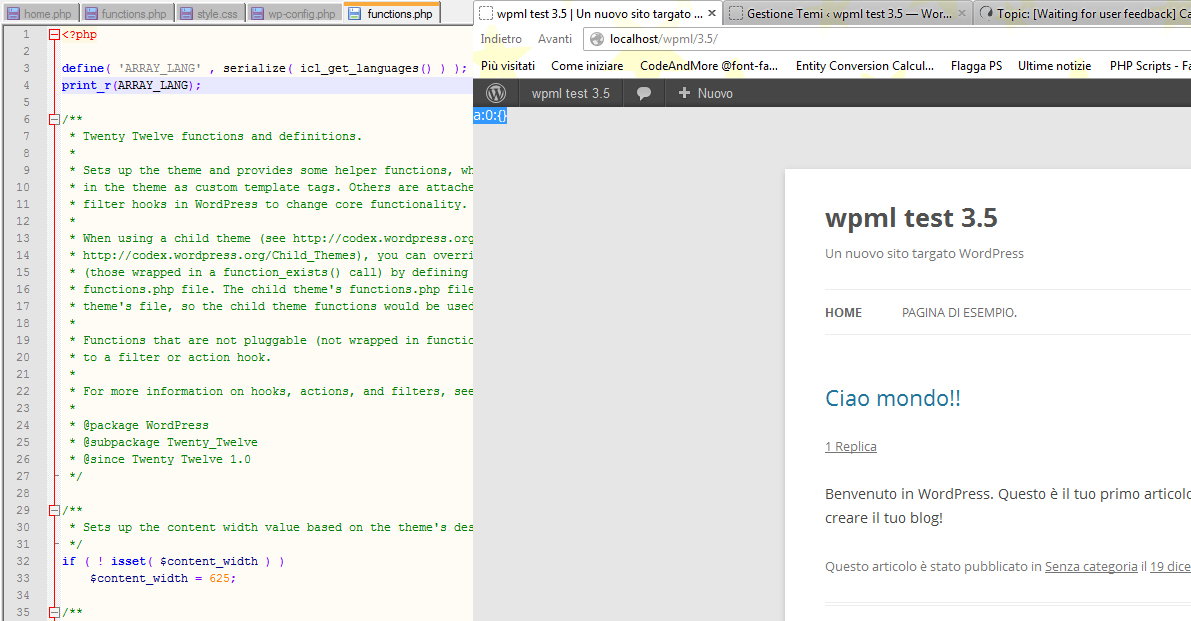

December 20, 2012 at 2:15 pm #92314
benedetto
I switched to Twenty Twelve and added that code in functions.php of the theme itself at the very top ( as you can see in the attachment) ; the output is the same: " a:0:{} "

That's strange at my end I can see the serialized array
December 20, 2012 at 4:13 pm #92363
