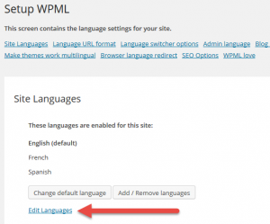

You can add a custom language after your site has been set up by going to WPML → Languages. See the following video for step-by-step instructions:
To add a custom language:
Go to WPML → Languages and click on the Edit languages link.
Editing a site’s languages

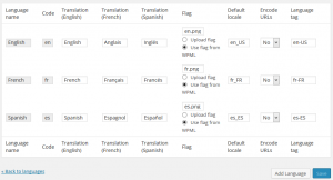

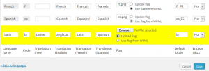

You will see a list of the languages on your site. Click Add languages to add a new row to your languages table.
Adding a new language
Complete each field as explained in the next section, and save your new language.

Language Configuration Fields Defined
When adding a custom language, you need to define the following fields:
Field Name
Description
Language name
The name you want to see in WPML’s GUI.
Code
The name for this language in the database. Once you set this value and add content, you should never change it, otherwise content in that language will be lost. This value is used in your site’s URLs.
For example, http://wpml.org/es-mx/, http://wpml.org/?lang=fr, http://de.wpml.org.
Translation (language)
The translation of the language name in the other languages on your site.
Flag
An image file with the country flag. WPML uses it in language switchers.
Default locale
The locale that will be active for this language when loading GetText translations.
Encode URLs
Determines if URLs in this language are encoded or use ASCII characters (leave it as no if you are not sure).
hreflang
The code Google expects for this language. The language tag should contain the same information as the locale name, but in a slightly different format.
For example, if the locale for Canadian French is fr_CA, the corresponding language tag would be fr-ca. Instead of an underscore, use a dash, and ensure all letters are lowercase.
To successfully save a custom language, make sure you see a confirmation message and no error messages. For example, you cannot add a new language that uses the code of a pre-configured language in WPML’s table, even if you do not use that language on your site.
