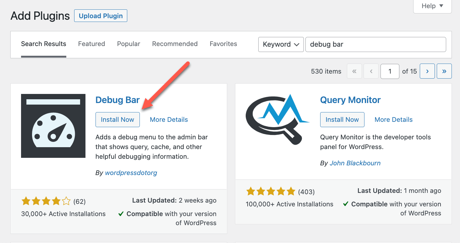

How can I install the Debug Bar plugin?
You can install the Debug Bar plugin via the Plugins page in your WordPress admin.
Installing the Debug Bar plugin
To install the Sort Queries add-on, download its file and upload it to your site.

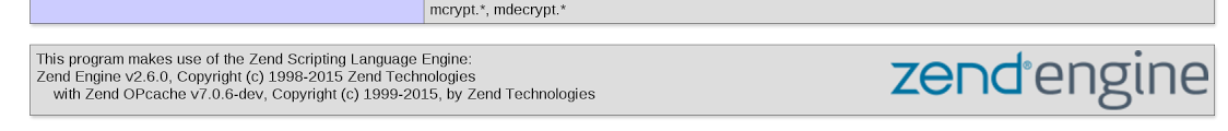

This is how the phpinfo file should look like when Xdebug is not running:
phpinfo when Xdebug is not running (good for performance benchmarking)
As soon as this does not contain any reference to Xdebug, you can be sure it’s turned off.
Whether or not other sections of this phpinfo file contain references to Xdebug is not important, so long as it is not shown as a loaded extension at the top.

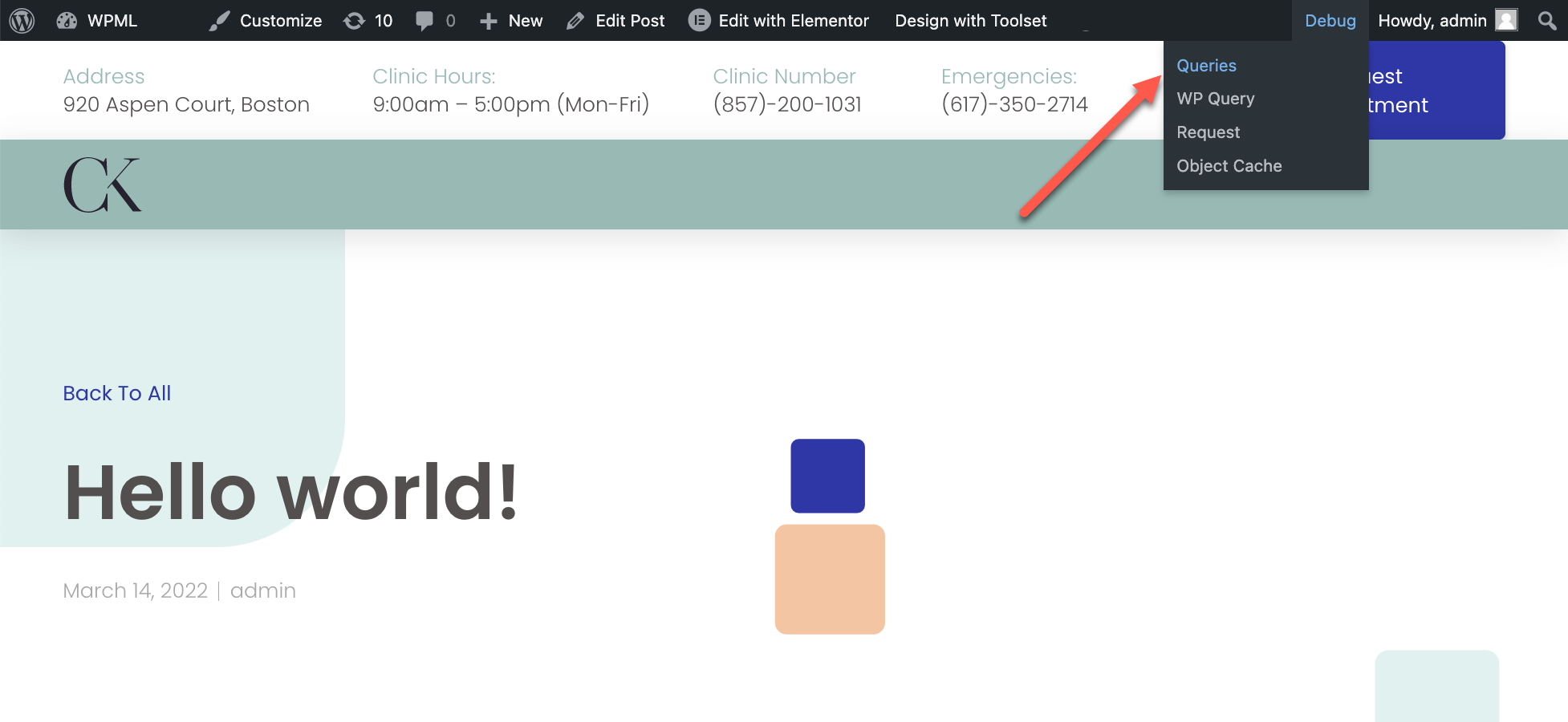

How to debug a page?
While logged in as admin, visit any page you feel is causing your site to run slowly. Then, from the top admin bar click on Debug → Queries.
Accessing Debug Queries from the top admin bar
A screen with the debug information will open.
