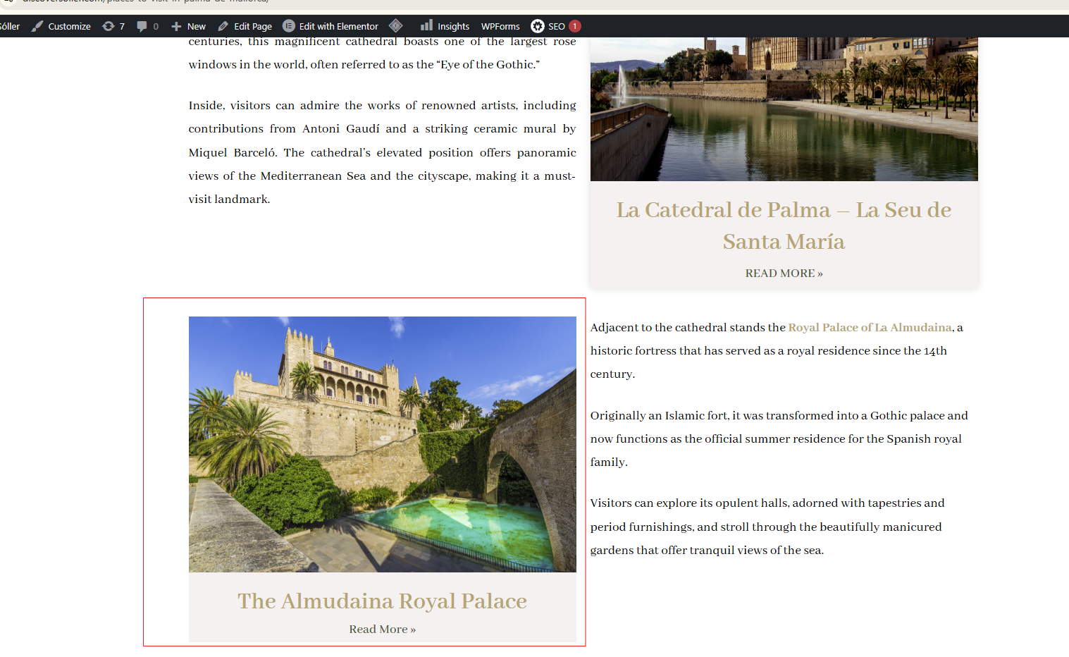

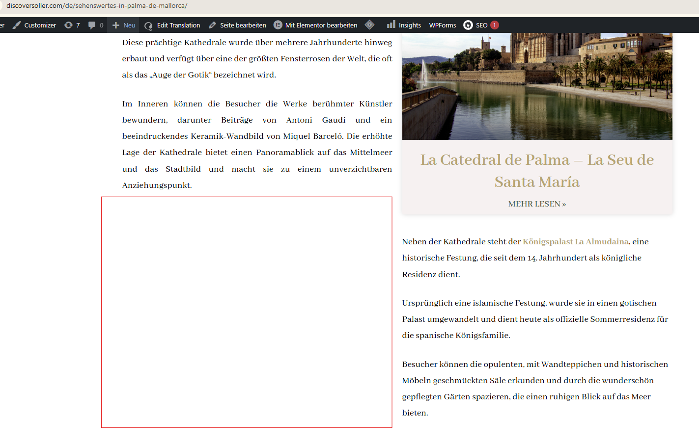

I am trying to switch languages on my website using WPML. When I switch to another language (Spanish or German) from the official language page (English), the Elementor widget 'post' does not appear. In the Elementor editor, it appears correctly. The issue can be seen on this page: enlace oculto
Síntomas:
The Elementor widget 'post' does not appear when switching to Spanish or German, although it appears in the Elementor editor. I expected to see translated content like The Royal Almudaina, Bellver Castle, or Beaches in Palma, but nothing appears.

Me parece que el problema no es el post widget de Elementor sino la traducción del post.
Si te fijas la entrada que si aparece, y sigues el link:
enlace oculto
usando el selector de idiomas puedes ver el contentido.
En cambio, la que no aparece:
enlace oculto
cuando vas a la entrada y cambias de idioma ves un 404.
Podrías por favor asegurarte de que las traducciones están publicadas (no son un draft) o que no estén en la papelera?

Thank you Otto. It seems that the pages on other languages were on private mode. Now I have published them and now are available!! Thank you again.
