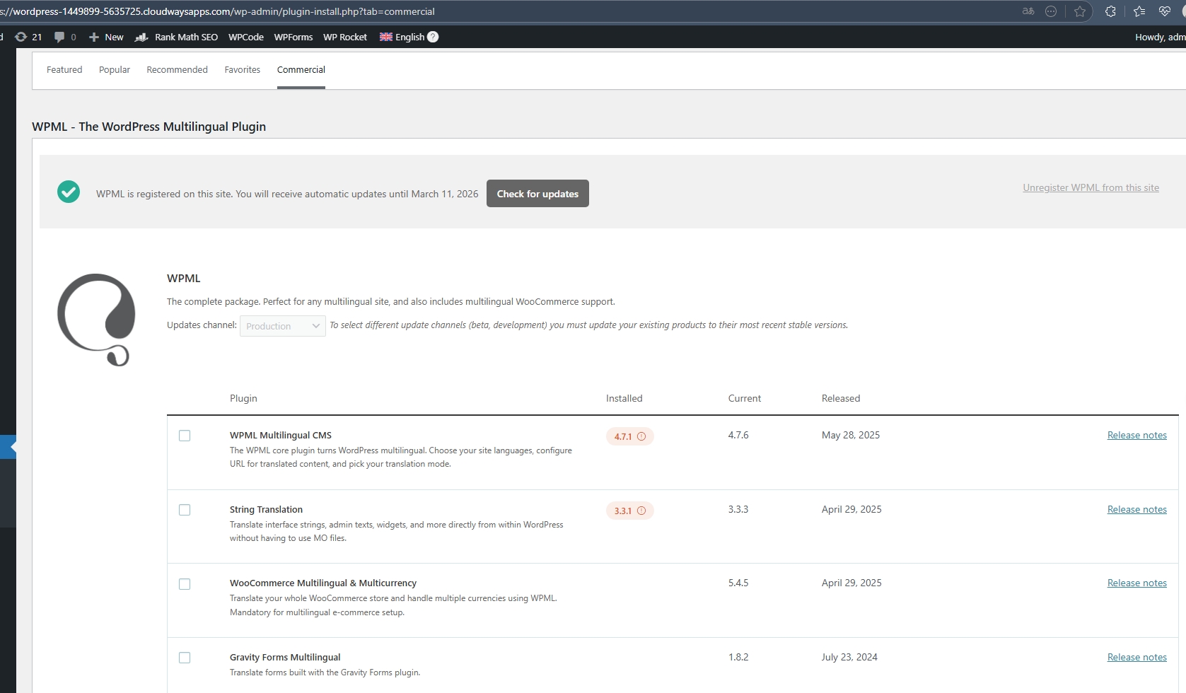

我在使用WPML时遇到了问题,创建了翻译任务并翻译后,状态一直显示In progress。我为网站分配了翻译点,但网站上却显示不出来,也无法自动翻译。查看错误日志:{"errorData":{"status":400,"title":"Api error missing resource","detail":"No sitekey found for this website"}}。sitekey 在哪里设置?
翻译任务状态显示In progress,翻译点无法显示,无法自动翻译,错误日志显示No sitekey found for this website。
sitekey 在哪里设置?

July 8, 2025 at 12:31 am #17211445
williamc-41
你可以看到WPML is registered on this site.
这个网站是我从原网站复制而来,只是用的语言种类不一样。我的主网站,feelingwoodwpc.com是好的,但这个复制的过来的网站有很多问题。
July 8, 2025 at 7:50 pm #17215993
Itamar
WPML Supporter since 02/2016
Your site hidden link is still registered with the site key flT8ZzYWhW, which is the same site key used for hidden link. You must click the "Unregister WPML from this site" option and then insert the correct site key, which is: 1f6aca022c. After that, please update our plugins to their latest versions.

July 9, 2025 at 1:03 am #17216468
williamc-41
Thank you very much, the problem was perfectly solved.
