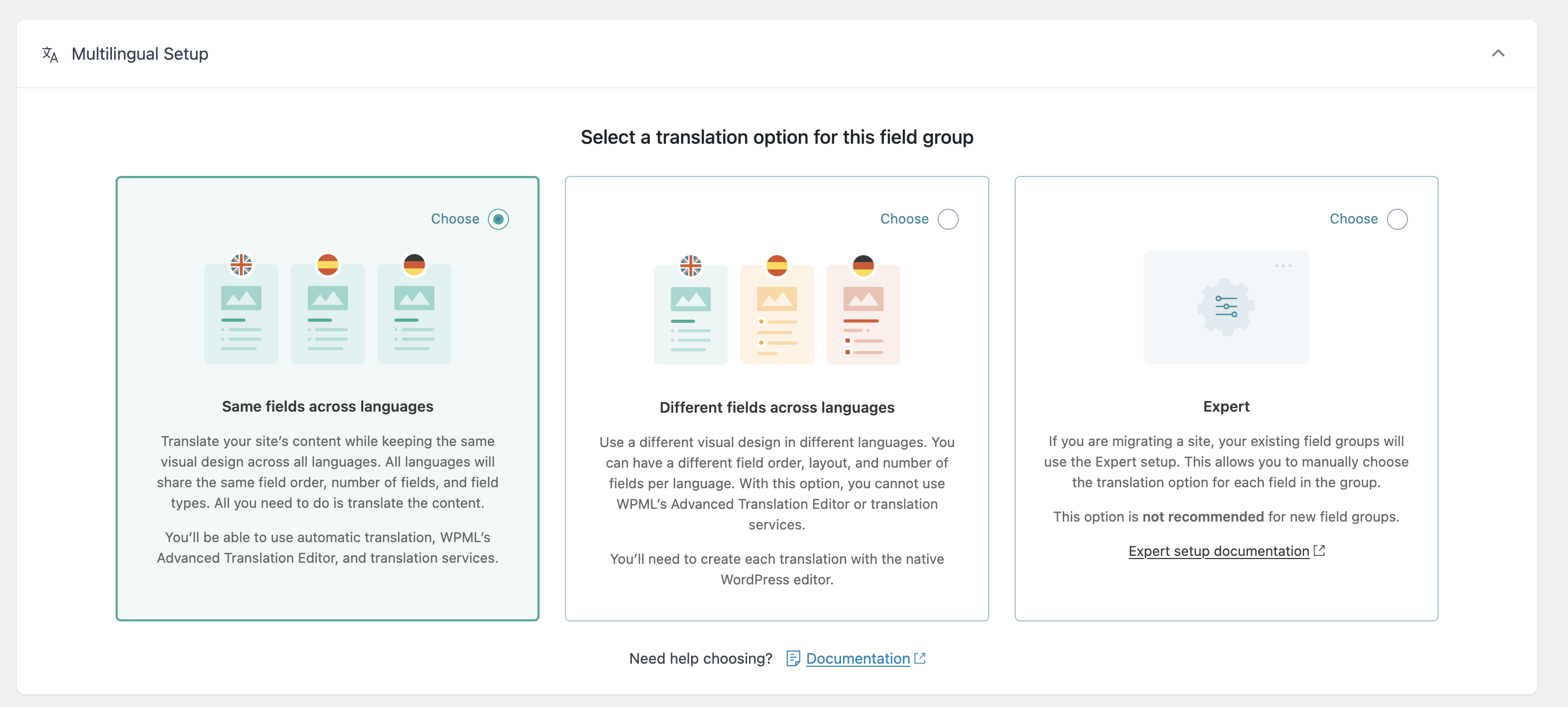

May 12, 2025 at 9:21 pm #17024643
Bobby
WPML Supporter since 04/2015
Thank you, I was able to locate them.
A few things I noticed:
1. In the ACF options they are all set to Same fields across languages
This would mean that the content will be the same accross all alnguages and not translated.
2. However, the fields themselves are set to 'translate' which is what is allowing you to translate them
I am reviewing the homepage, at the moment it looks like all fields are translated and only the footer widgets are missing, am I correct? Apologies if that is covered in your video, unfortunately I dont have access to it anymore
3. Based on the above information it might be best to set all these items to "expert" which would allow you to have full control of them and still use the ATE editor.

Do you mean set the Field Groups to Expert?
May 13, 2025 at 8:22 pm #17029681
Bobby
Yes, if you set the Field Groups to expert you will be able to control each field and set it to the desired results. --- You are OK to leave them as is for now if it's working OK.
