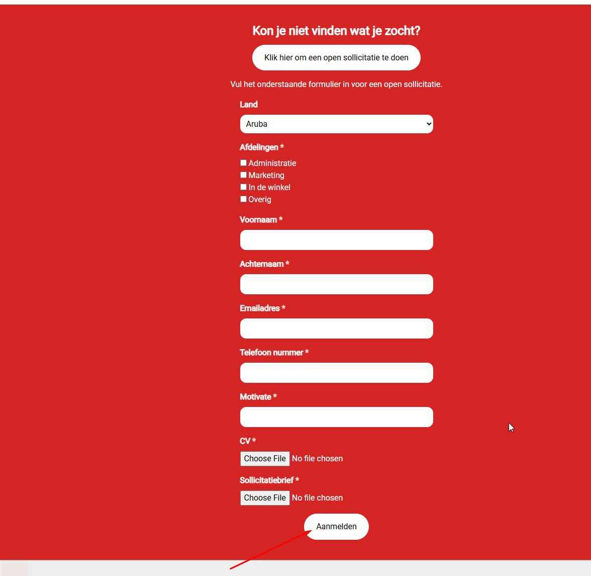

hidden link and as is shown here in the form on the frontend hidden link it should read "Aanmelden" instead of "Apply" and some messages are not registered like "Validation failed. 8 fields require attention" and "Form updated"
The form in question: hidden link
May 22, 2025 at 12:15 pm #17061485
WPML Supporter since 08/2022

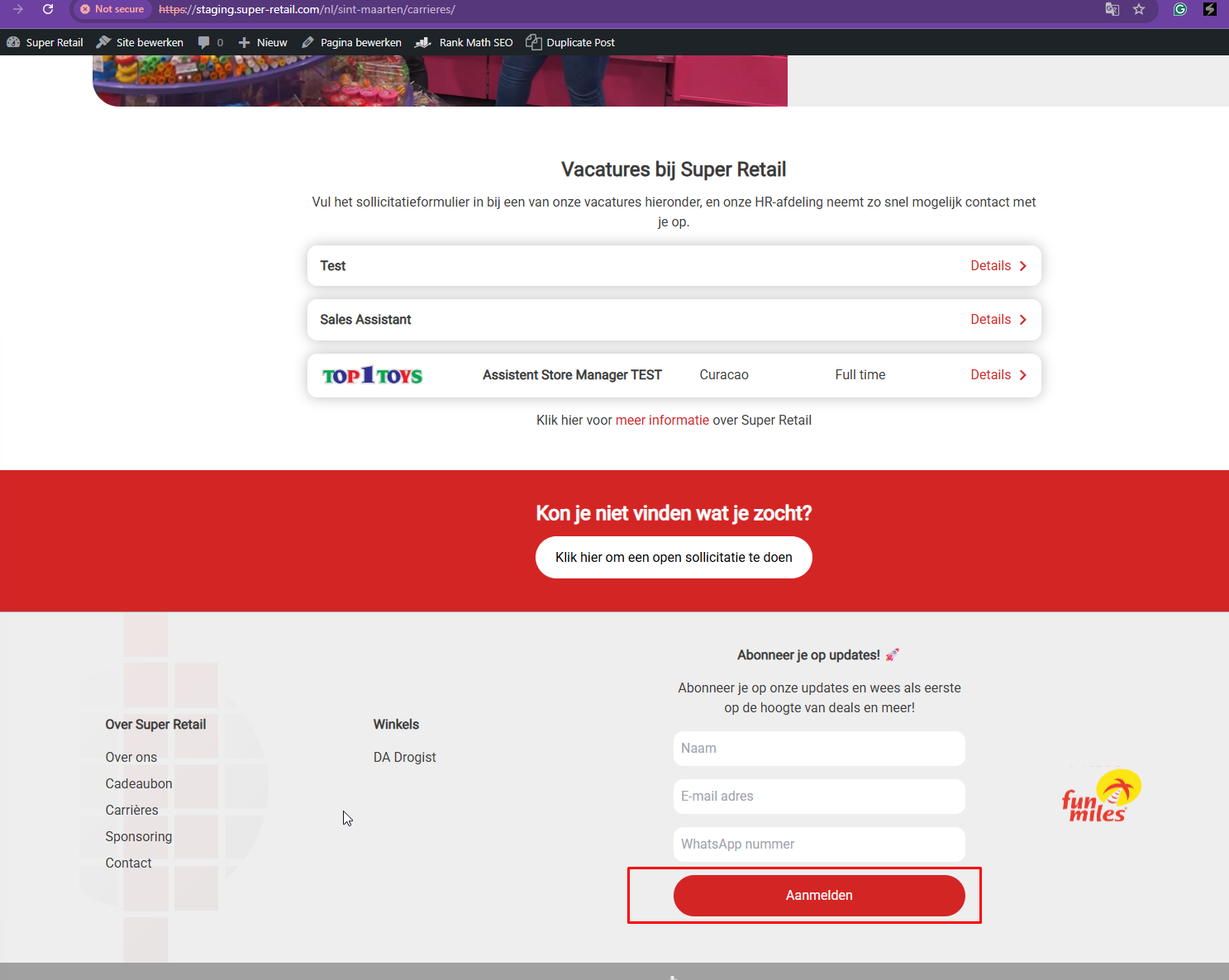

Thanks for your reply. I've checked this page hidden link and the "Apply" button is showing correctly as "Aanmelden" as shown in the attached screenshot.
May 22, 2025 at 12:18 pm #17061503
chicoO-2
That is a CF7 form which is translated correctly. The ACF-E form is hidden by the button "Klik hier om open solicitie te doen"
May 22, 2025 at 3:24 pm #17062743
Thanks for your reply. It seems to work fine when I manually translate the form here hidden link
I've enabled translation for the forms in WPML > Settings > Post Types Translation > Forms (acfe-form) > Selected Translatable - only show translated items
Frontend here hidden link as shown in the attached screenshot.
