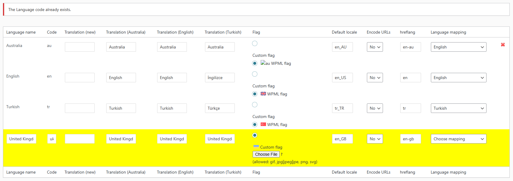

May 13, 2025 at 7:22 am #17025370
victorB-30
For example, if I want to have United Kingdom (uk) it gives an error that the code already exists, this is due to the fact the it is confusing the country code with country language of ukraine, also (uk).
Thank you
May 13, 2025 at 8:54 am #17025984
Andrey
WPML Supporter since 06/2013
Thank you for the explanation.
It is impossible to delete pre-configured languages with their language codes or to add a custom language using the same language code; however, you can change them.
Here are the steps:
1. Activate the Ukrainian language.
2. Update the language name translations, flag, default locale, hreflang, and language mapping.
I hope this helps.
