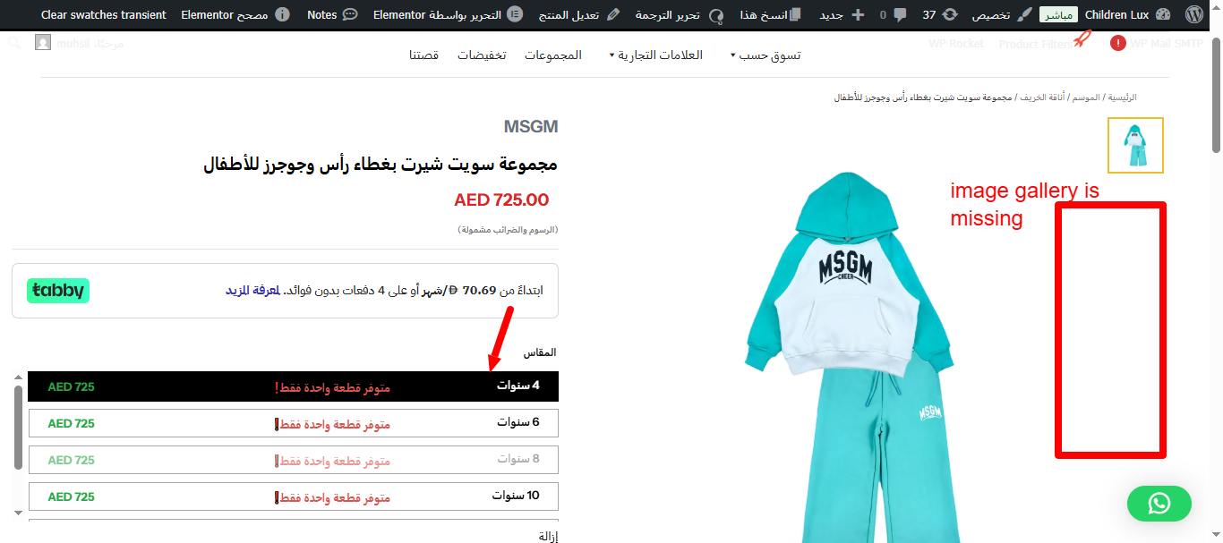

January 17, 2026 at 2:30 pm #17739102
jointP
Additional variation gallery images not getting in arabic version hidden link
when you go the arabic version of this product you wont be seeing the full variation image gallery images, why hidden link
January 17, 2026 at 4:41 pm #17739275
Thank you for reaching out!
Please revise WPML > Settings > Custom Field Translation and make sure that any field that relates to such variation settings is set to "Copy".
In this case, it likely is woo_variation_gallery_images
This is a common field used by variation gallery plugins (e.g., Woo Variation Gallery). If not set to “Copy” in WPML’s Custom Fields Translation settings, the gallery won’t appear in translated variations.
Also, make to set the field th_custom_attribute_settings to "Copy".
After that, update the translation of an affected product.
Also, revise WPML > Taxonomy Translation, select your product attributes, and make sure that these global attributes are translated.

January 21, 2026 at 12:12 pm #17750163
jointP
That doesnt help, how can i give you the admin access

January 27, 2026 at 8:28 am #17765550
I can confirm that the translation for variation images is not working as expected on your site.
Before we start any tests on your site, I need to ask you to update the theme and all plugins, as we need to make sure that the issue persists while using the latest versions.
Please make sure to take a backup of the site, including the database, before running the updates, and after that, test again by editing an affected original product and then updating its translation.
If you could set up a staging site for those tests, it would be even better.
In case my suggestion is not an option, please let me know, and we will try to find a different solution, like taking a local copy for testing or providing a WPML test site for replication of the issue with a simple example.
