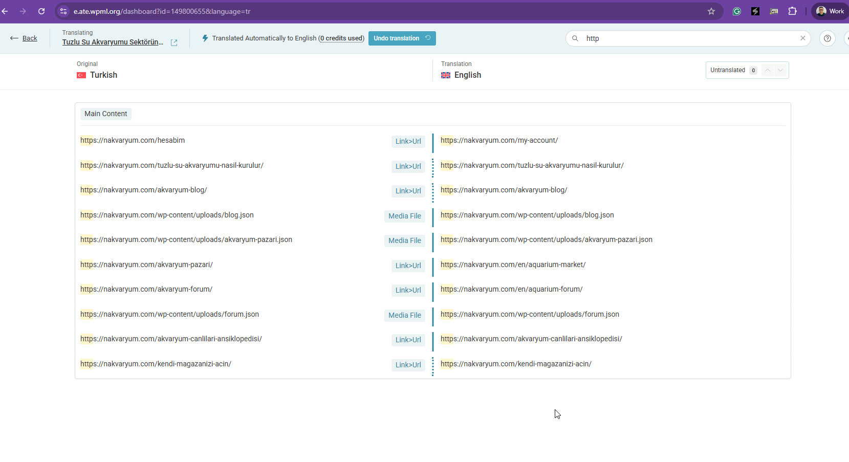

I'm trying to translate the homepage of my site hidden link using WPML.
Some links aren't showing up in the Advanced Translation Editor, preventing me from adding the native page link for that language.

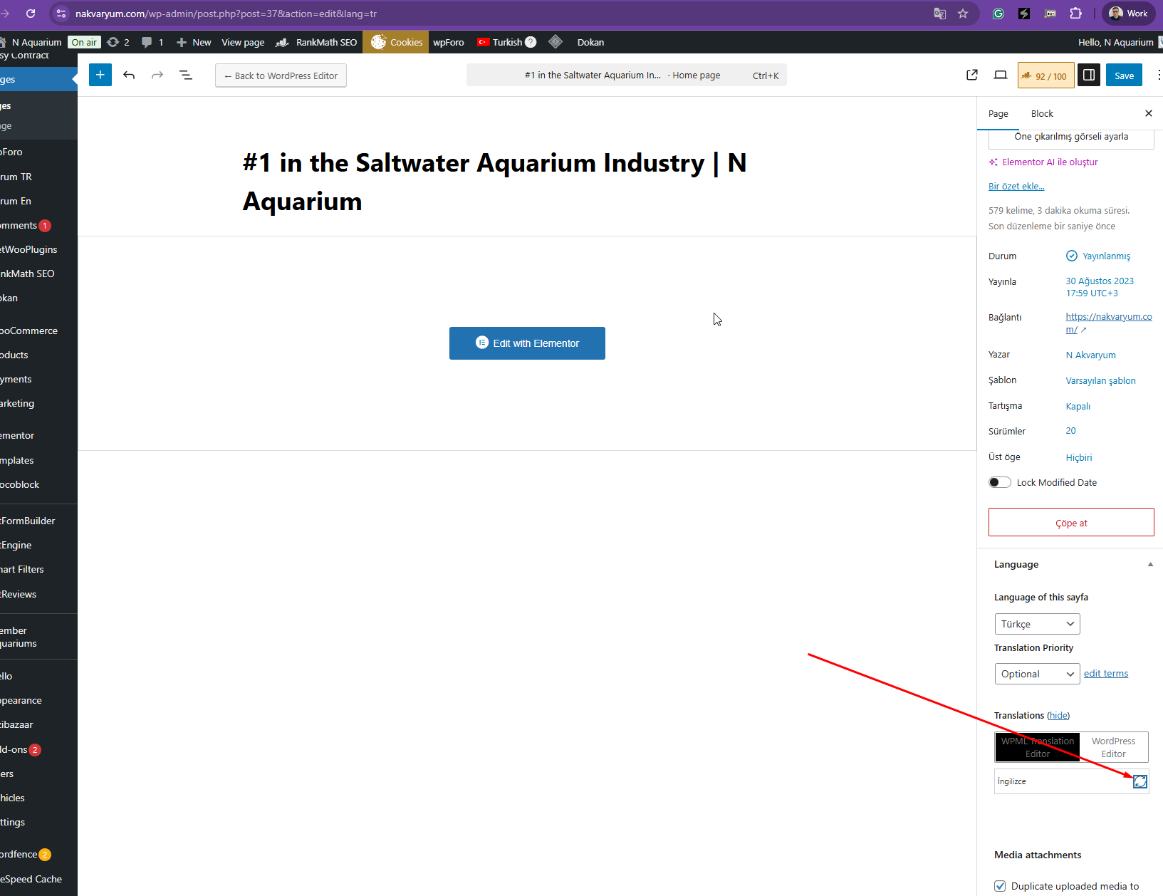

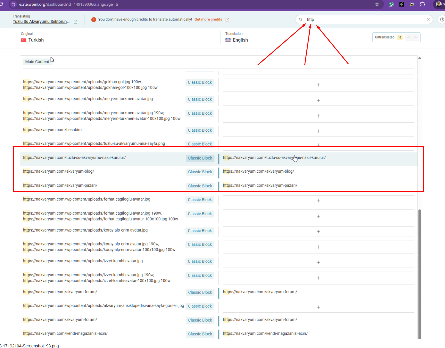

July 2, 2025 at 10:06 am #17192104
Thanks for your reply. I've enabled translation on your homepage here hidden link as shown in the attached screenshot.
In the Advanced Translation Editor, use the search form and type "HTTP". This will list out all links as shown in the attached screenshot for translation.

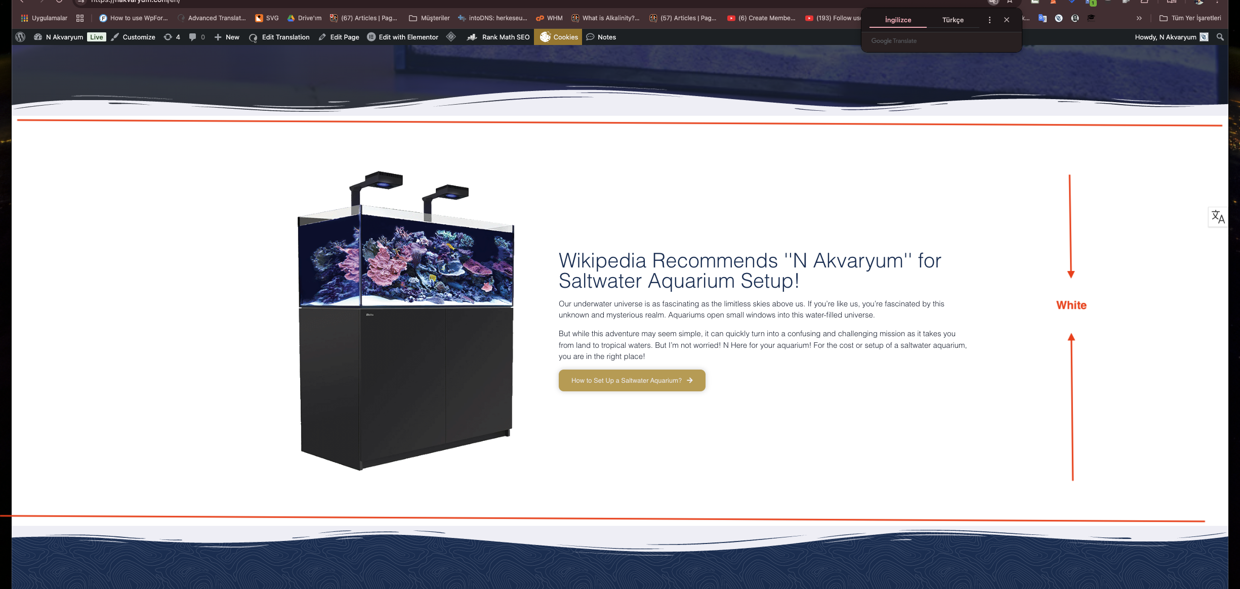

July 2, 2025 at 5:39 pm #17194439
fikretT
This is a bit strange. Do I need to do this every time? I also noticed that the design looks different when the translation is complete. Some background colors are not editable. Am I doing something wrong?

July 7, 2025 at 1:16 am #17205821
Thanks for your reply. As mentioned previously, you need to use the search form and type "HTTP". I've highlighted it using the screenshot. Could you retry?

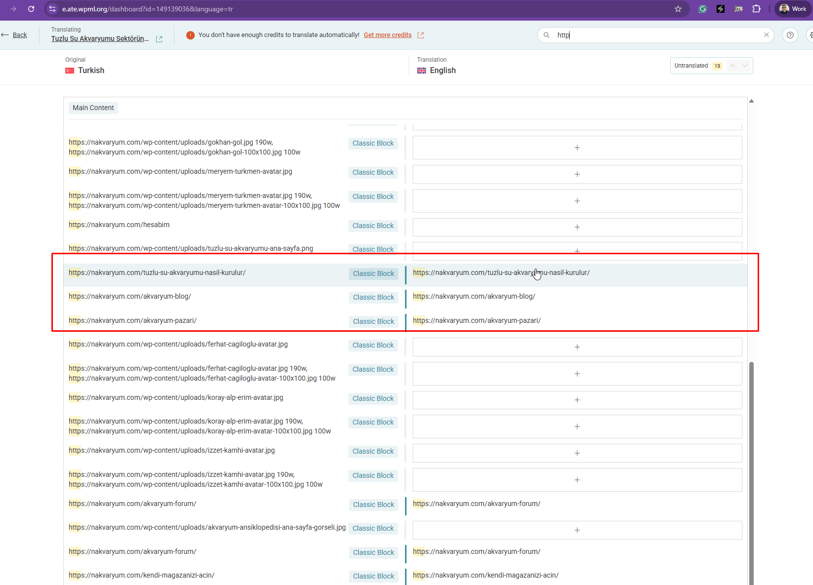

I tried several times but the result is the same. I still can't see some links for this page. Here is a record.
You said "I've enabled translation on your homepage" before and you said that this should be done for all pages that contain special links. What exactly is this process? Maybe it's related to this.

July 7, 2025 at 9:32 am #17207490
Thanks for your reply. I've checked and the links are all translated for me as shown in this screen recording. hidden link . Please take note of the links at the bottom when I hover over the buttons.
