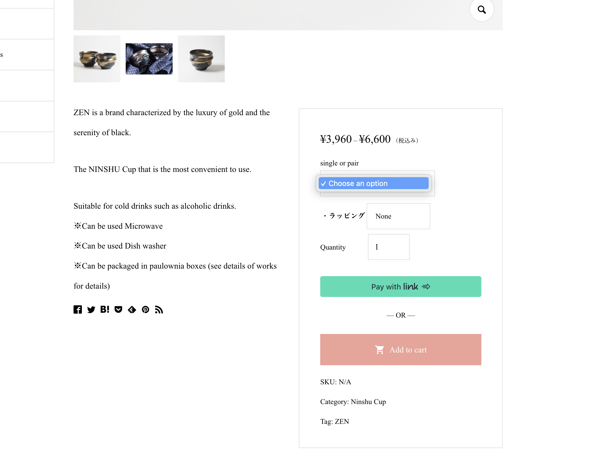

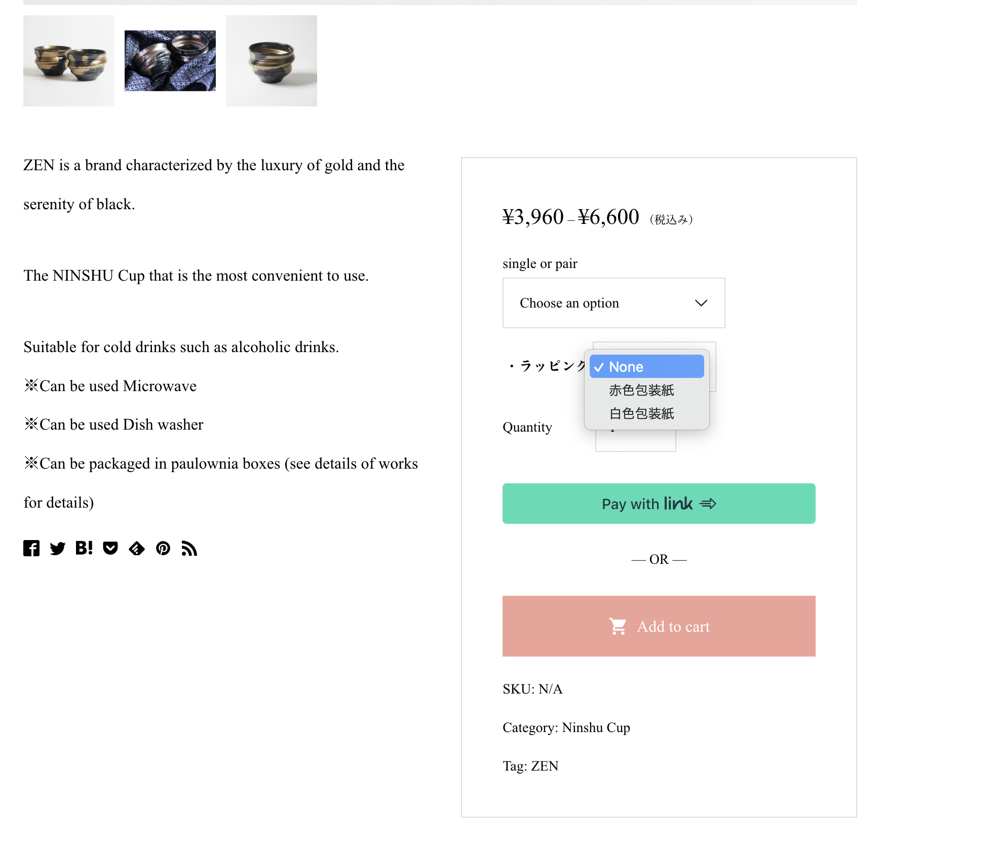

When switching from Japanese to English, product variations (already translated into English) do not appear in the drop-down menu.
https://wpml.org/documentation/related-projects/woocommerce-multilingual/#variations
I am using the "Product Add-ons" extension and have done the English translation (in strings) as well, but the label "Wrapping" and the drop down menu are in untranslated Japanese.

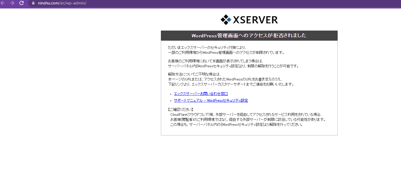

Sorry, I can't seem to access your Website as I'm being blocked as shown in the attached screenshot. Are you able to temporarily disable the restriction so that I could login to check.

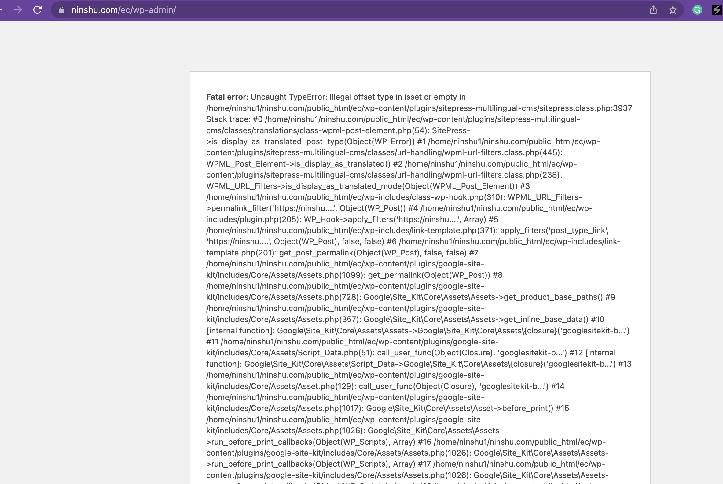

I can't seem to access the backend and I'm getting the error shown in the attached screenshot. Could you check?
Also, are you able to provide FTP access to your server files?

The issue is caused by the Site Kit Google Plugin, as detailed in this link: https://wpml.org/errata/site-kit-by-google-uncaught-typeerror-illegal-offset-type-in-isset-or-empty-in/. I have resolved it by deactivating the plugin via FTP, and now I can log in successfully.

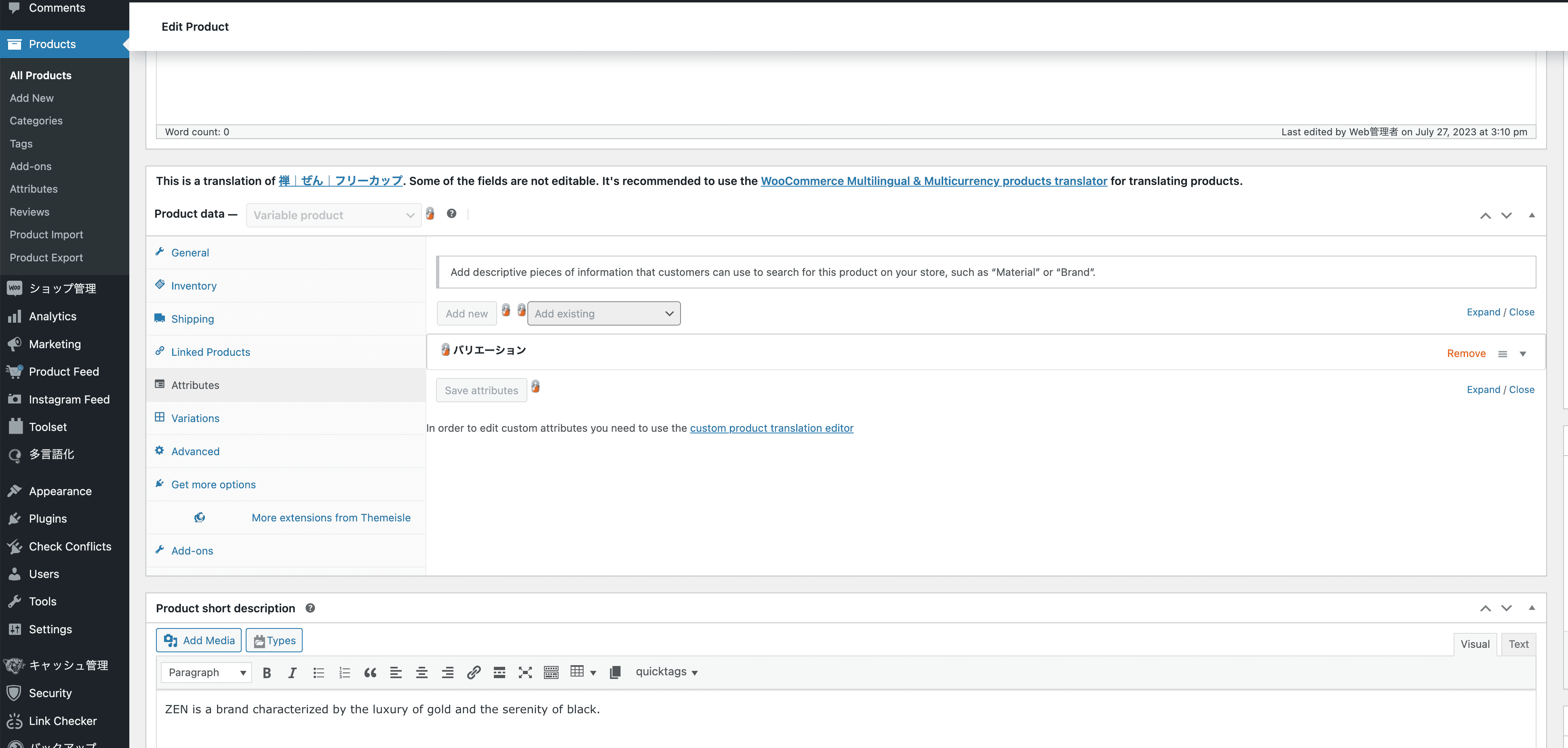

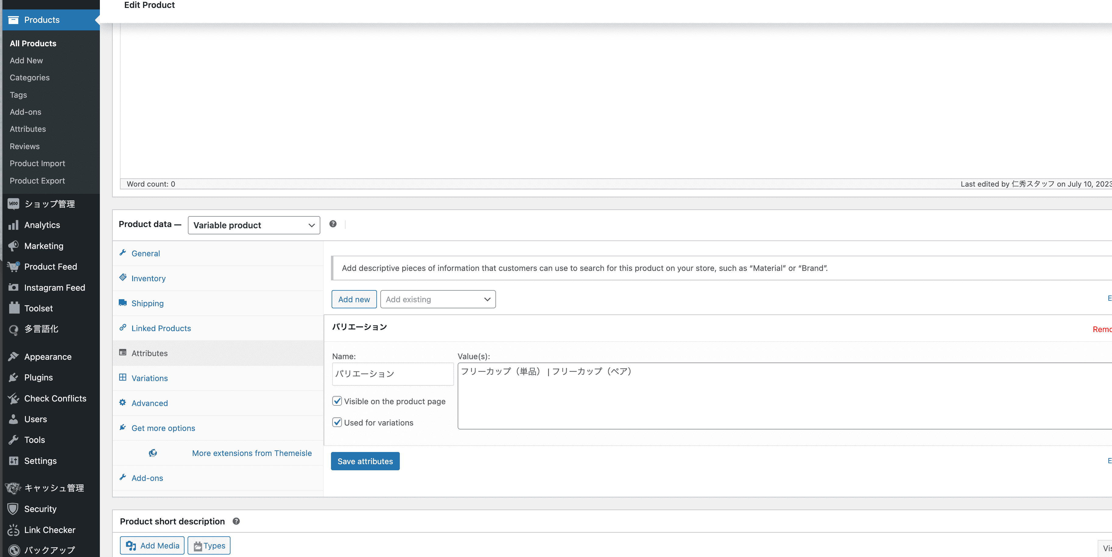

I followed the Woocommerce manual and configured the settings directly on the products with custom attributes (not global attributes).
Managing Product Categories, Tags and Attributes
https://woocommerce.com/document/managing-product-taxonomies/

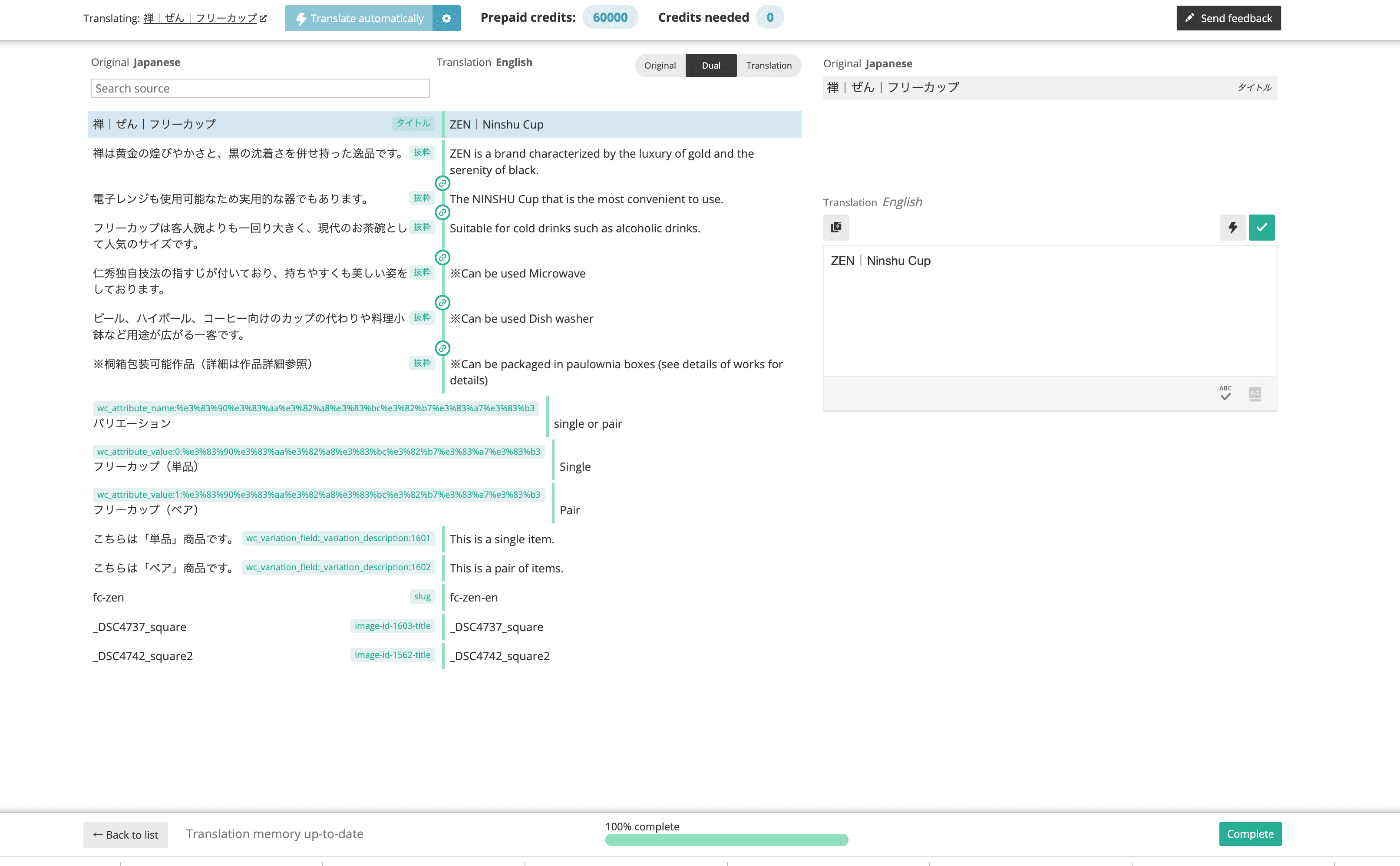

I also followed the on-screen instructions for configuration and translation in this case. Please see the attached screenshot.
Is this method of configuration not sufficient?

I appreciate your understanding. I've received feedback from our 2nd Tier Support, and I've retested the attribute translation. This time, I'm pleased to inform you that it was successful. You can see the positive outcome demonstrated here: hidden link.
I made a modification to the "Attributes" during the translation process to another language, using values like "test1, test2, test3," and it produced the desired outcome. As you're planning to launch tomorrow, I'm wondering if there's a staging site available where we could conduct additional testing on your side? This would help ensure everything is running smoothly and not interrupt your event.
