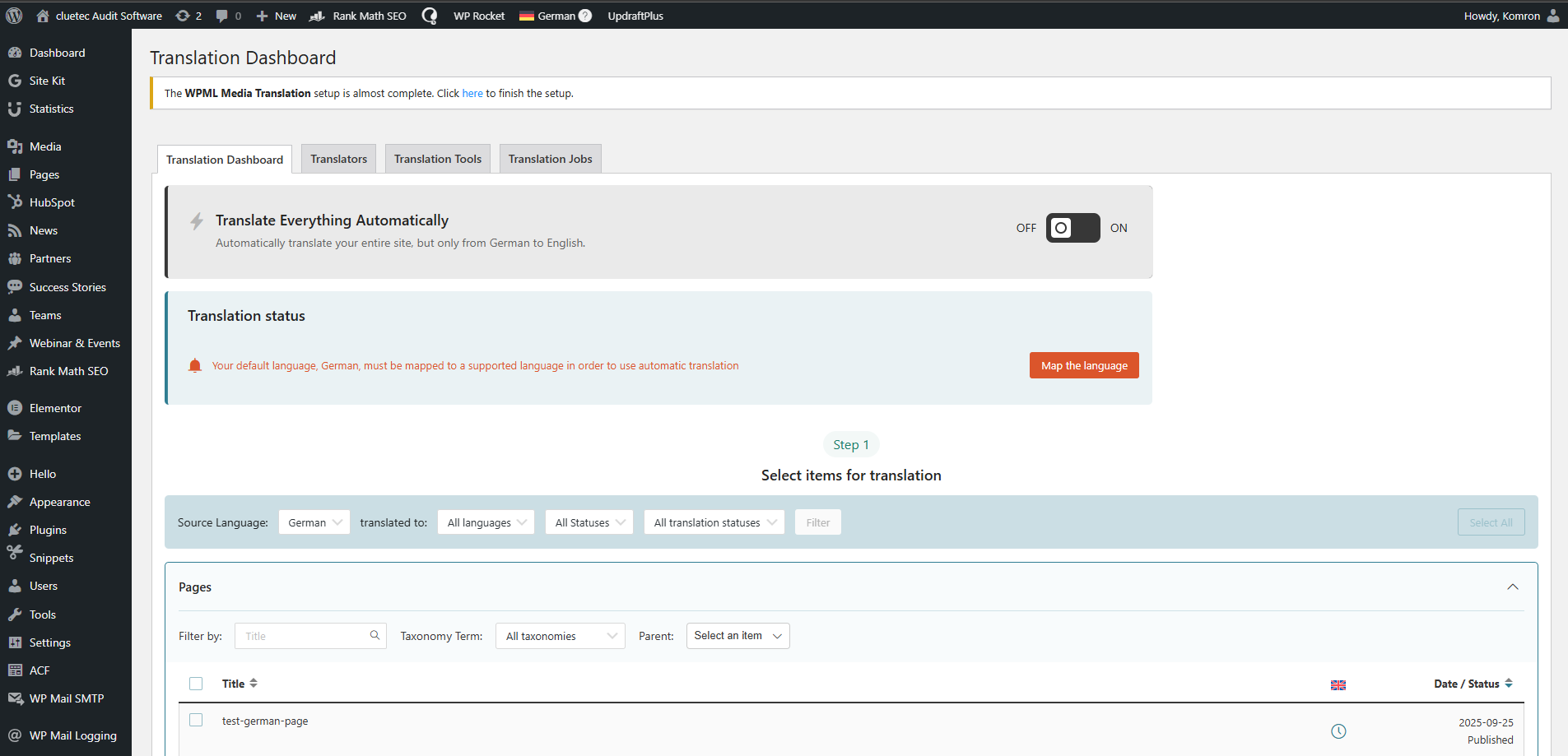

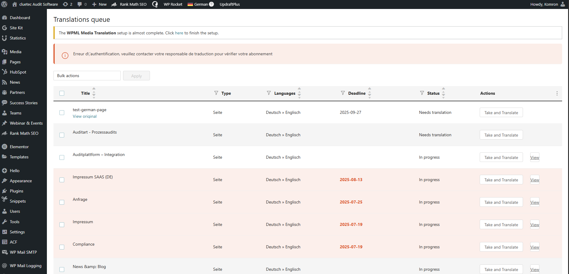

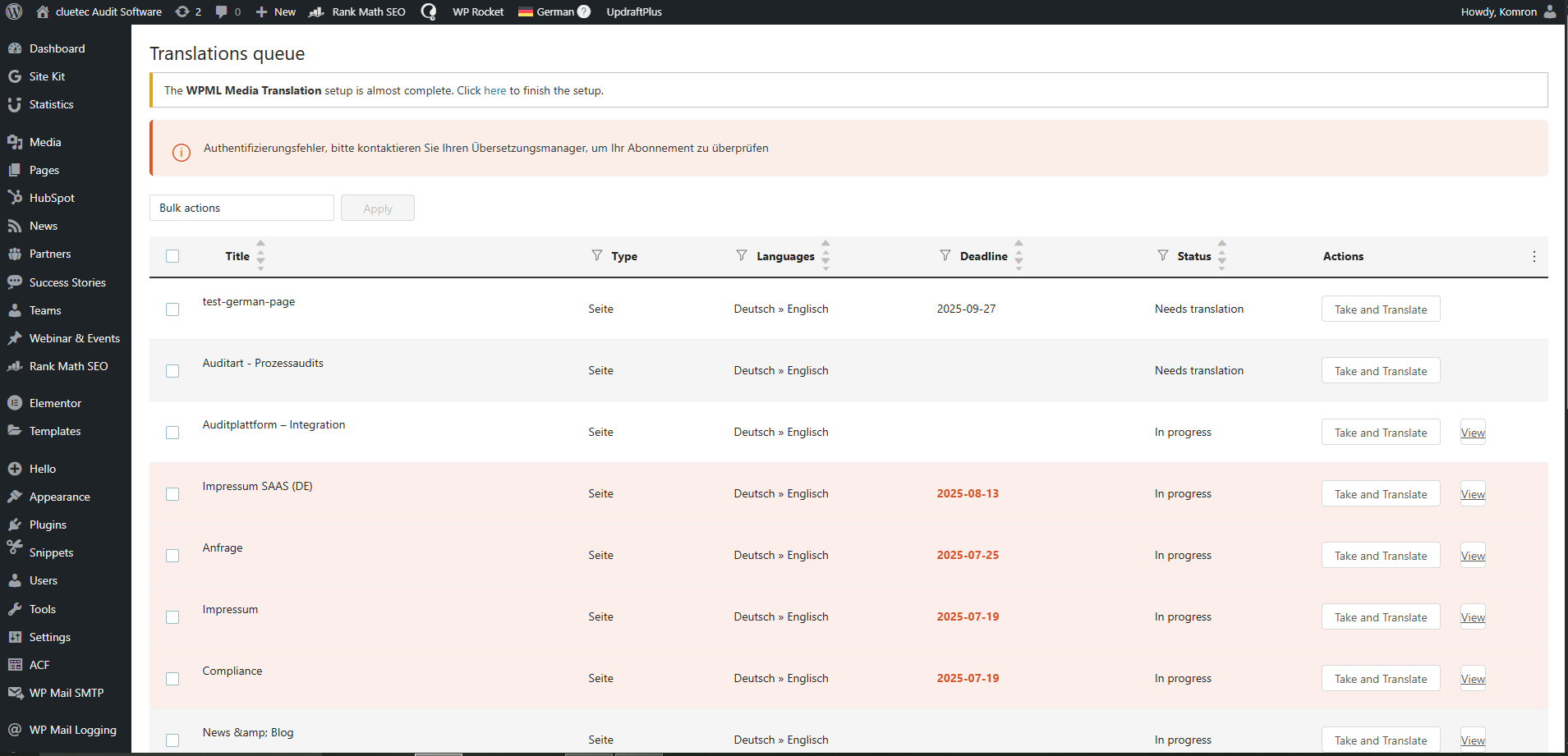

I am trying to use the Advanced Translation Editor (ATE) to translate content on my site, but the editor fails to authenticate my site, blocking all translation work. I have resolved initial database issues, verified server connections, and re-registered the site with a new key. Despite these efforts, the authentication error persists. I need a technician to check my site's registration/translation ID status directly on your server. Here is the link to a page where the issue can be seen: hidden link.
The error occurs internally when attempting to start a translation job from the Translation Management dashboard. The error message appears in an admin notice when trying to send a job to ATE: "Authentication error, please contact your translation manager to check your subscription". This error shows in different languages like Spanish, Italian, Arabic, Hebrew, etc. Additionally I have "Your default language, German, must be mapped to a supported language in order to use automatic translation" notice that never goes even though I have few times mapped it correctly.

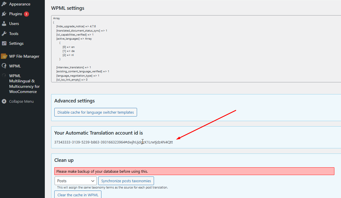

In the meantime, please go to WPML > Support > Troubleshooting, then share the Advanced Translation Editor ID as shown in the attached screenshot.
October 8, 2025 at 5:32 pm #17468473
Thanks for your reply. I can see the issue now, but I’m unable to find a fix at this point. I’ll need to escalate this to our 2nd Tier Support for further investigation.
