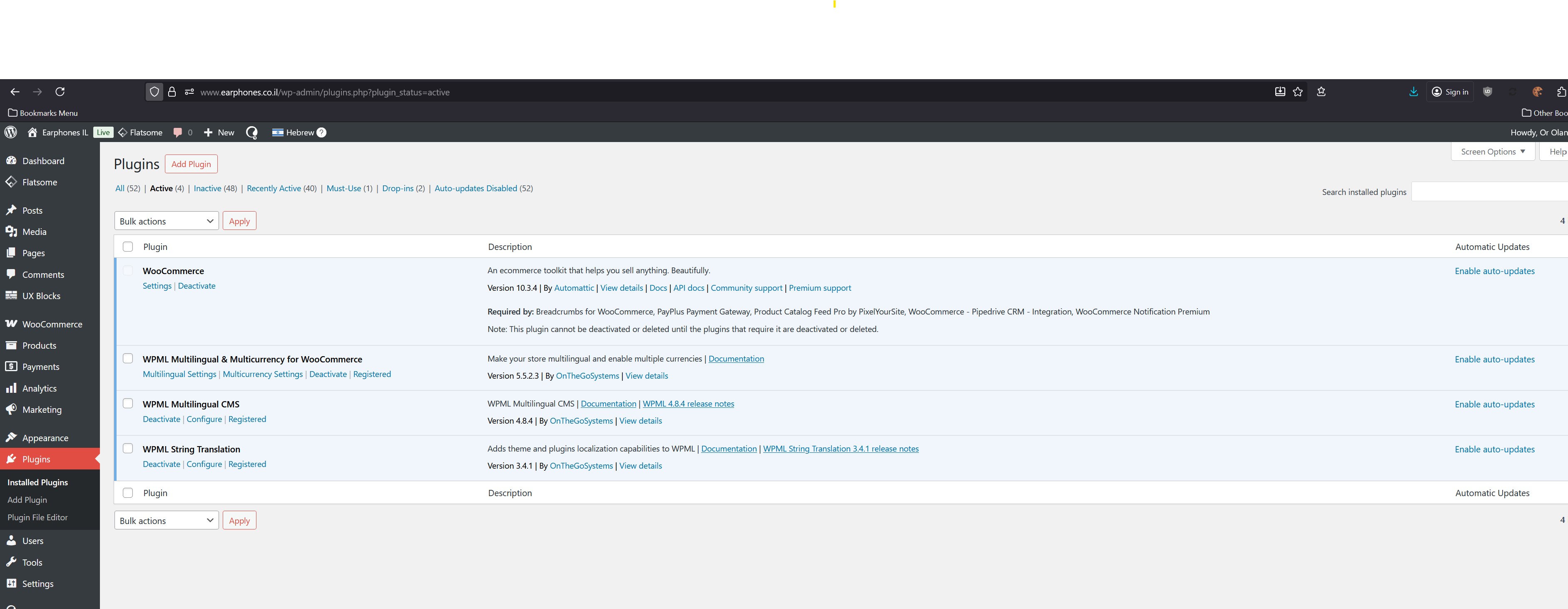

Look at the screenshot I attached, I went on the Live website and disabled all plugins other than those 4 that you see. same as you did on the test server. And still, it did NOT work, the issue remained the same, no English product created.
we are looking at the wrong place, it is not the plugins, it is 100% certain:
1. The test website still works with all the plugins ENABLED.
2. The live website does not work with all the plugins DISABLED.
The only conclusion is - it has nothing to do with the plugins.
Either you took an action on the test website that solved the issue (which is not disabling the plugins), or your key is good and my key or account is corrupted.
I can't see any other explanation.

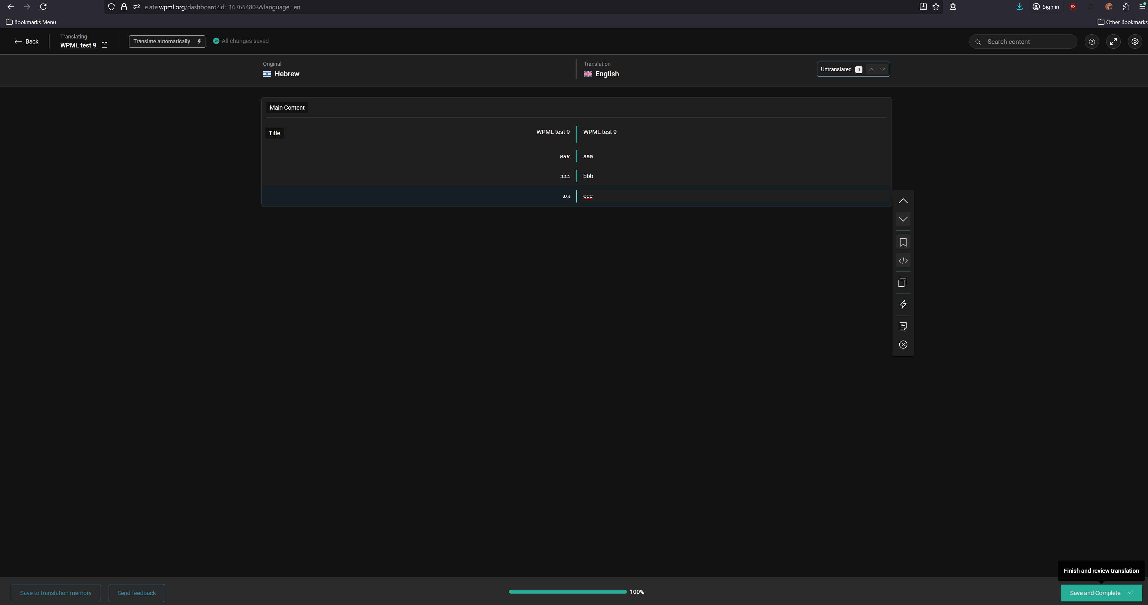

I have successfully translated several products on the test website with all the plugins activated, I tried it several times to makes sure. It was working. I would make a video for you, but it will be very large and I probably won't be able to upload it here.
I see that you left the test website as it (plugins working), great, I will create another new product and translate it on the test website now as proof it is working.
please follow the images I sent, it's step by step.
Here is the final result: hidden link
It was translate, it is working, and all plugins are enabled!
This is proof this has nothing to do with the plugins, I just created a new product and translated it on the test website with all the plugins enabled.
The test website is working smoothly, but the live website is broken (WPML is broken).
How can this issue be resolved? Is it my account? what is this? it's not the plugins.
