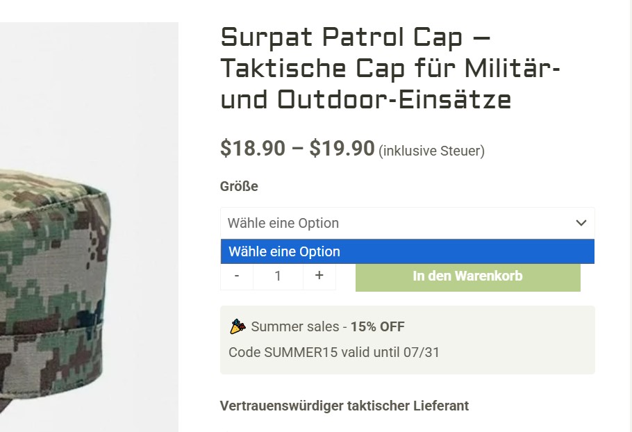

I am trying to synchronize attributes to translated product variations on my WordPress site. The issue can be seen on this page: hidden link.
I expected to see some variations on the product, but instead, I got not a single variation.
Why are the product variations not appearing on the translated product page?
How can I ensure that attributes are synchronized correctly to translated product variations?

August 15, 2025 at 10:34 am #17323217
bikbulatovaE
Good example of what Im saying.
All colors stay intact. Sizes are the problem

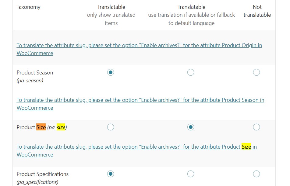

August 19, 2025 at 7:50 am #17329962
bikbulatovaE
not sure about staging, what hapenned.
Here is new password: [Removed]
On screenshot, the settings for product size attribute.
Can you have a check ?

August 19, 2025 at 12:38 pm #17331330
Otto
Thanks.
I suggest avoiding the fallback option and stick with Translatable - only show translated items.
**Why not the fallback option?**
- It mixes terms across languages, breaking variation matching and hiding variations.
- Updates/autosaves can re-sync and reintroduce mismatches.
**As I mentioned before, try this:**
- Make the attribute global (e.g., `pa_size`) and translate all its terms.
- Switch to “only show translated items”.
- Sync attributes and update product variations in WooCommerce > WooCommerce Multilingual & Multicurrency -> Settings (tab) -> Troubleshooting (bottom right of the page)

August 19, 2025 at 7:33 pm #17332681
bikbulatovaE
It worked.
WooCommerce → WooCommerce Multilingual & Multicurrency → Attributes, select Size, and run Synchronize attributes and update product variations.
That function fixed the problem.
Big win here, because I lost multiple sales because of this issue.
I hope the issue will not appear anymore. But since situation of "size" attribute has been regulated, it should not.
