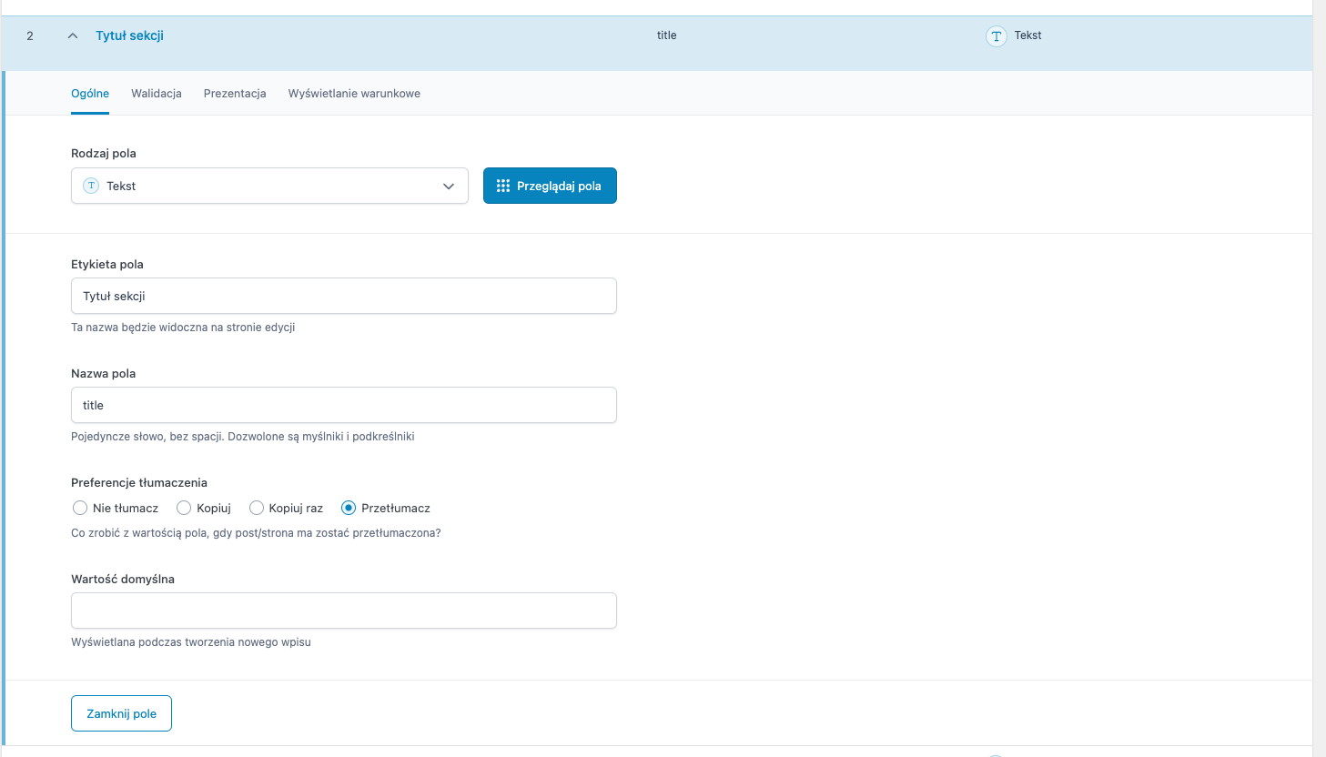

I am experiencing an issue with the ACF Gutenberg block when using the auto-translate feature. I have a text field within a block that is repeated multiple times on the same page. Despite setting the text field to 'translate', one instance of the block is not being translated correctly.
All instances of the ACF block are translated except for one, even though they contain different content but are the same block type.
Why is one instance of the ACF block not translating when all others are?
Is there a specific setting or error that might be causing this issue with the auto-translate feature?

The reason seems to be the field name.
If more than one field in ACF uses the same field name "title" then the field will not longer be translatable.
Make sure that each field within and between all field groups has unique field names and then test again.

I understand, but we are talking about one block used several times. I am unable to register a group of fields with different field names "title".
The problem that occurs is that out of 5 occurrences of the same block, only one does not translate (checked in two languages).

You can not use the same field name in different groups.
For example:
Various groups have the field name "title".
If there is more than one field in your ACF Groups with the same field name, then not all fields will show up for translation.
From our docs:
Make sure each of the custom fields across your different field groups has a unique Field Name. If you use the same Field Name with more than one custom field, you may not see all your field values available for translation in the Advanced Translation Editor.

You will need to go through all your groups for such a test.
The field name "title" can only exist once between all your groups.
I suggest you give each field on each group a prefix using the group's name as a value.
Like:
groupname_fieldname
June 7, 2024 at 9:51 am #15714532
