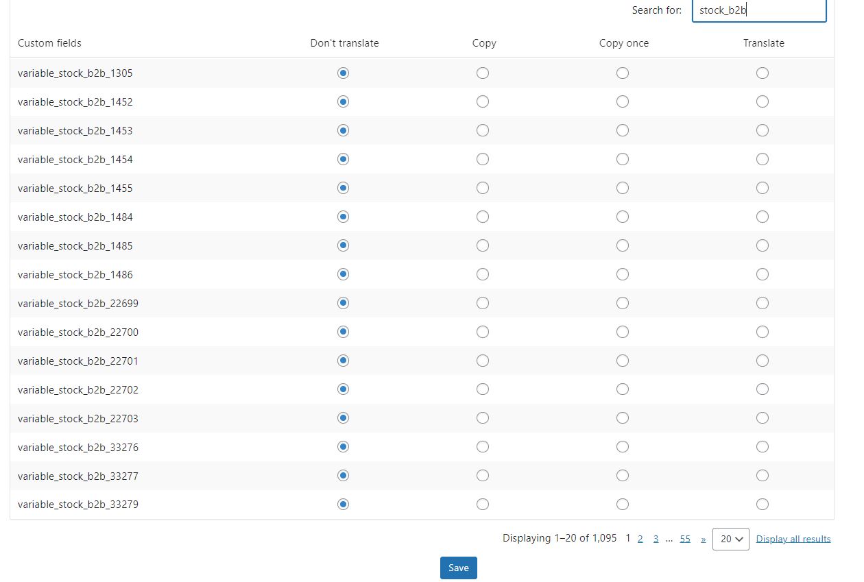

I'm afraid this is not an option. B2b king saves the stock value in variables, so i have the same amount of variables as my products (sreenshot).
Can i mass select copy all those variables?

I can confirm that i found the custom field that i needed to, and after copying it, the new translated products are copying the stock. But this is true only for the new added products.
So the question still remains. Is any way to apply this setting to the old translated products?

I've performed some further testing and research, but couldn't find any built-in function or hook to trigger the update of those custom fields for the already added products.
You can open the edit screen of any one of the existing products and then click the 'update' button.
( you don't have to make any change to the product )
If the stock option is successfully synced with the translated product, you can repeat that for all of the existing products too.
