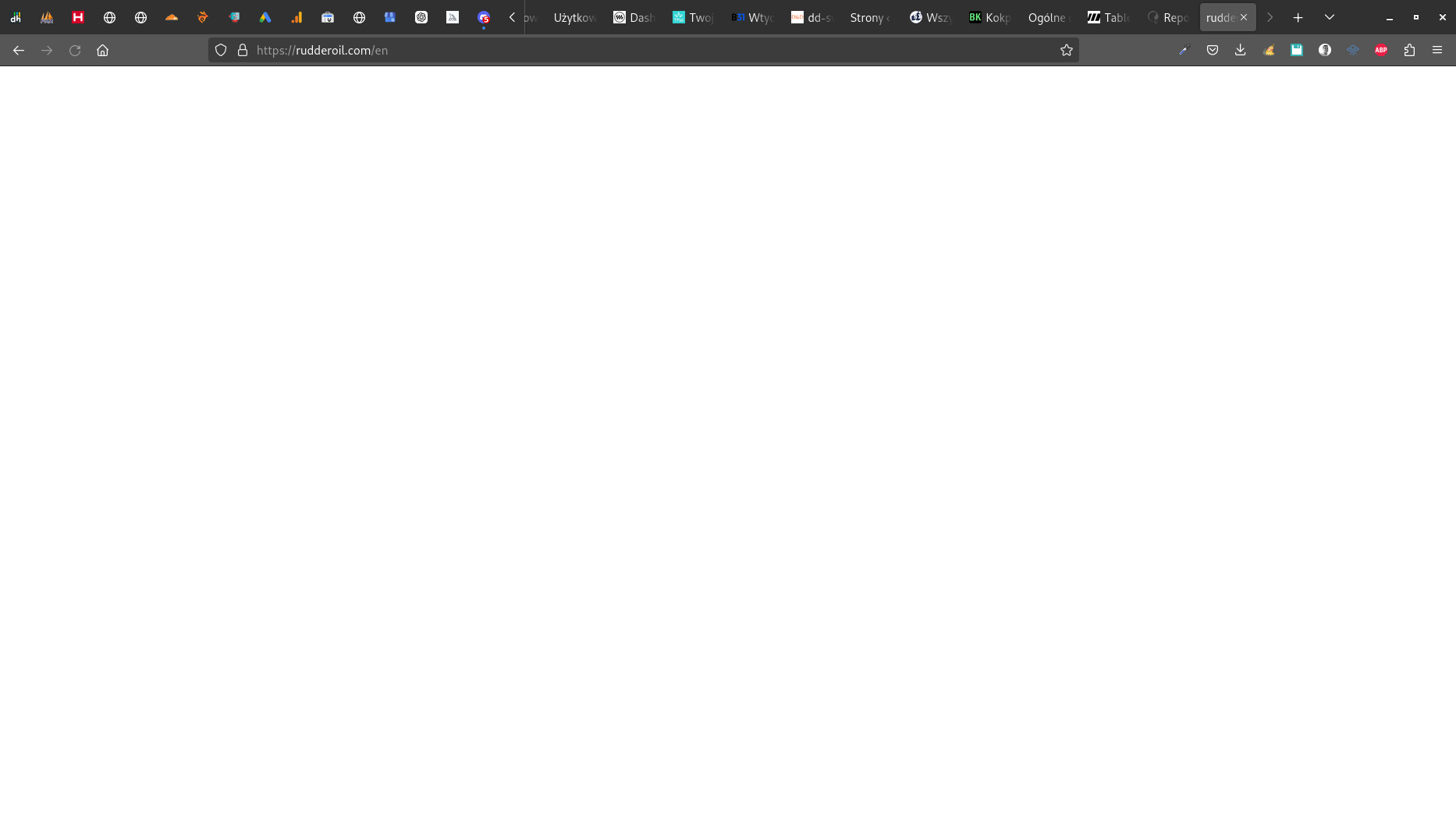

I am experiencing a black screen on the language version of my site hidden link. I have disabled all plugins before checking.
black screen
Why is there a black screen on the language version of my site?
How can I resolve the black screen issue on the language version?

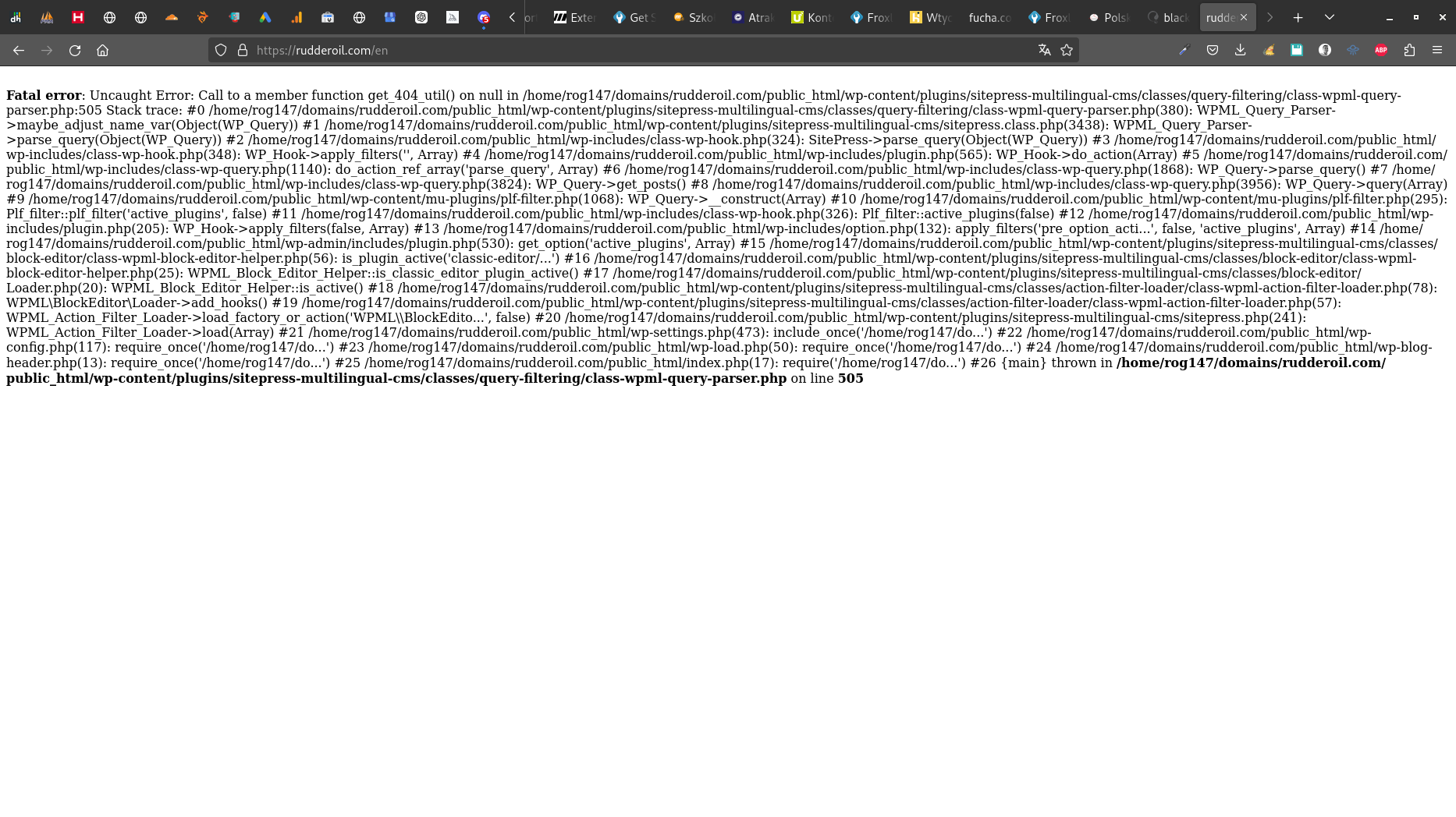

July 2, 2024 at 9:07 pm #15878206
irebu
the screen with the error
July 2, 2024 at 9:10 pm #15878221
Mateus Getulio
Hi.
Thank you for sharing that error log.
