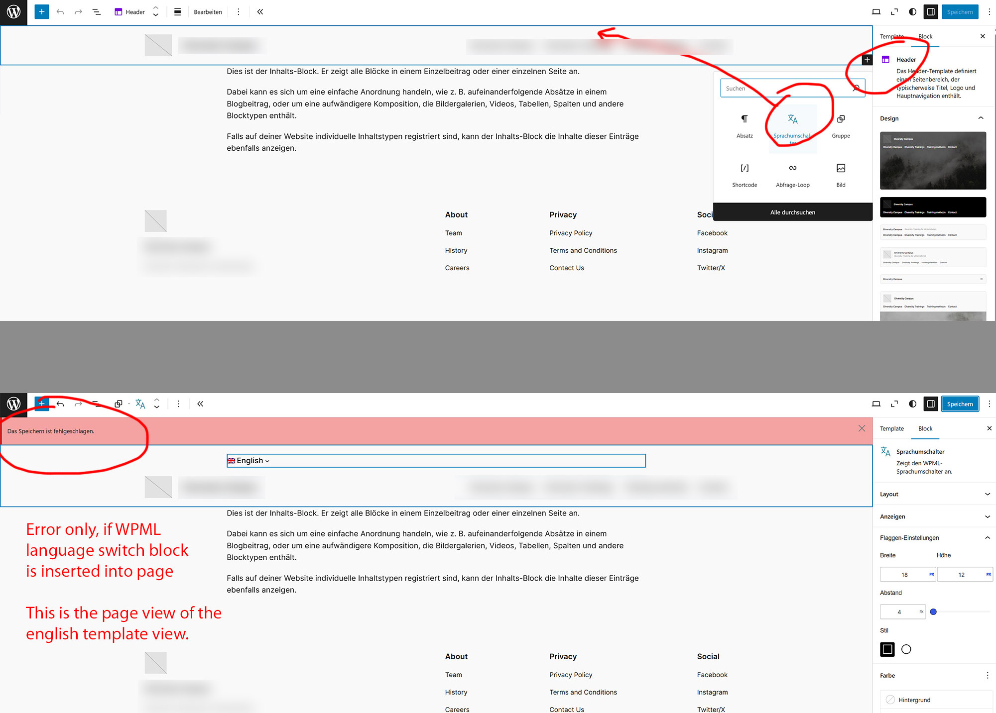

Ich versuche, einen Sprachumschalter-Block in einer Blockvorlage auf Englisch einzufügen. Die Hauptsprache ist Deutsch. Ich verwende die Vorlage: twentytwentyfour.
Wenn ich den Sprachumschalter-Block einfüge und auf die Schaltfläche Speichern/Aktualisieren klicke, erhalte ich die Fehlermeldung 'Speichern fehlgeschlagen.'
Warum erhalte ich die Fehlermeldung 'Speichern fehlgeschlagen', wenn ich den Sprachumschalter-Block einfüge?
Gibt es bekannte Probleme mit dem WPML-Plugin und dem twentytwentyfour-Theme?

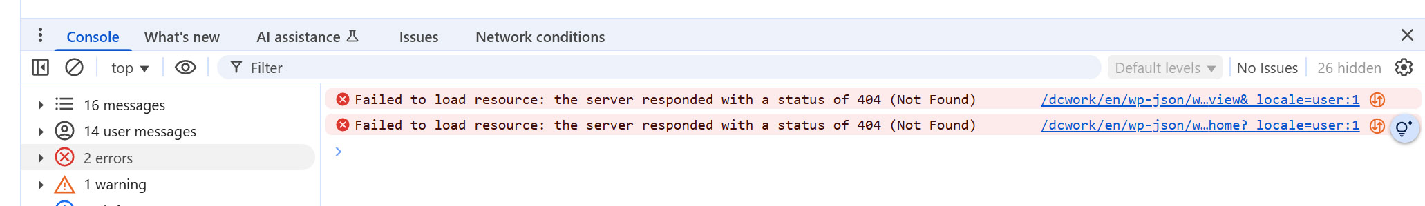

I noticed also, that this problem is not related to the language switch, if I change something on the english template page, i get a "Invalid JSON response" error.
In the browser error console i get the message "{"code":"rest_post_invalid_id","message":"Invalid post ID.","data":{"status":404}}".
So, there is something wrong with the WPML settings and WordPress block themes.

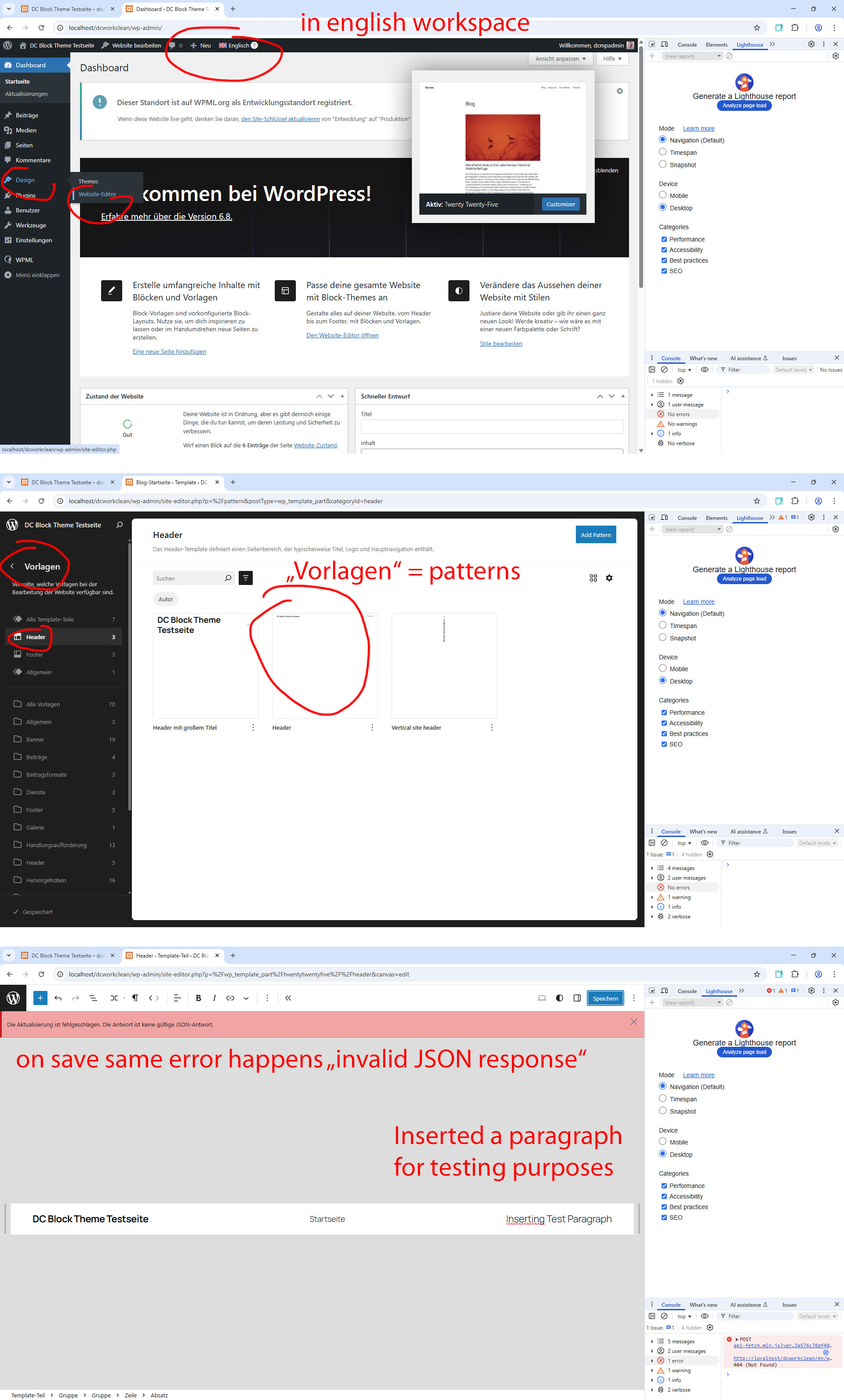

I tested this problem also in a clean, empty WordPress installation, only WPML activated.
The same happens, if i try to save the edited EN template:
JavaScript/Rest API error "hidden link"
I think now about this: this REST API URL is using "/en/" because i try to edit the english template. Maybe "hidden link" is simply just not registered in WPML?
I translated the template-part "header" in the WPML menu "Translation Managment" (just copied the markup of DE into the translation window of EN). That doesn't help.
Is there a way to set up the REST API with WPML correctly?

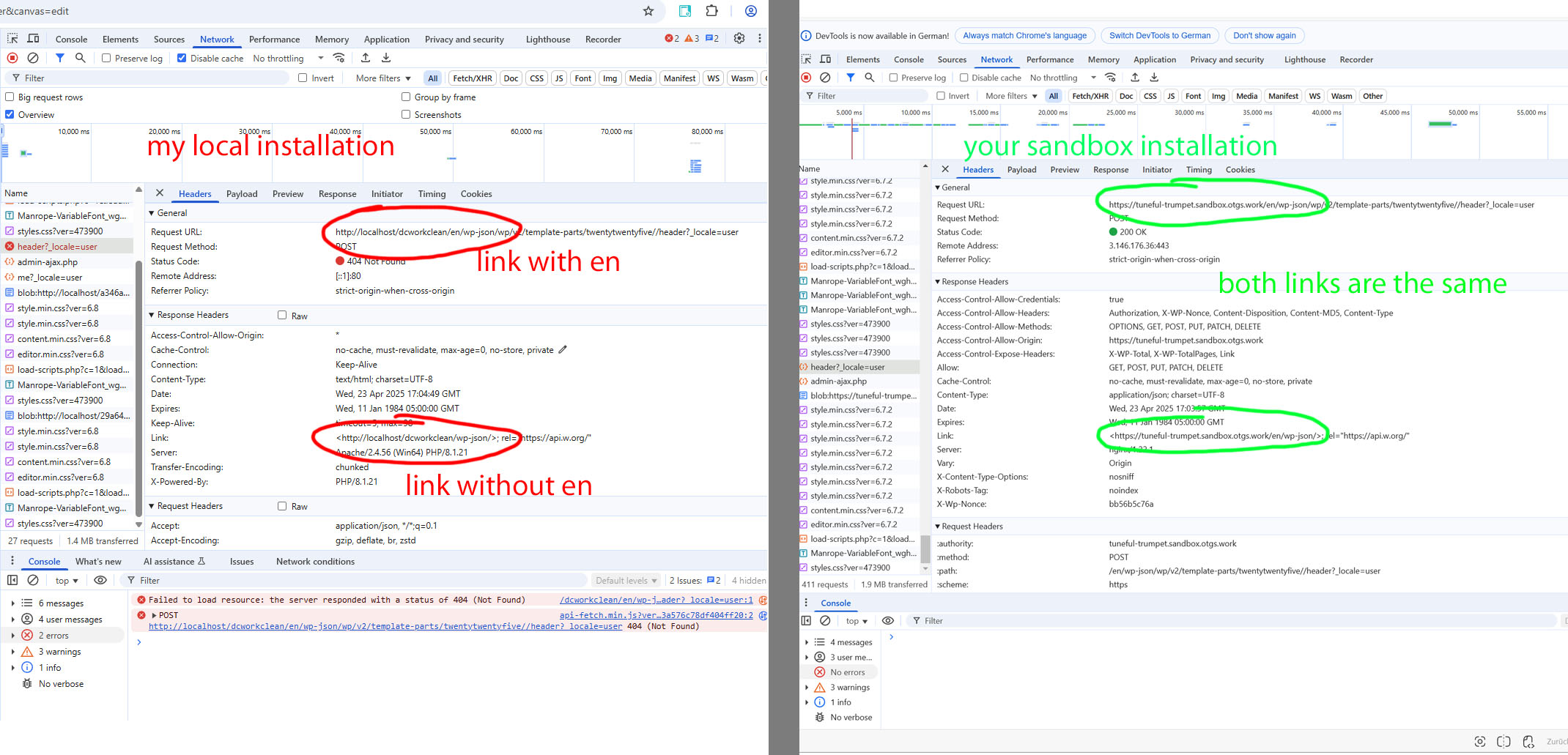

However, there is an issue in the Server-Request-Headers, please see my attached image below.
My response header "link" is the URL WITHOUT EN, but the URL with EN is requested, the sandbox request headers are fine, the request URL and the header link URL are the same.
I am running the installation locally with xampp, Apache and MySQL.
I don't know what to do now. Have you any idea why the request header link differs from the requested URL???
