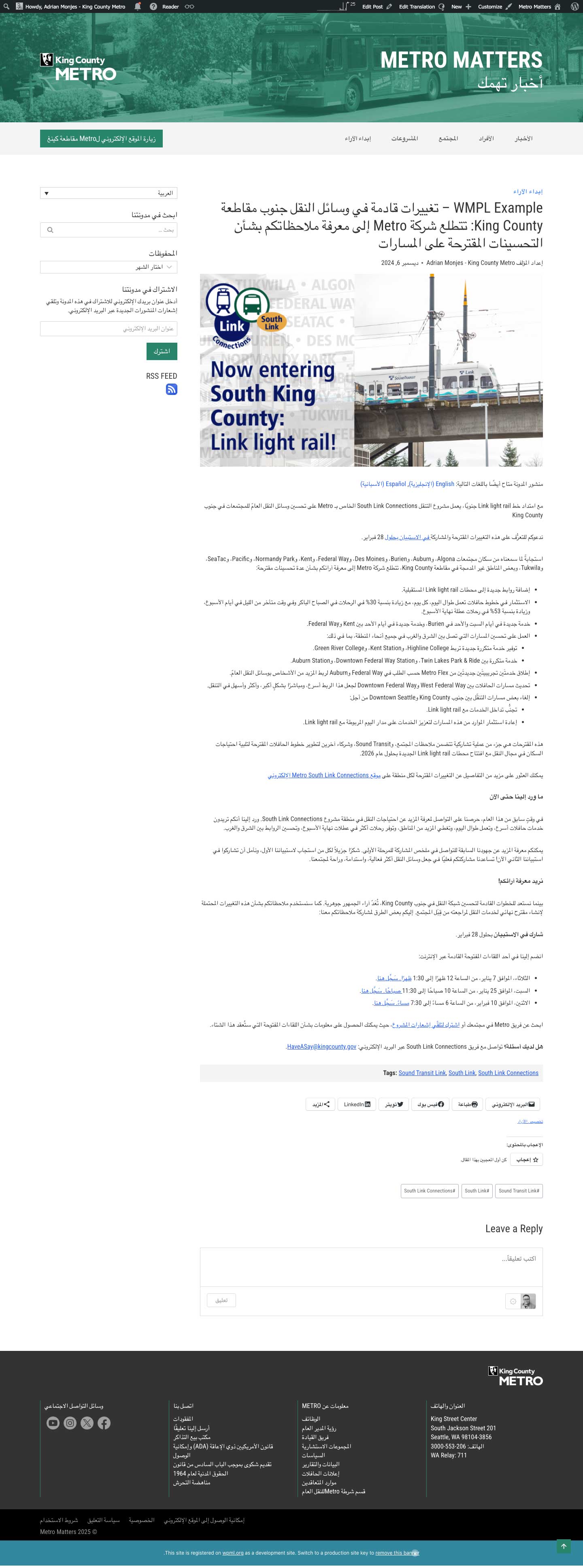

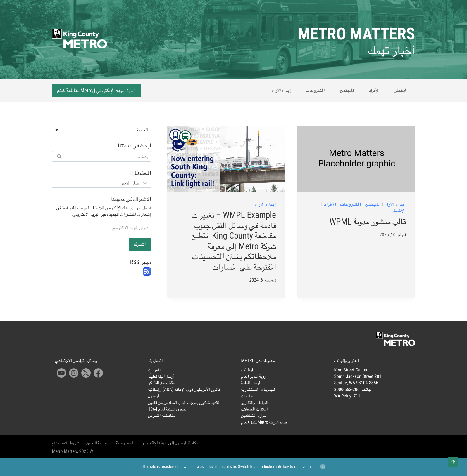

I still need help with this issue. Here are two screenshots of Arabic pages, representing the Archive Layout and Single Post Layout. The page should look like the archive layout with the header, footer, and right rail.

Single-Post-Layout-WMPL-Example-–-تغييرات-قادمة-في-وسائل-النقل-جنوب-مقاطعة-King-County-تتطلع-شركة-Metro-إلى-معرفة-ملاحظاتكم-بشأن-التحسينات-المقترحة-على-المسارات-–-.png

Below is a link to an Arabic blog post for your reference:
The blog post is now rendering perfectly on our end. Please see the attached screenshot for reference.
