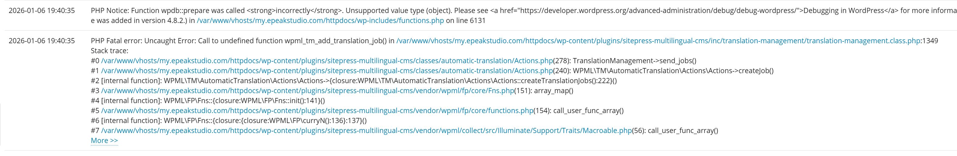

We initially thought this was an issue with Uncanny Automator, a plugin we use to trigger webhooks on form submits on our website. But after investigation from their end, they found in the logs some errors at the WPML level when their automation recipe triggers. Interrupting and triggers and causing issues on our side.
See attached screenshots from the logs.
Let me know if you need access to the site and php debug logs in order to check things. (I'll need an email as the site has TOTP login via email only).
When the WPML plugin is disabled, the automator recipe work, when the plugin is enabled it doesn't work and does this php fatal error.

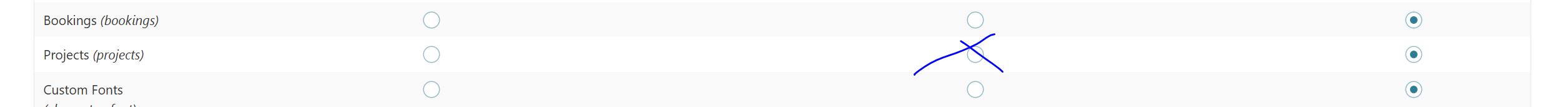

IF in the WPML settings I have automatic translation on the CPT item ON => Fatal error
IF in WPML auto-translate on that CPT is OFF => No fatal error, the Uncanny automator isn't interrupted, everything works

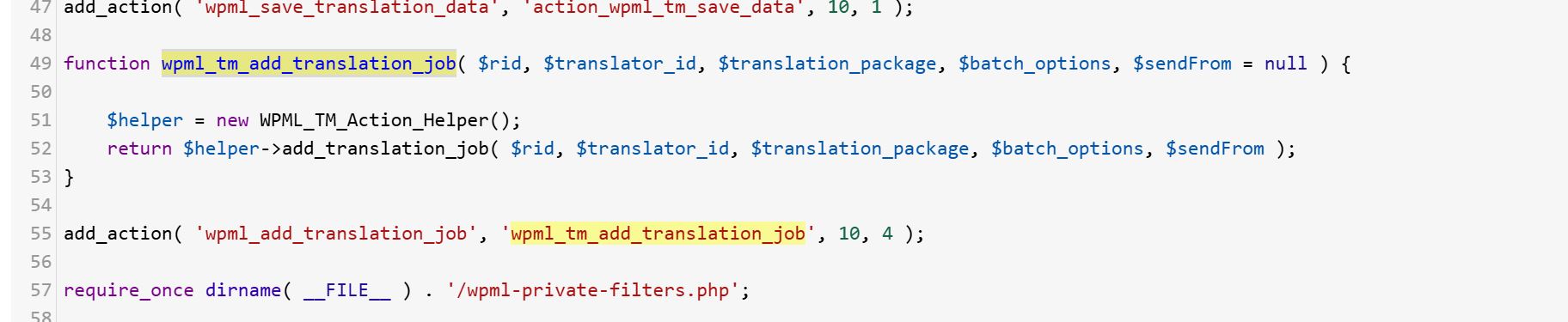

Can you please check in your site if the file wp-content/plugins/sitepress-multilingual-cms/inc/wpml-private-actions-tm.php exists and in line 49 it has the following:
function wpml_tm_add_translation_job( $rid, $translator_id, $translation_package, $batch_options, $sendFrom = null ) {
	$helper = new WPML_TM_Action_Helper();
	return $helper->add_translation_job( $rid, $translator_id, $translation_package, $batch_options, $sendFrom );
If not, please reinstall WPML and see if the issue is solved.

I checked the file, and the code is present (see screenshot)
1. If I disable Translate everything the issue is indeed gone, jsut like if I disable the translations for that CPT.
2. Turning off Automator, same fatal error (see screenshot)
