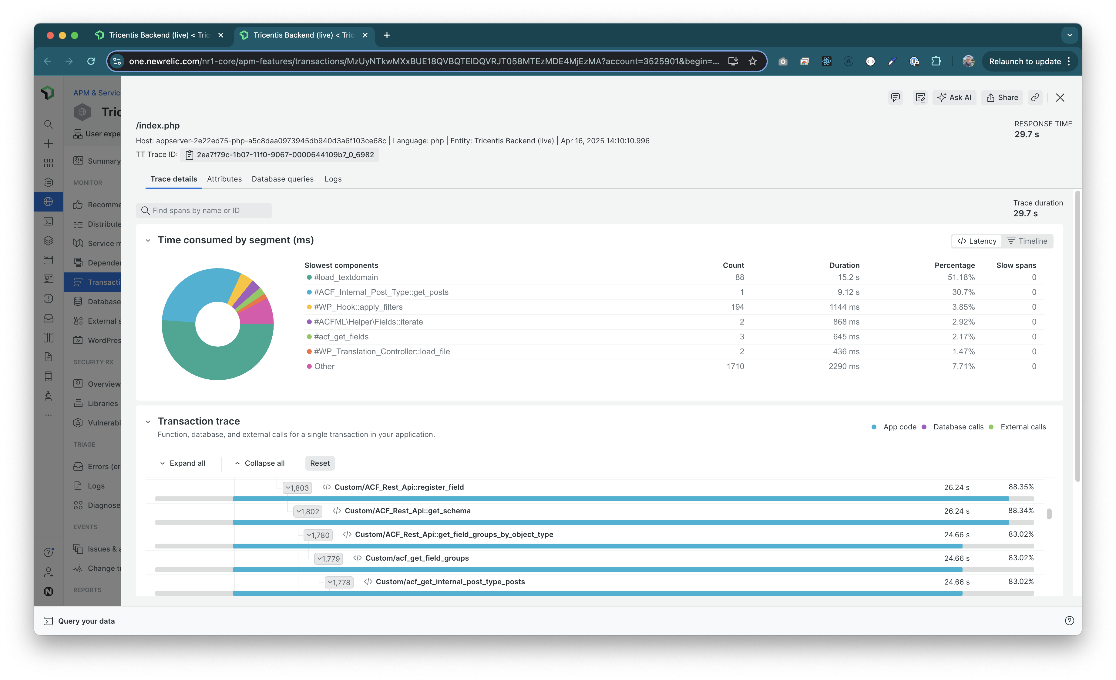

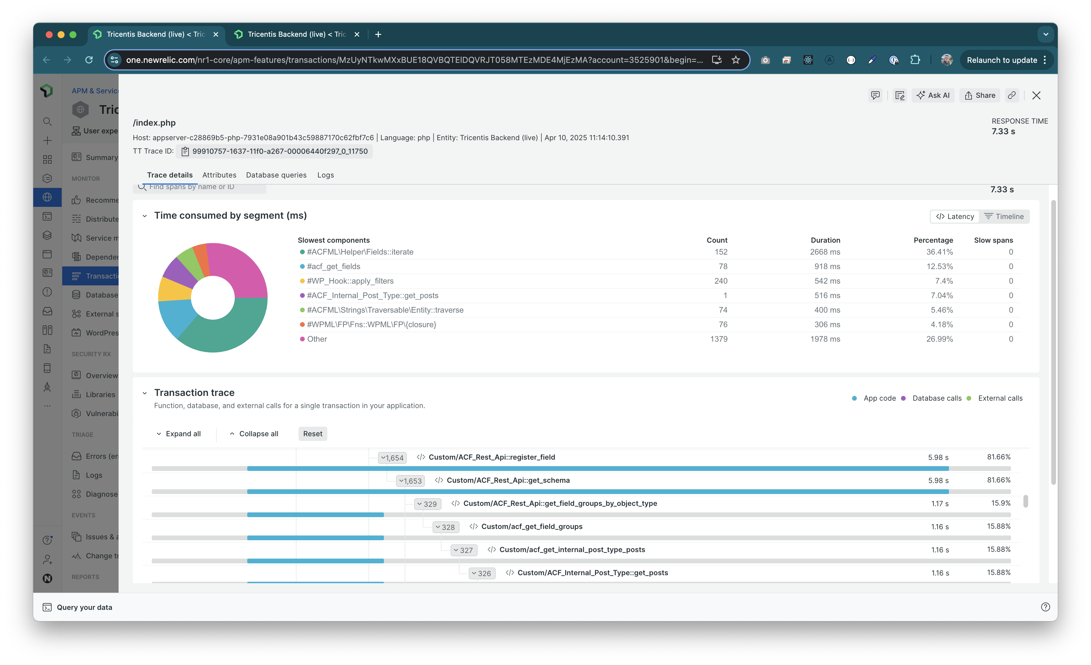

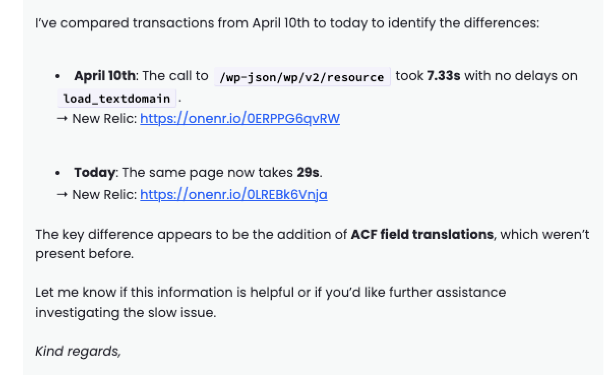

We’ve been encountering build challenges related to 504 Gateway Timeouts. After reviewing PHP slow logs, our hosting provider, Pantheon, has indicated that the issue appears to be at the application level, potentially causing performance degradation.
There were noticeable increases in response time with our build with queries that take upwards of 12 seconds when previously under 3 seconds. Pantheon’s investigation led to a noticeable increase of internal calls to get_field_groups_by_object_type from 329 to previous items of 1653. After investigating further into the situation with New Relic, we’re seeing large performance swings, and large differences in the performance monitoring (like the #load_textdomain and the acf_get_field_groups having way more things it’s iterating).

Increased query time, 504 timeouts, increased internal calls to get_field_groups_by_object_type from 329 to 1653.

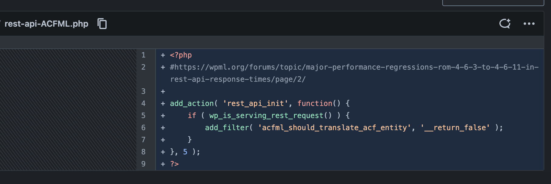

We’ve implemented a temporary workaround that appears to be effective. Could you please confirm whether this issue originates from the WPML code? (refer to screenshot attachment)

The slowdown was tied to how ACFML handles field group translations, particularly during REST API requests. After the update, internal calls to `get_field_groups_by_object_type` jumped which directly contributed to the 504 timeouts and long load times you were seeing.

So yes, you can continue using that filter as you did already:
add_action( 'rest_api_init', function() {
    if ( wp_is_serving_rest_request() ) {
        add_filter( 'acfml_should_translate_acf_entity', '__return_false' );
}, 5 );
It's recommended to add the snippet in a Must-Use plugin.
