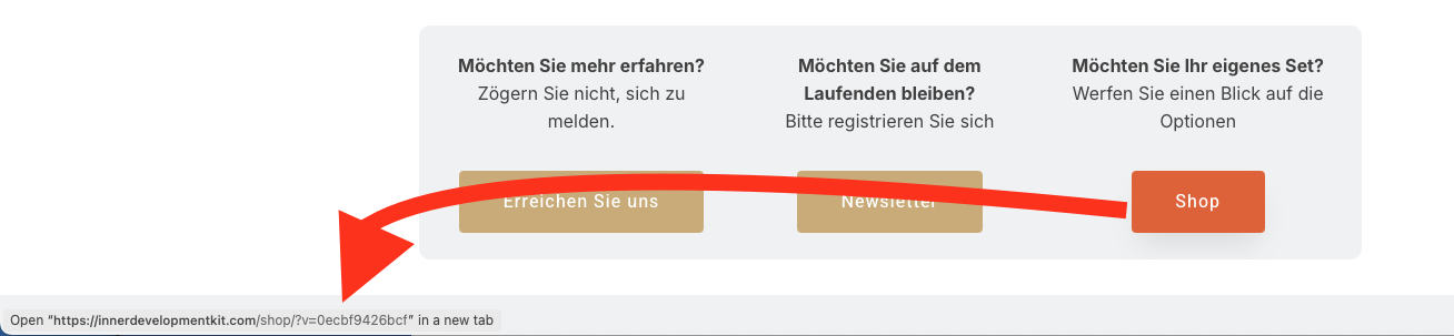

I am trying to ensure that button links to the webshop on my site hidden link direct users to the correct language-specific SHOP pages, such as /da/ or /fr/, instead of the original language.
As far as I can see, the link is not hardcoded.
Button links to the webshop are linking to the original language (english) and not to the language-specific pages like /da/ or /fr/.
Why are the button links to the webshop not directing to the language-specific pages?
How can I configure WPML to ensure the webshop links point to the correct language versions?

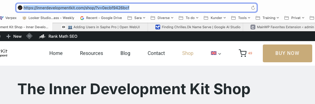

I have performed the scan before making any changes, but it didn't help. I changed the URL to /shop/ - and did another scan, but that also didn't help.
After both scans, 83 findings were reported. I am wondering if that is how it should be?
From the attached images, you can also see that the three buttons are the same type.
I am also wondering what the v parameter is caused by.
Is that from wpml?

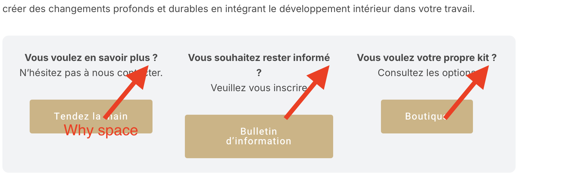

Please see the attached image. Before the ending ? the translater has inserted a space. Why does this happen and where do I change this. In the advanced editor or in the Gutenberg editor on the french page? What is the rule for using one editor and not the other?

2 question
Please see attached image. Why are spaces added in the french translation?
What is the best way to fix this. in the Gutenberg editor on the french page - or in the Advanced Editor - and what do I need to be aware of? I have tried to remove the spaces via the Advanced Editor - (Well, I see the spaces are gone now. ) Please comment.
