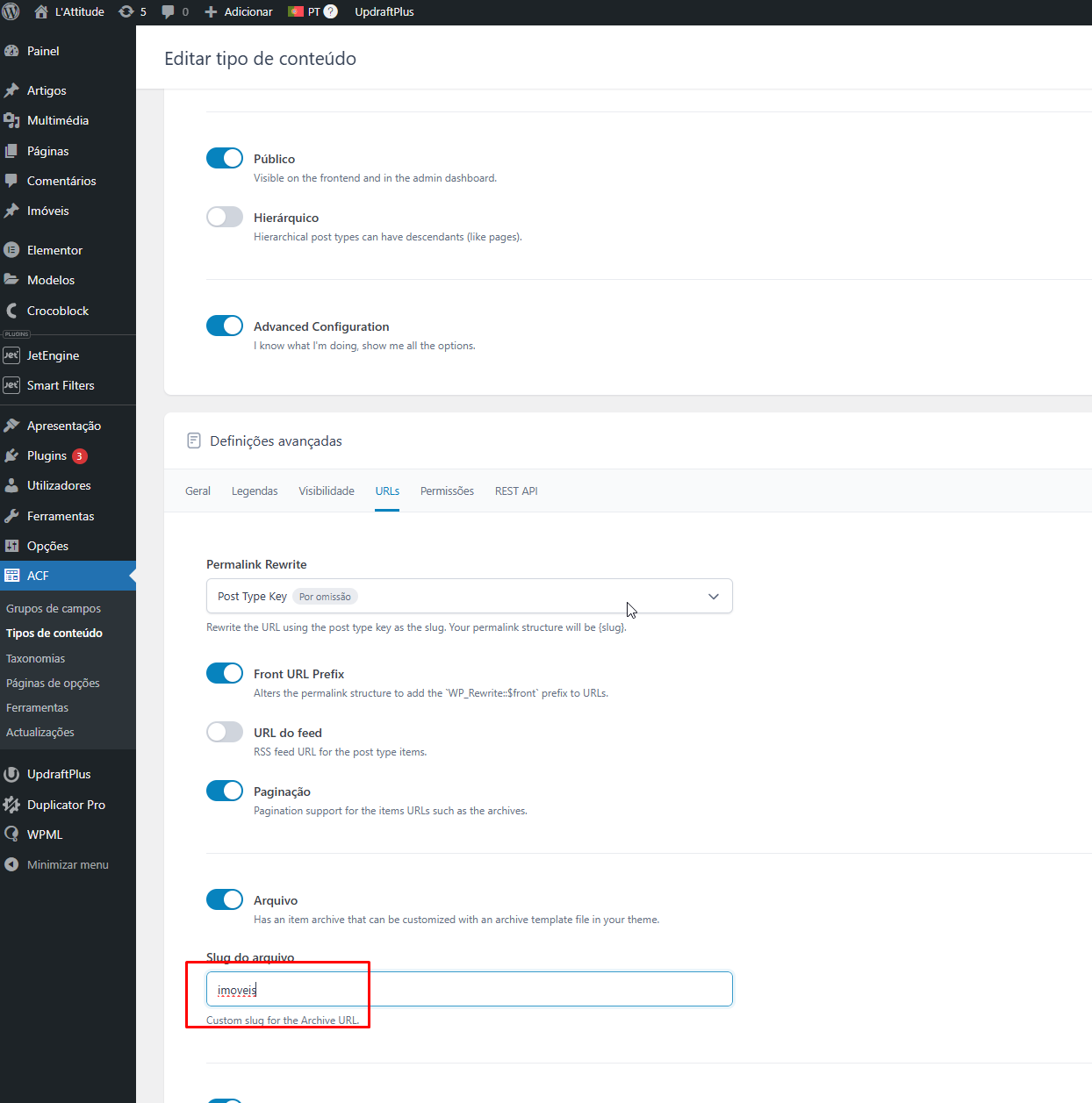

The client needed to change the URL from
https://lattitude.sitedev.pt/en/imoveis/
to
https://lattitude.sitedev.pt/en/properties/
, but faced an issue where the new URL redirected to
https://lattitude.sitedev.pt/en/?elementor_library=properties
We recommended removing the custom URL assigned in the ACF "Imóveis" custom URL option. This change allows the URL to use the slug configured in WPML. We asked the client to try this solution and inform us about the results.

Thanks for your patience. To fix this, you'll have to remove the custom URL you've assigned in the ACF "Imóveis" custom URL option as shown in the attached screenshot. Once you've done that, it will use the slug that you've configured in WPML.
Could you give this a try and let me know how it goes?

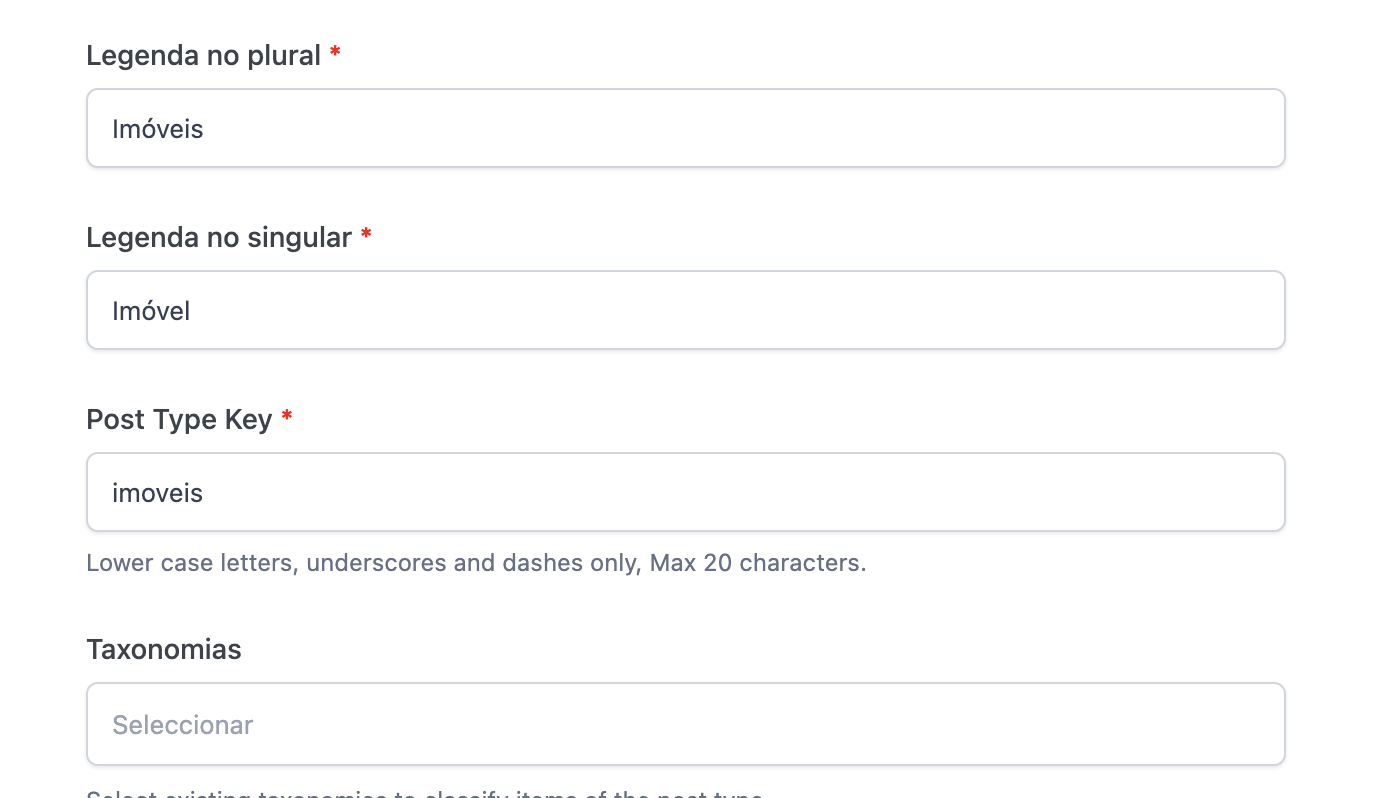

The translation is working. Now I need to change the Post Type Key from "imovel" to "imoveis". When I make this change I do not have the different properties registered. All records disappear. Can you tell me how I can make this change and keep the records.
