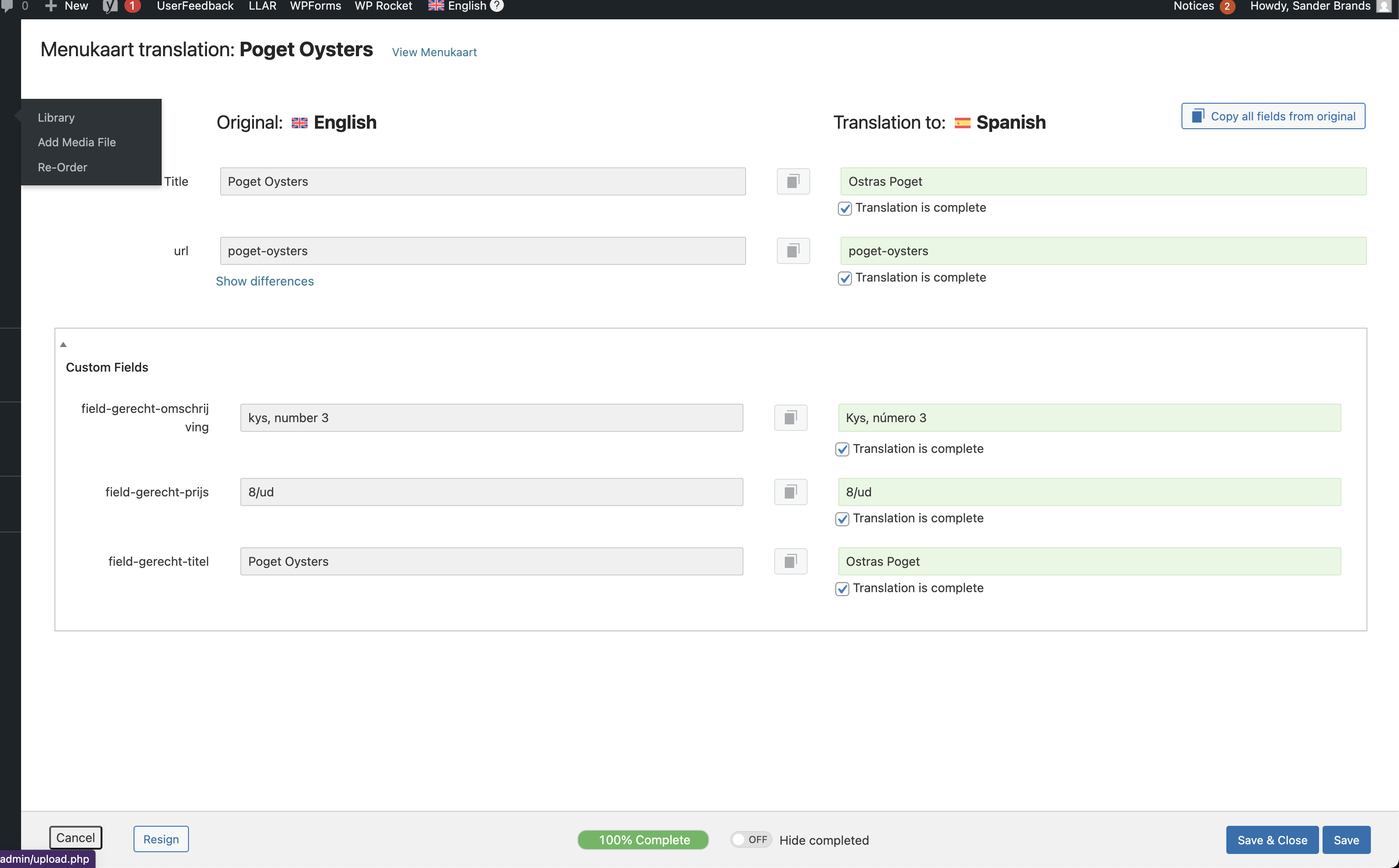

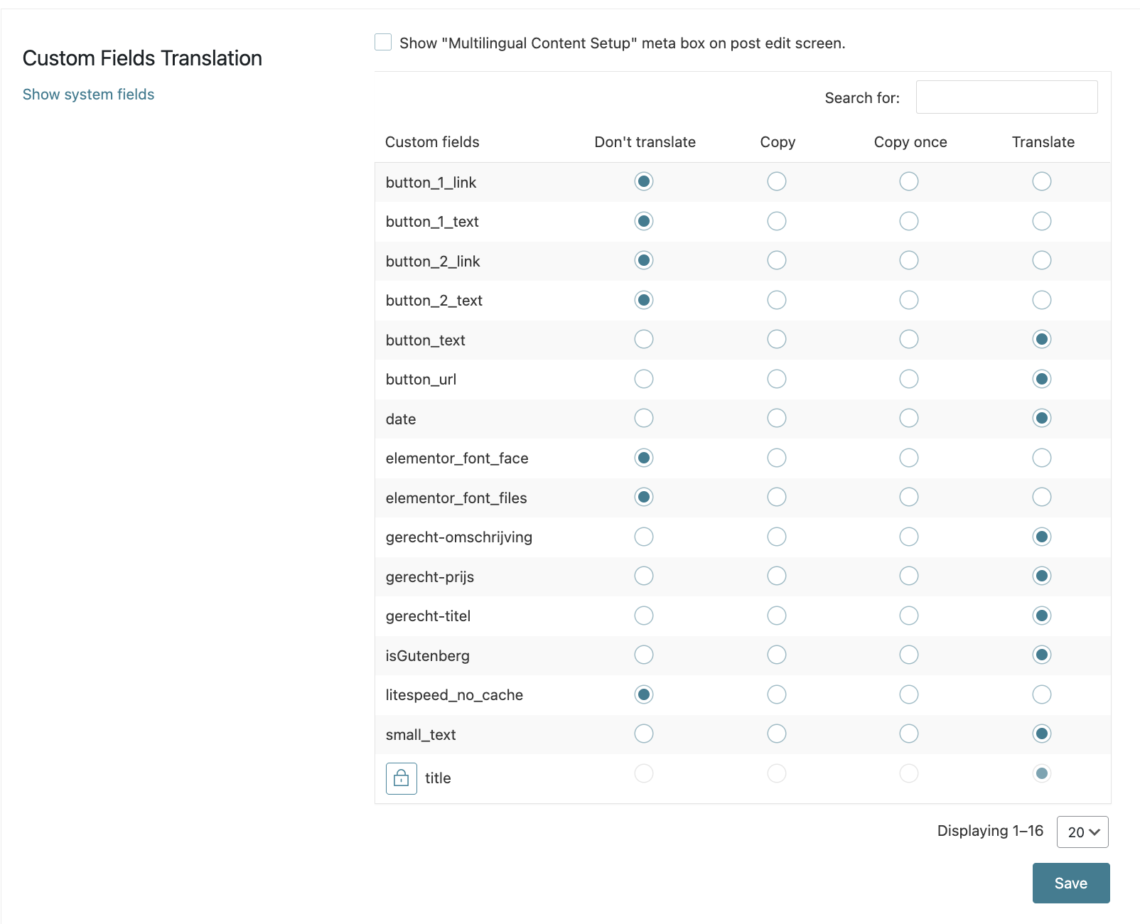

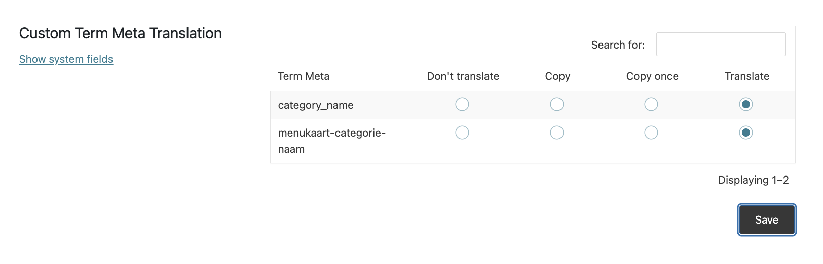

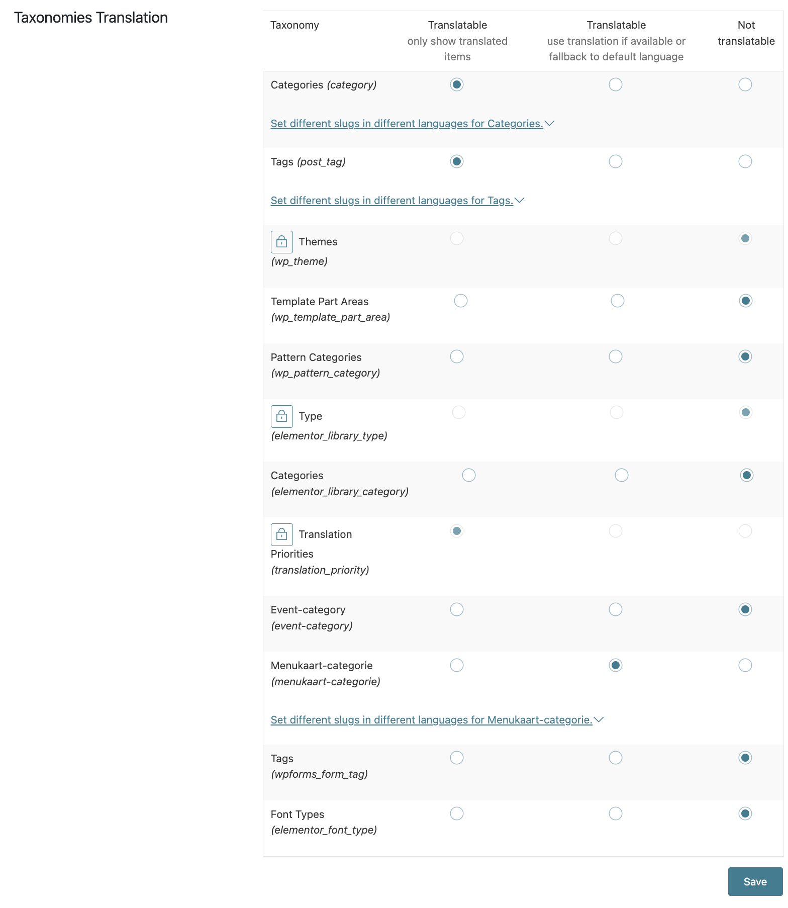

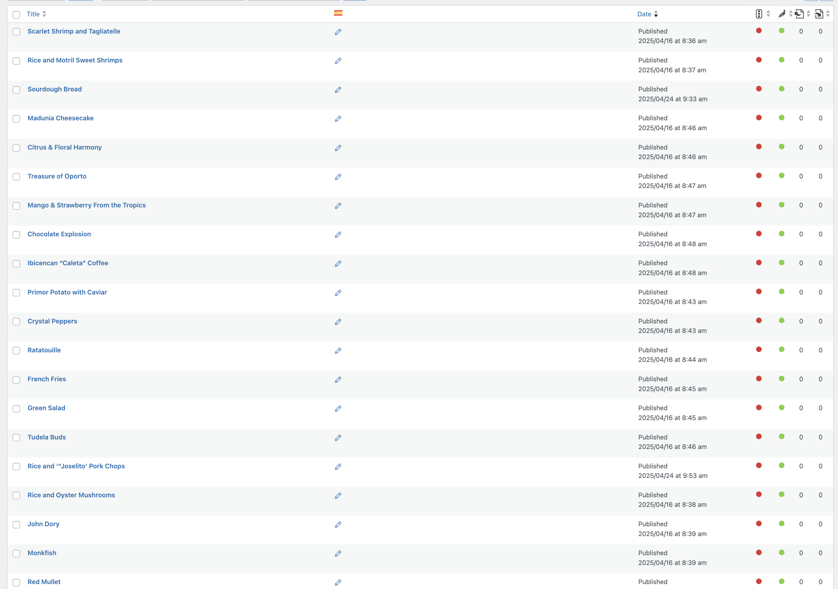

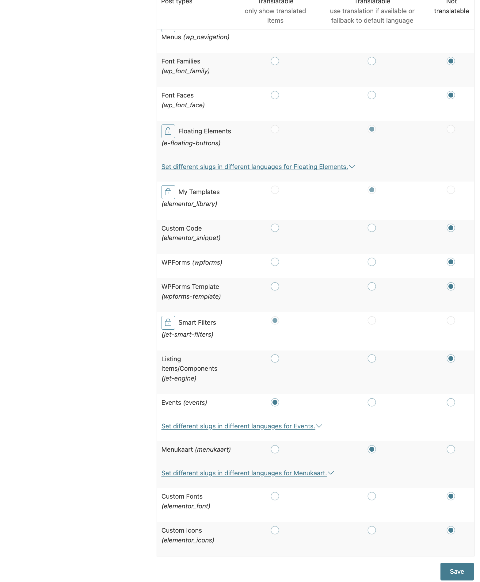

I've followed this guide and all settings are correct and every aspect is translateable.
Matter of fact, i've already translated all of the entries in the post type.
i've attached screenshots of my settings and also some of the entries.
As you can see all entries are translated, hence the pencil icon.
They do show up on front-end by changing one setting now. However most of them still pull the english version, instead of the translated Spanish version.

I have checked and I can see you have not translated the Listing grid as suggested in the JetEngine docs.
Never mind this, I have set your Menukaart post types to be Translatable - only show translated items, and it seems to show up ES menu now fine.
Please check.

thanks for checking. However, i believe we are still kinda running circles regarding a solution. As seen in previous support replies (screenshots attached again) all the posts are translated properly in the post type 'Menukaart'. However, spanish front-end only shows only one post in the first listing grid.
For example: Poget Oysters is 100% translated. It shows on english, but not on spanish.
The same goes for: National Lobster Cream Salad, Joselito Ham, etc.
Any idea why this is still the case?

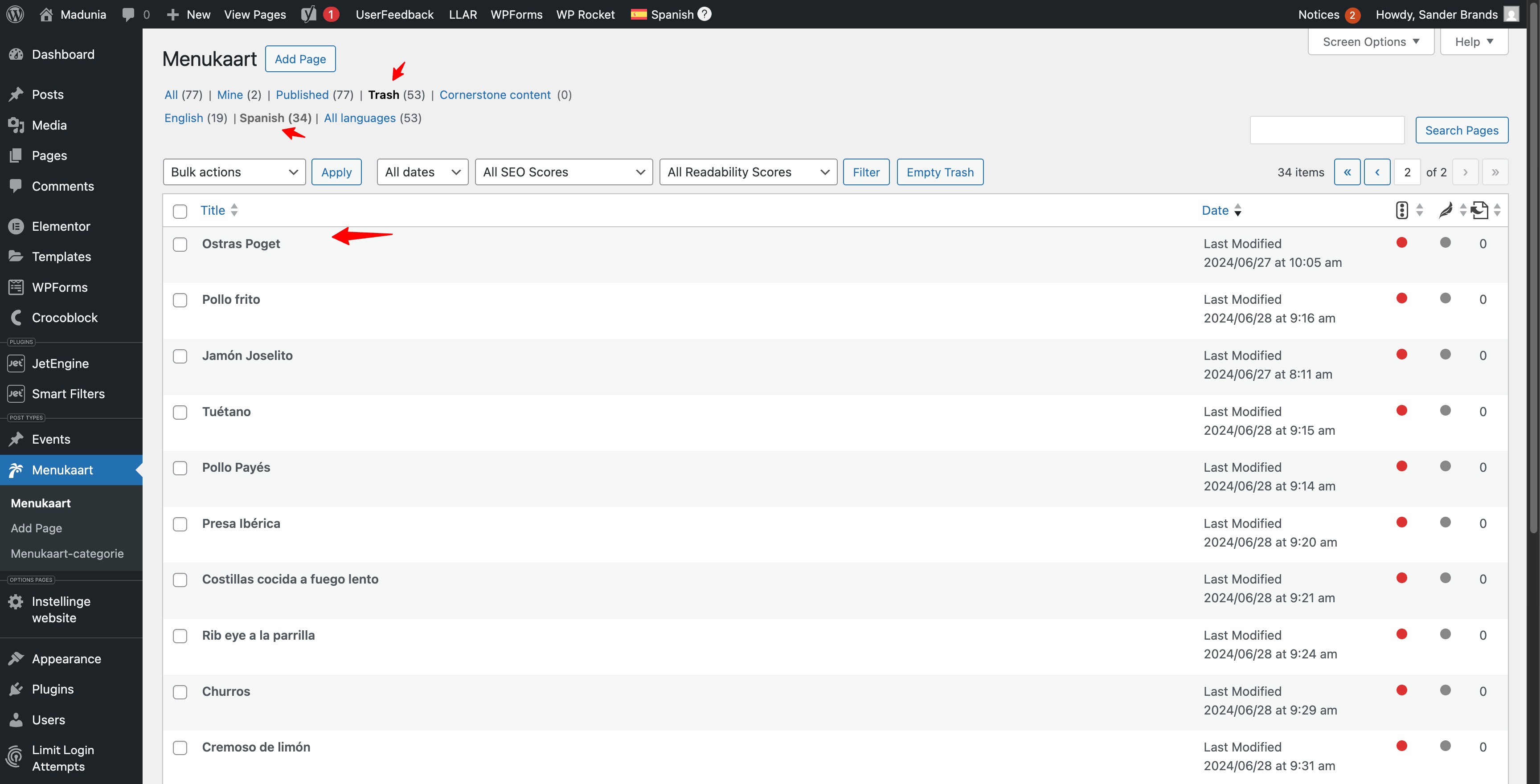

May 6, 2025 at 11:27 am #17001254
Dražen
Actually it is working as expected.
You have set to show published posts, but your translated post, for example, Oster Poget, is in trash / bin.
You need to restore it and have it published.
Drazen
