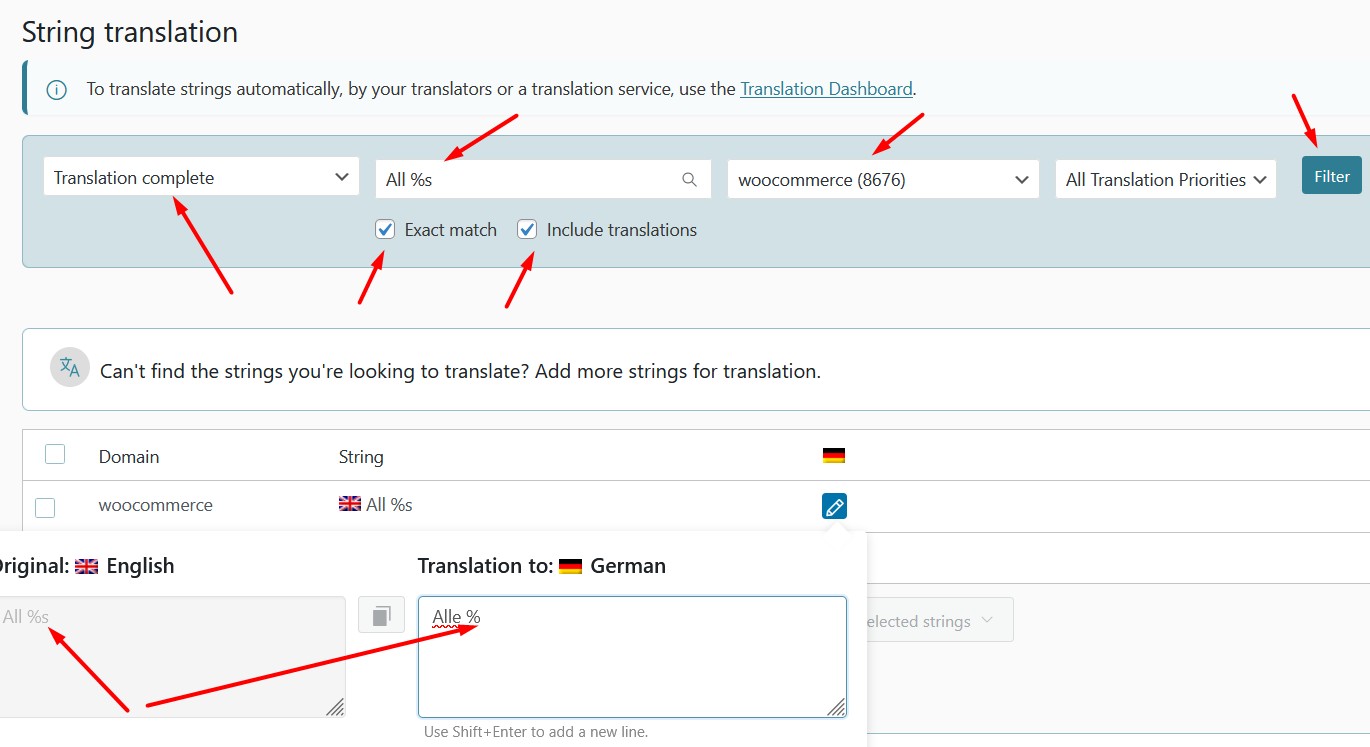

If you're experiencing this issue, we recommend you try the following steps:
1. Navigate to WPML >> String Translation.
2. Search for the "All %s" string.
3. Select the WooCommerce domain and enable the "Exact match" option.
4. Update the German translation from:
Alle %
To:
Alle %s
This should resolve the issue.

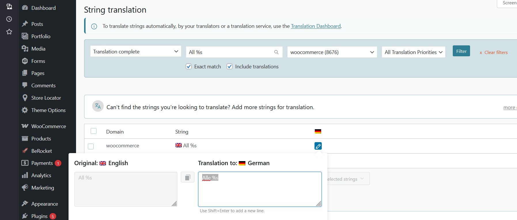

Sorry you’re still having issues. I found the problematic string causing this error. Please follow these steps:
1. Go to WPML >> String Translation.
2. Search for the “All %s” string.
3. Select the WooCommerce domain and enable “Exact match” option as you can see in the attached screenshot.
Alle %
To:
Alle %s
This should resolve the issue. Could you please check and confirm?
Thank you for your cooperation and patience
