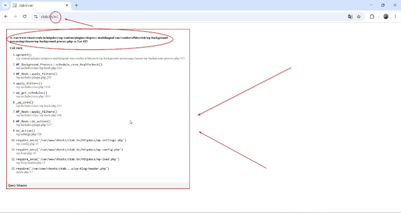

I recently installed the WPML plugin on my website ctab.tn, which is originally in French. I added Arabic and English as additional languages and configured custom directories for each language: hidden link (base language), hidden link, hidden link. I expected my web pages to be correctly translated and accessible through these links, with smooth navigation between languages via the language selector in the footer.
I encounter a critical error in the wp-background-process.php file whenever I try to switch to another language, making the site inaccessible and preventing me from viewing my translations. Additionally, I was charged immediately for automatic translations despite the system indicating 'use now, pay later.'

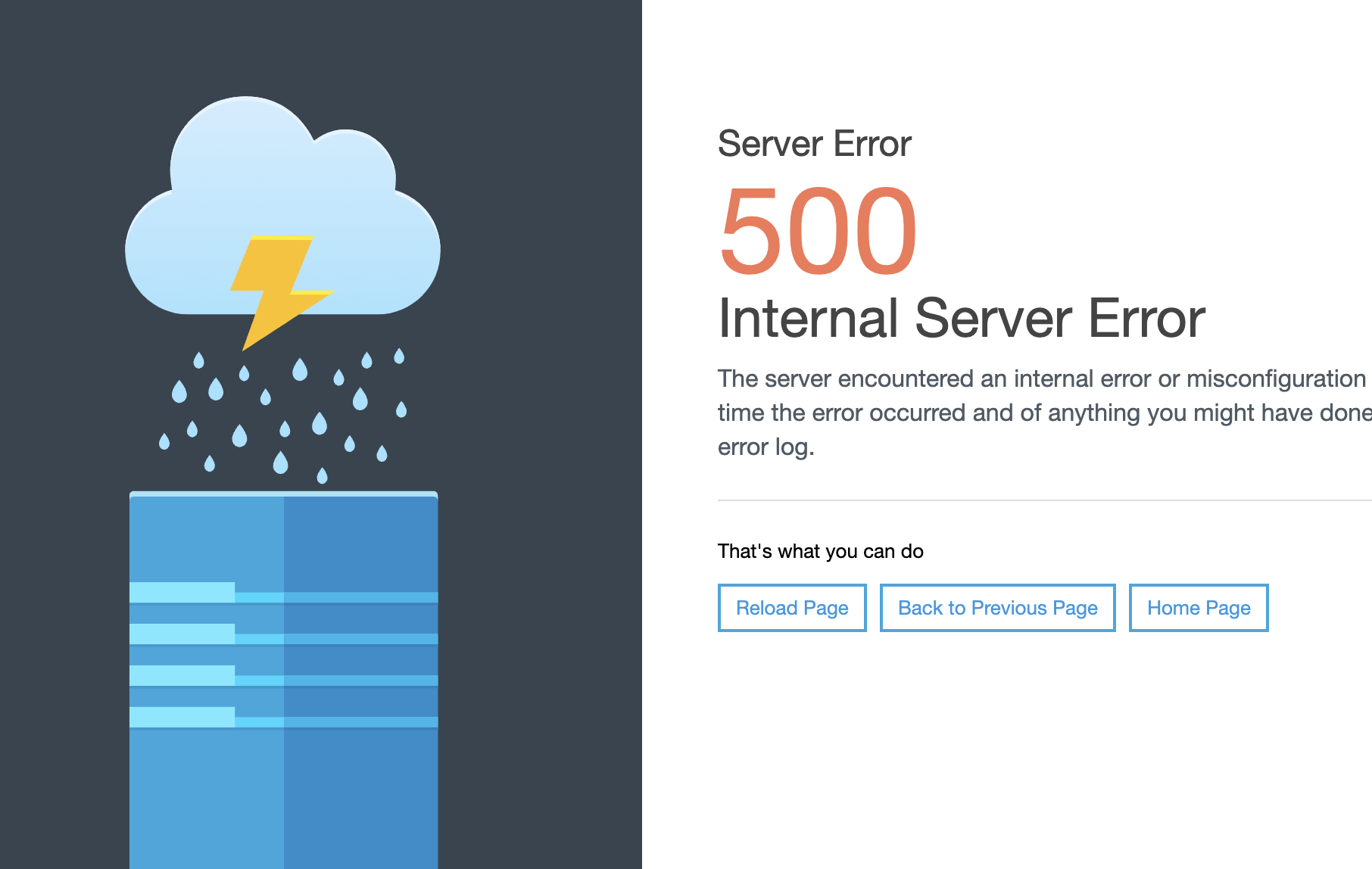

i was able to successfully access the site, however, each time I attempt to navigate to Dashboard -> Plugins I am receiving an error 500 that seems hosting related.

I follow these steps:
1. Go to hidden link; loads and then I close it
2. Got to hidden link. --> loads and i am in the backend OK
3. Try to view the front end of hidden link and it either works or it gives me an error 504 and then that leads to err 500 or just a blank page, and that happens both in the front end and backend.
Unfortunately this is not allowing me to test this issue properly.
