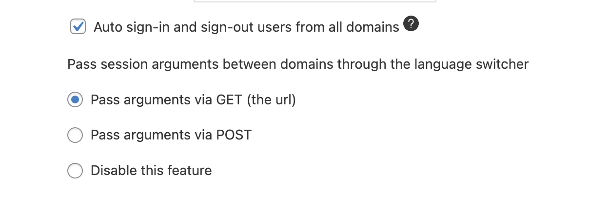

Would you please go to WPML > Languages and under the separate domain options make sure that the "Auto sign-in and sign-out users from all domains" option is enabled?
Also try the lower options both the POST and GET one and tell me if it fixes the issue?
Thanks.
April 21, 2025 at 9:59 am #16951464
tuncayO-2
Hello
I tried both option but still it is the same problem.
