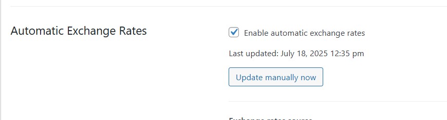

August 5, 2025 at 8:23 am #17295349
bikbulatovaE
Hi guys, the currency rate update should occure 1x time per week. We are the 5 of August and it didn't update since 18th of July (manual update). I believe I've got specific issue for this website with cron jobs...

August 7, 2025 at 1:56 pm #17302844
Waqas Bin Hasan
WPML Supporter since 05/2014
I'll recommend updating WooCommerce and WCML to the latest versions first and then recheck.
IMPORTANT: Please take full backup of your website and database beforehand.
If issue continues to appear, then please try the following:
1) Take a full backup of your site and database before proceeding. It is highly advised to try these on a dev or staging site first, so your live site isn't compromised.
2) Deactivate all plugins except WPML, String Translation, WCML and WooCommerce.
3) Switch to a standard theme like 2024 or 2021.
4) Check for the issue if it still happens.
5) Then start activating plugins one by one while keep checking for the issue. This way you 'll be able to pinpoint a conflict when & where it starts creating the problem.
6) If after activating all plugins you see that it still works fine, then switch to your theme and see if that's causing it.
Please let me know your findings and I'll try my best to help you further on the matter.
Regards.

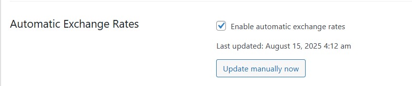

August 15, 2025 at 10:11 am #17323146
bikbulatovaE
It seems to work...
How could a plugin interfere with this cron job?
Because I have +40 plugins on this site. Troubleshooting will be long.
Need to identify the potential problematic ones
August 15, 2025 at 11:44 am #17323474
Waqas Bin Hasan
Thank you for the updates and good to know that issue isn't coming from WPML/WCML.
We can't guess that what is interfering, until either we have some error logs or go through the prescribed debugging method.
I'll recommend to enable debugging in your site. See https://wpml.org/documentation/support/debugging-wpml/ for details. Once enabled, then activate your required plugins and let the job run. If there's a catchable error, it'll be logged in /wp-content/debug.log file when the job is executed.
