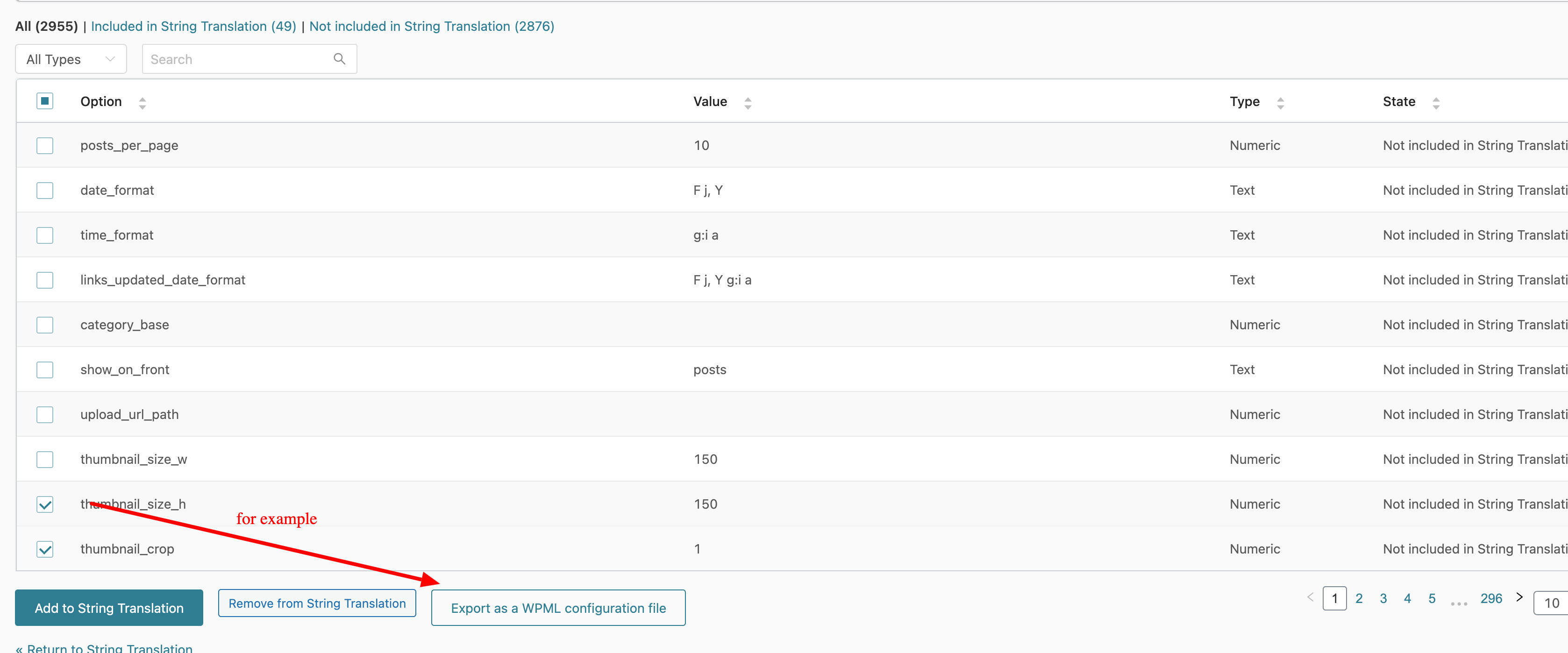

To make sure the config is correct, go to WPML → String Translation, open the "Not seeing strings that you are looking for?" tab, and click "Admin Texts Translation". On the Admin Texts Translation page, find your footer text and "Export as a WPML configuration file". Attached the screenshot. Then, you can add it to WPML → Settings → Custom XML configuration.

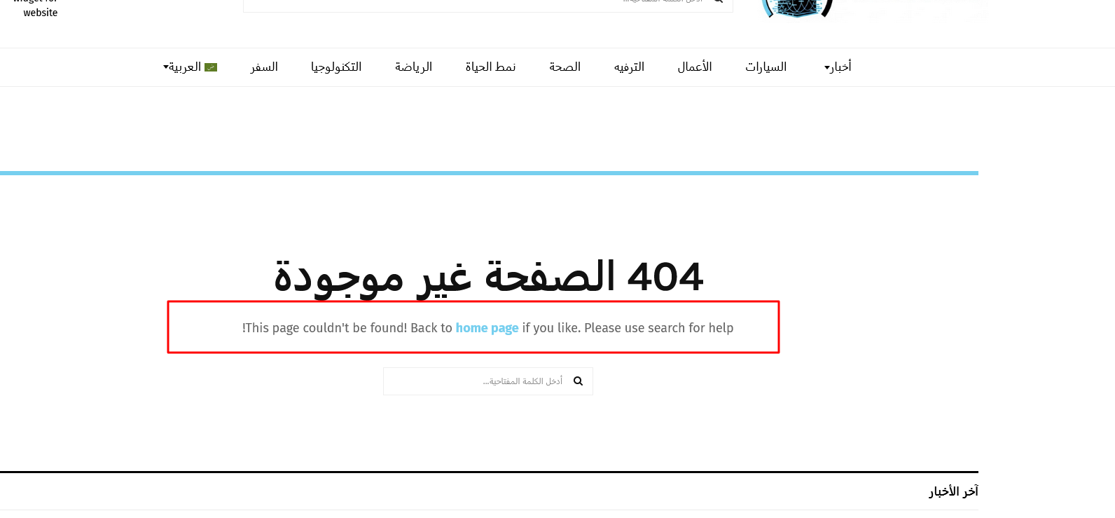

But the problem is - I cannot even find below string :
"This page couldn't be found! Back to home page if you like. Please use search for help!"
You can see here: hidden link
I found above header one(404 الصفحة غير موجودة) but not this one
What is the issue ?

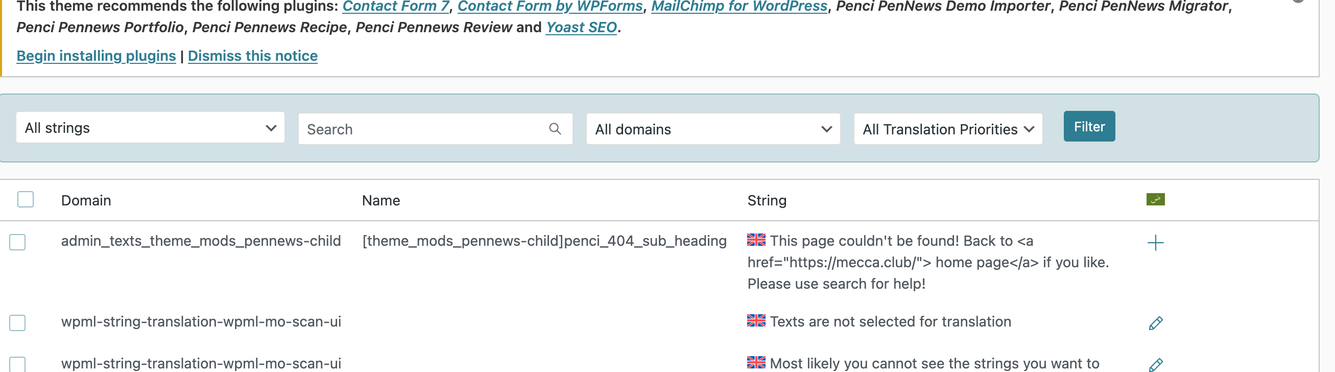

January 13, 2026 at 6:32 pm #17727089
josephN-9
Thank you for your help.
but I want to ask you , how you added this string on "string translation".
What is the process to make this type solution?
I had tried many times , many times visit and even I don't find it on admin text area ?
how you added this string on "string translation". ?

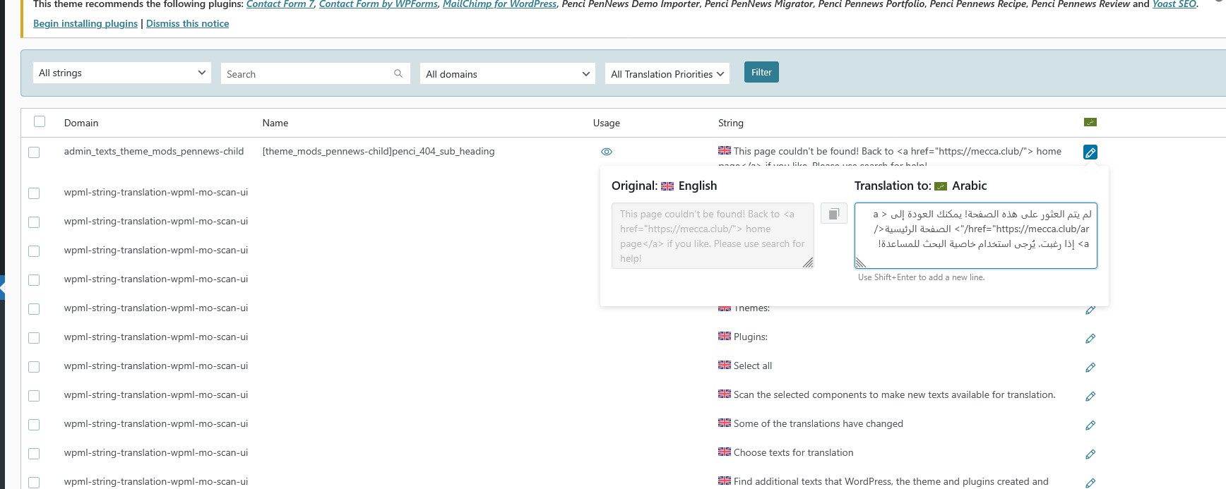

January 14, 2026 at 1:11 pm #17729471
josephN-9
I have translated that string but still not change on frontend

January 19, 2026 at 10:11 am #17741702
Andrey
WPML Supporter since 06/2013
Thank you for your patience.
I’ve investigated this further, and it turns out that this specific translation isn't being displayed due to a theme compatibility issue.
As a workaround, I added the following code to your child theme’s functions.php file to ensure the string is correctly translated:
add_filter( 'theme_mod_penci_404_sub_heading', function ( $value ) {
    return apply_filters( 'wpml_translate_single_string', $value, 'admin_texts_theme_mods_pennews-child', '[theme_mods_pennews-child]penci_404_sub_heading' );
}, 20 );
I’ve also shared this information with our team so they can forward it to the theme author.
