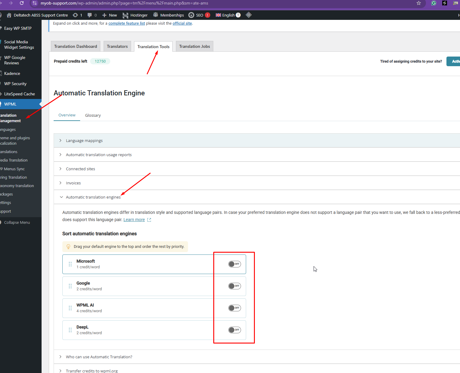

3. Upon further investigation, we discovered that all Translation Engines were turned off. We turned them back on for the client and asked them to check if the issue was resolved.

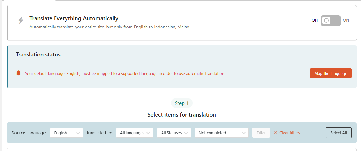

I am trying to map the default language for my site hidden link using WPML.
The setting does not seem to take effect and I keep seeing 'Your default language must be mapped'.
How do I correct this problem?

Thanks for contacting us. Could you please navigate to WPML > Language > Edit Language and let me know if you've mapped the language? Also, are you getting any errors when you try to save changes?
Also, please backup and try deactivating 3rd party plugins that might be conflicting with WPML(preventing the option from saving). Let me know how it goes.

Hi Kor
Yes, I have tried that and saved without issue, but the message still shows.

May 30, 2025 at 8:21 am #17090902
Thanks for your reply. I've checked and it looks like you've turned off all the Translation Engines as shown in the attached screenshot.
I've turned it back on for you and could you check now?
