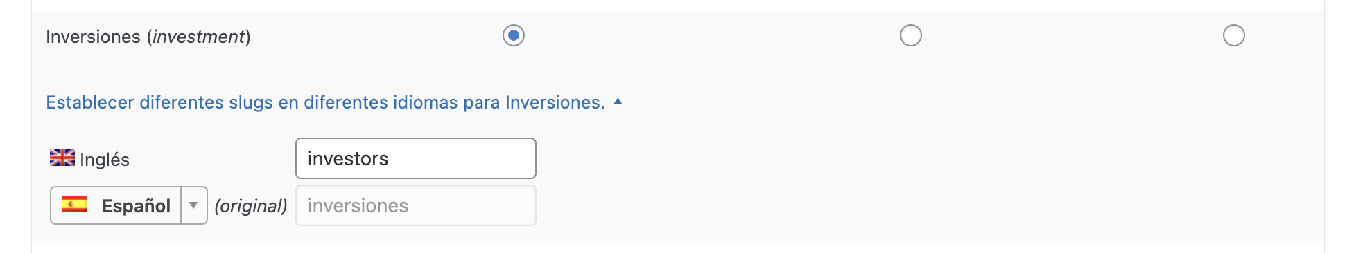

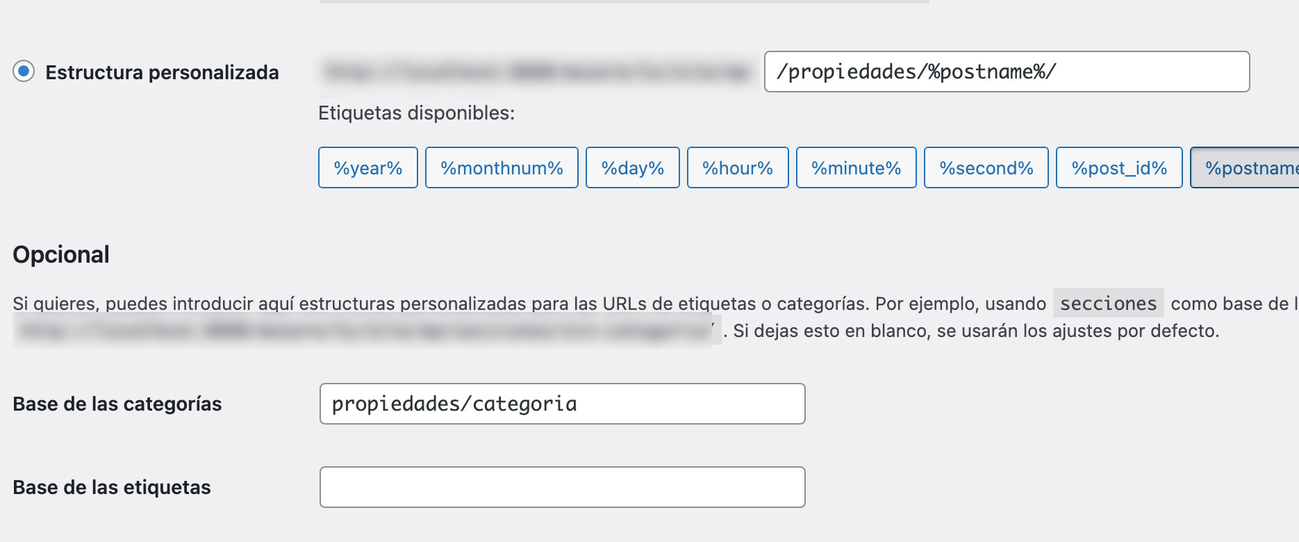

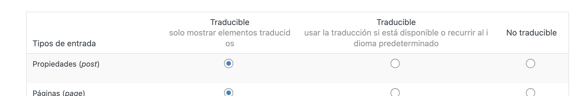

I’m having an issue when translating posts (post type "post", not a custom post type) and using the custom permalink structure including the main language slug in there as the attachment (/propiedades/%postname%).
The problem is that I can’t see the option to translate this slug as it is possible with the custom post types (see attached).
So when translating to english, the permalink structure stays as "/en/propiedades/..." and we need it to be "/en/properties/..."
How can I do it?
Unfortunately to move all the content under the main post type "post" to a cpt is not an option for us right now 🙁
Btw, it works great when translating the base category slug ("propiedades/categoria" to "properties/category").

As mentioned, this is NOT a custom post type, as the CPT are not the problem here (as per the shared attachment when translating the CPT “investment” slug from “/inversiones" to “/investors").
What I need to translate is the slug defined on the custom permalink structure for the native/reserved post type "post”.

I checked further and it seems Custom Structure is not translatable, as it is supposed to be used by tags not strings for translation.
