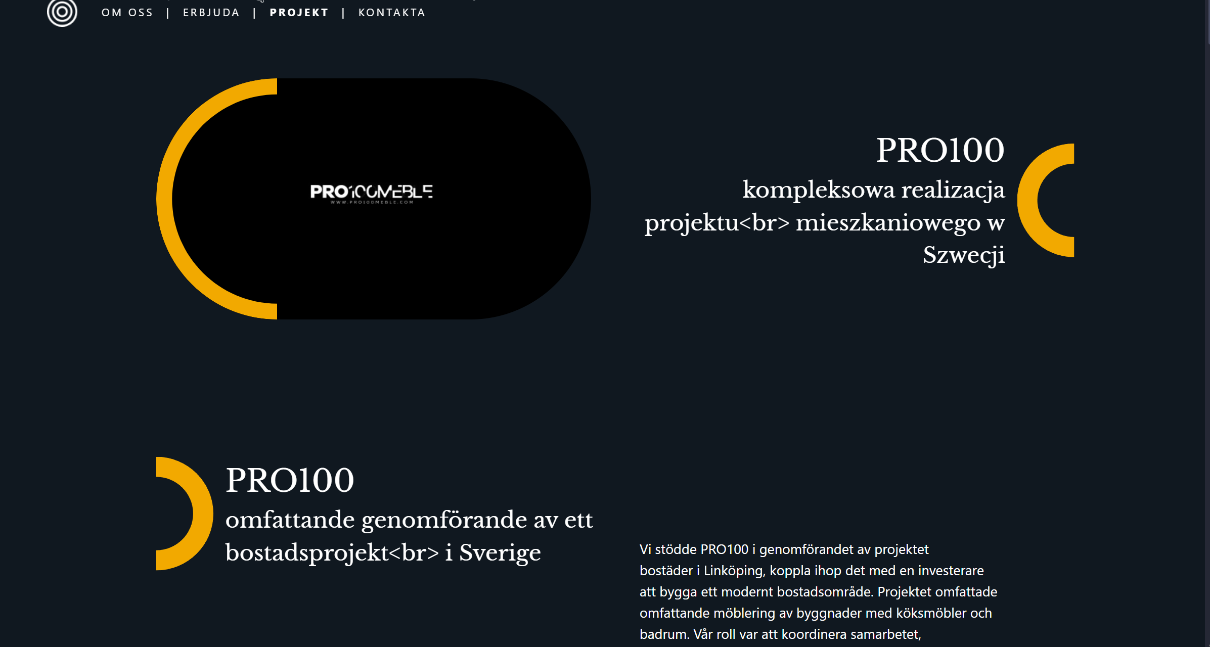

However, I would like to reframe my issue, as I believe the specific problem I'm seeing—the duplication of content—is directly related to how the WPML plugin functions, rather than just being a simple theme bug.
To be clear: translations are being saved correctly, and the system works perfectly in the primary language. The issue is exclusively with how WPML handles the display of content in secondary languages.
When the Swedish page is loaded, the content is duplicated, showing both Polish and Swedish text together. This specific behavior—the mixing of two languages in the final output—seems to be a fallback mechanism within the WPML plugin itself.

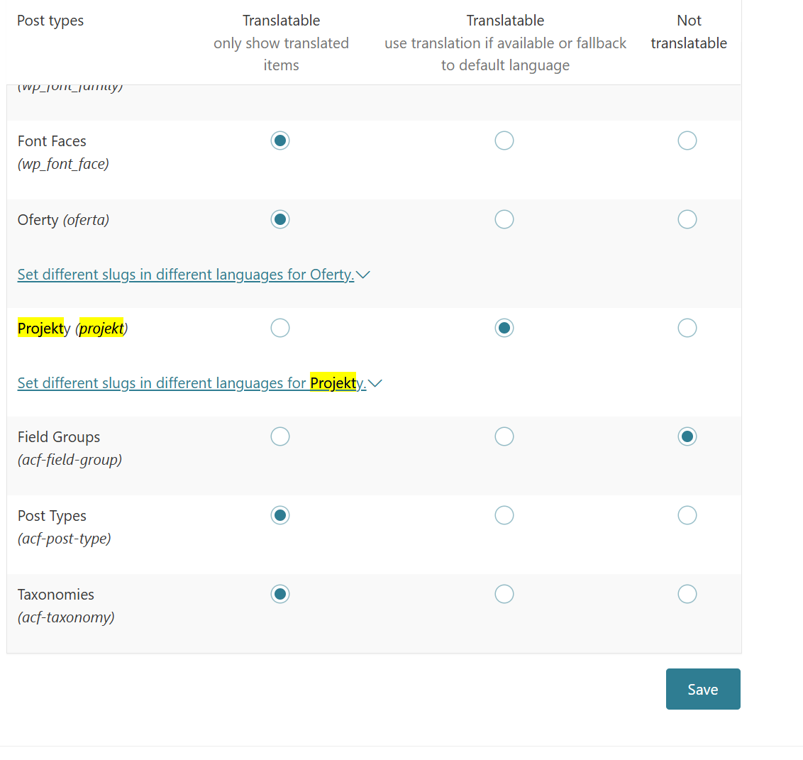

Thank you for the clarification on the fallback settings.
Following your advice, I have changed the setting for the 'Projekty' post type to 'Translatable – only show translated items'. I have also cleared all server and browser caches.
Unfortunately, the issue persists. The content on the Swedish page is still duplicated, showing both the Polish and Swedish text together.
