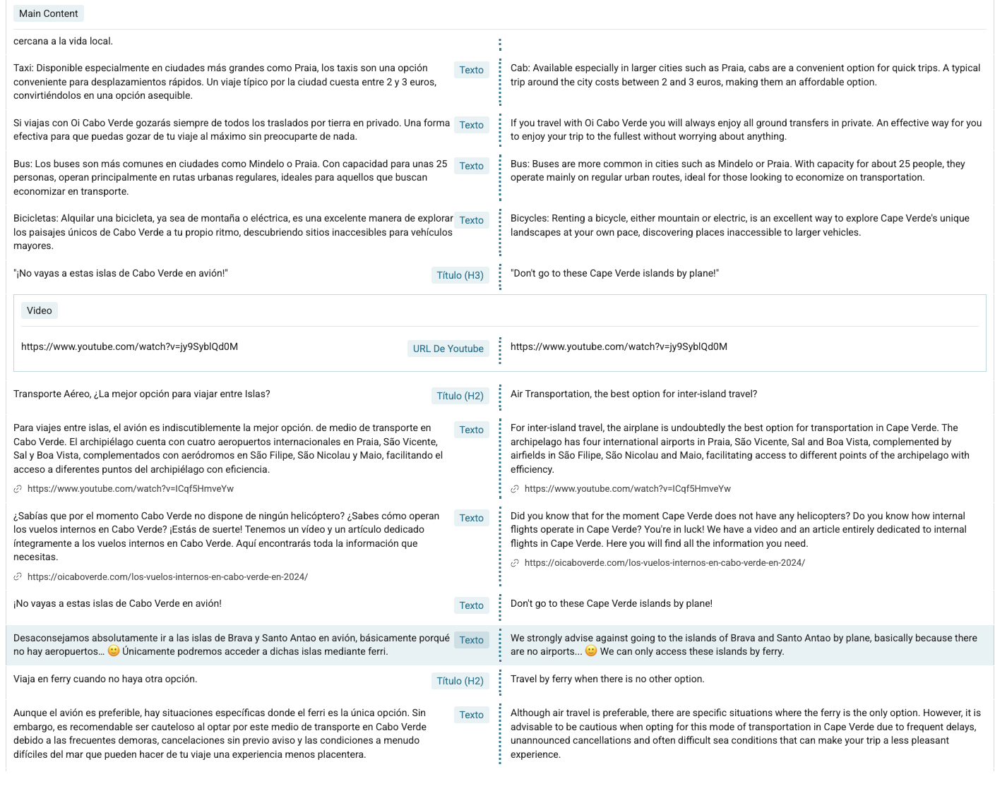

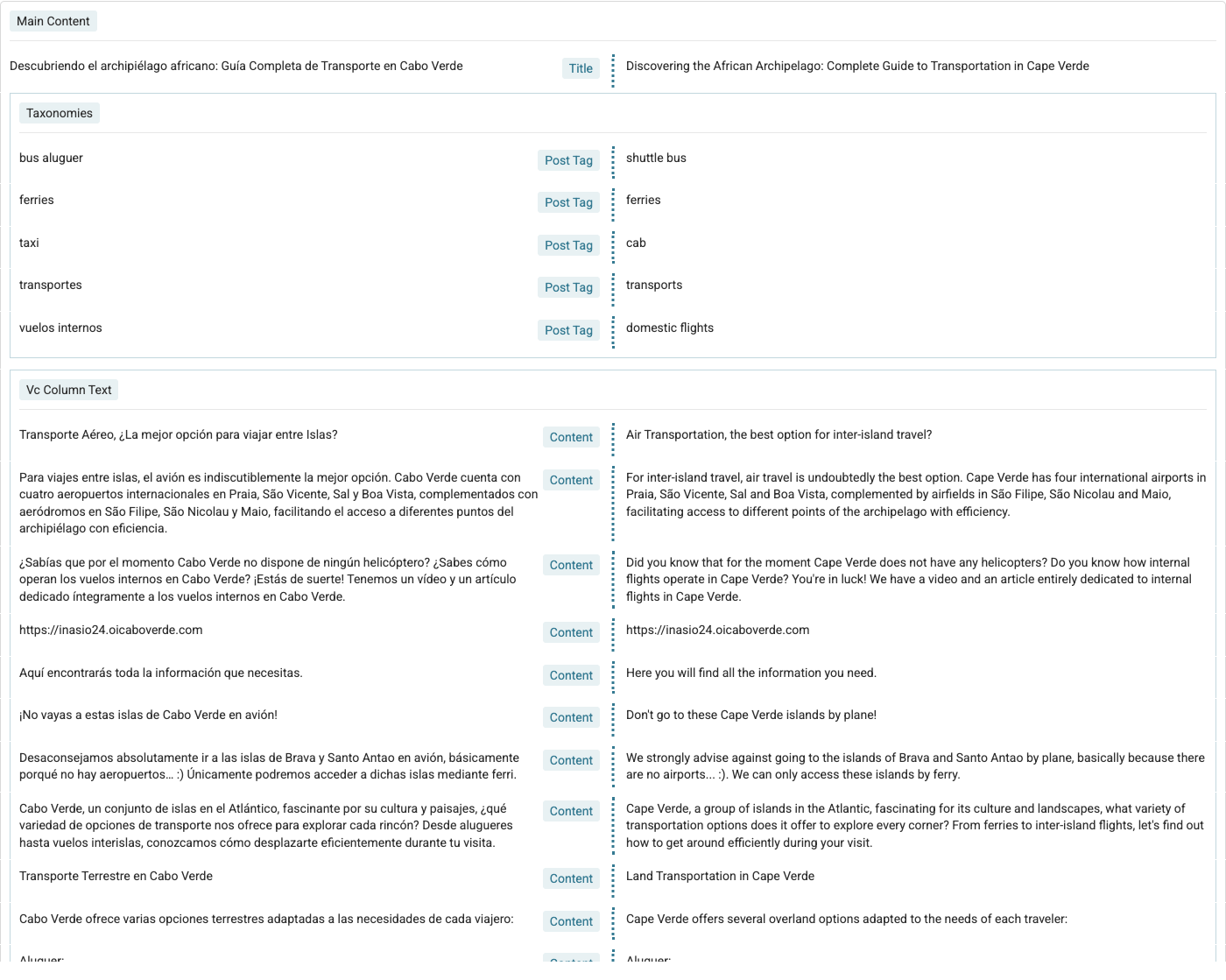

This website was built originally with WPBAKERY but we updated it using ELEMENTOR and another theme. We deleted all the wpbakery codes and copy the content to Elementor but even this codes are nowhere anymore, WPML is using old WPBAKERY (sometimes for desktop and smartphone texts) + the new ELEMENTOR ones.
The old context appears under "VC COLUMN TEXT" and the new one, the only one we can edit in ELEMENTOR, appears under "MAIN CONTENT".
So in some cases plugin used 3 times more credits than it should use.
Hope we can solve this,
thanks again,
Xavi

Could be that you have not deleted completely the data from WP Bakery, I advise going manually in post_meta table in your database and checking if all related WP Bakery code for that post (ID) is delete or still exists.
If issue still happens you can go to WPML > Packages, find your page ID and delete it.
It should then work fine, but as said you need to first confirm all related data is actually deleted, and best is to manually check in your database.

I deleted packages in WPML > Packages. Then I updated each post and then updated the translation and the old code finally disappeared.
