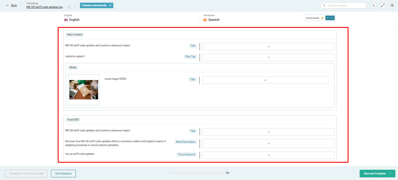

December 15, 2025 at 2:42 pm #17664703
gizem-leylaE
As shown in the screenshot, only limited fields are available in the Advanced Translation Editor.
The translation interface displays:
- Title
- Post tag
- Media (image title)
- Yoast SEO fields (SEO title, meta description, focus keyword)
However, the main post content/body text is completely missing from the translation editor.
No text/content fields are available for translation.
This happens on blog posts that have not been translated yet, regardless of whether the content was created using the WordPress editor or a page builder.
December 15, 2025 at 3:17 pm #17664896
Shekhar Bhandari
WPML Supporter since 03/2015
Hello there,
Please check the issue for this page, it's fixed now.
The issue was happening due to two things:
- One elementor_data was set as translate
- The elementor content was added as html and it was broken.
- I edited the content and removed the style part from the html and it's fixed now.
Check this to see what I did: hidden link
If you want to add styles, please add it using css tab on elementor.
Please test this same on another page and see if it helps.
