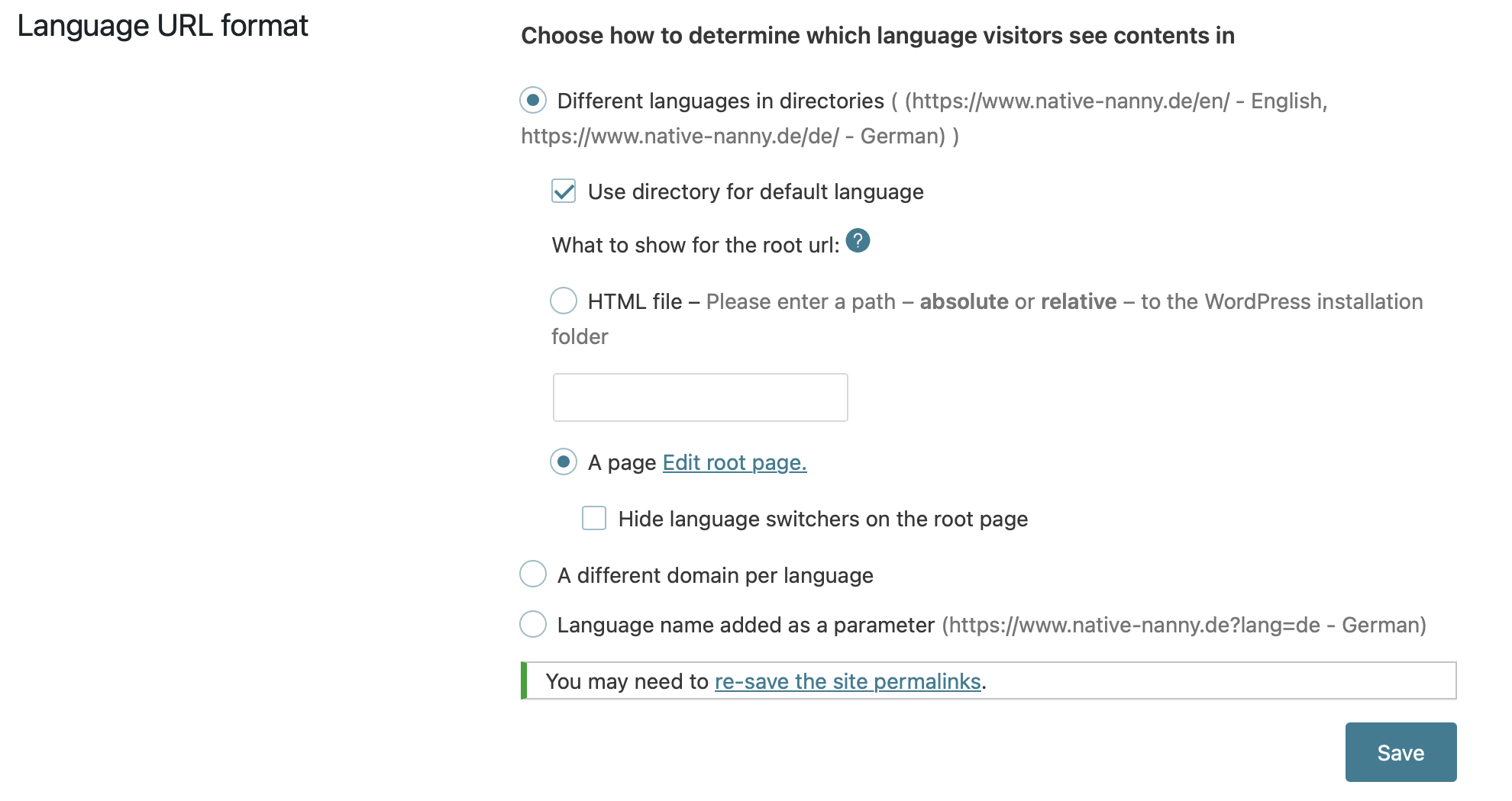

1) I noticed that the Redirect plugin was deactivated without informing me, that needs to be on to redirect from the root page hidden link to hidden link automatically. Can you please confirm it was you, so I can rule out any bad actors? I only got the one notice that you had logged in, not any other Administrators.
2) the Duplicator plugin was installed, although we already have Duplicator Pro, was that you too?
3) Since you have logged in, the site is responding differently when loading the homepage hidden link. It is redirecting to some random nanny-ad, and I can't even determine which one, it seems random to me. Also I notice, there is no longer /de/ or /en in the URLs. On inspection of the WPML > Languages > Language URL Format settings, I see it has been changed from the first option "Different languages in directories ( (hidden link - English, hidden link - German) )" to the third option "Language name added as a parameter (hidden link - German)
". Can you confirm if you made this change too? I changed it back to what we need it to be for all our URLs and translations to work correctly!
Also after changing it back to the first option, and clicking Save, I got a message saying I "may" need to re-save the permalinks. That's a bit crazy and vague. How I am supposed to know if I MAY or MUST re-save them?? There is no other information provided. If it is a MUST, surely the software should do that automatically, no?
4) Also I noticed the default flag format was changed from SVG to PNG. Can you confirm if you did that too?
5) Did you make any other changes?
I'm not particularly happy about the fact that all these things were changed without informing me. Especially the Language URL setting. I hope our translations are all still working, many strings have hardcoded translations which require the /en or /de on the URL!!

Everything up to #4 was done by me during troubleshooting.
(no alteration to the images/flags or any other changes were done)
My apologies for not reverting them to default after troubleshooting was finished, this was an oversight and won't happen again.
Rest assured that the change in the url format will not affect your permalinks and no update is needed.
