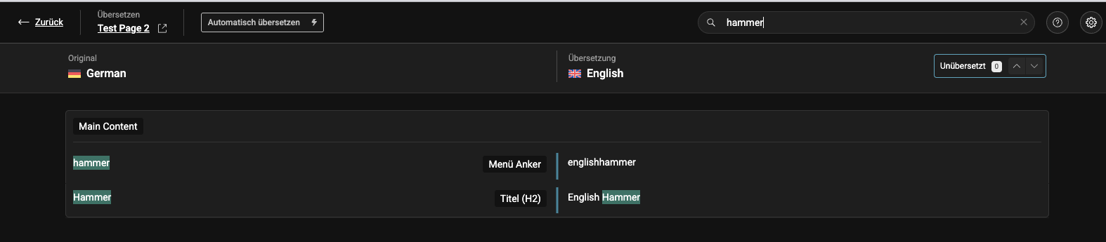

Check the screenshot attached, please. I
I changed the translation of Menü Anker. In fact, I removed the translation, changing it from englishhammer to hammer, and now the links works fine.
This word is only visible in the HTML as it's the ID attribute of the section. Anchors need to be the same in both languages because WPML does not know how to translate automatically the anchor part of a URL. Alternatively, we will need to translate the URL manually.
Is this a suitable solution for you?

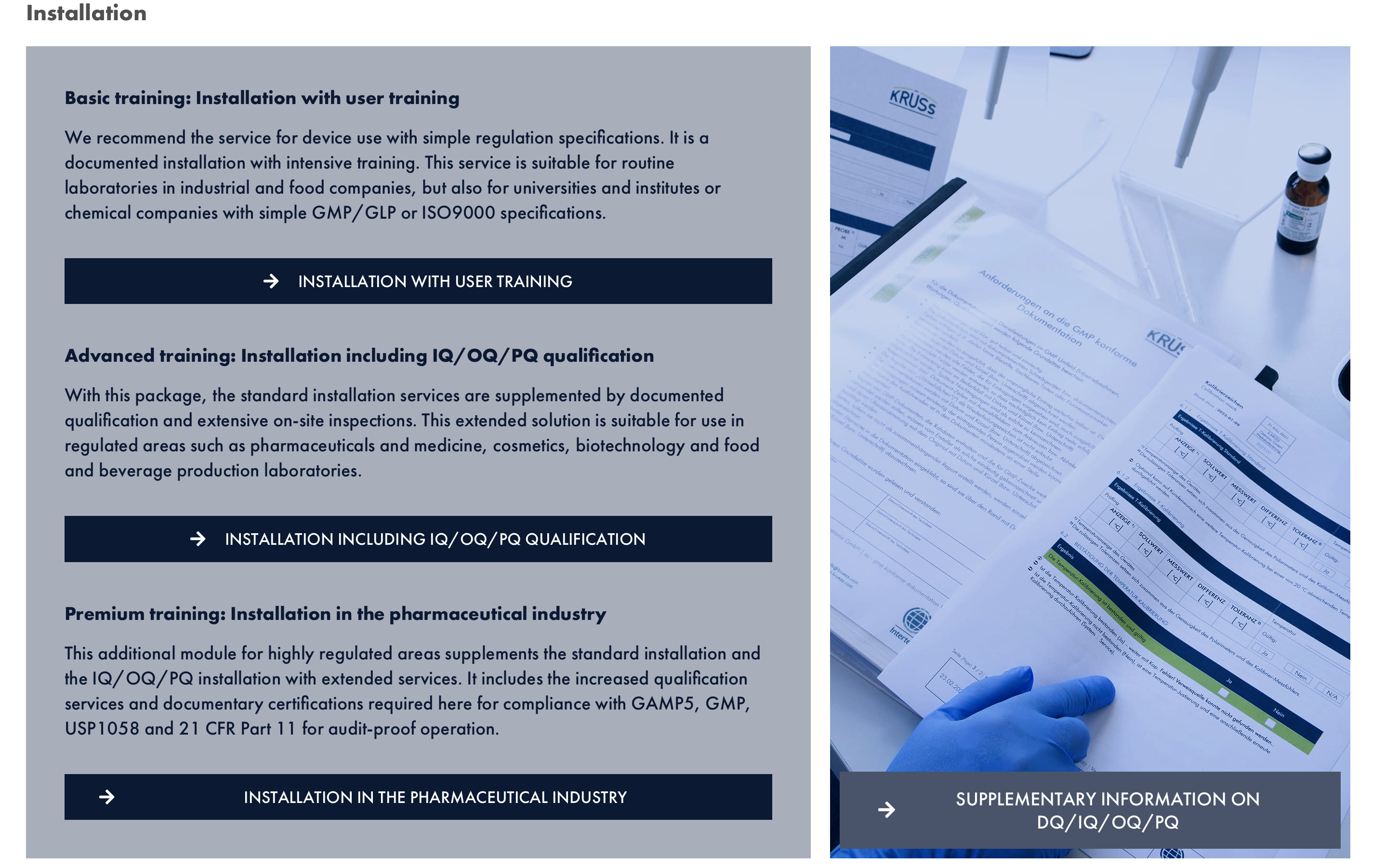

But I think, we have to switch to our staging site now. This is just an example. We have this Problem in other pages as well. In this page hidden link there are these 3 Buttons in German:
DICHTEMESSUNG PROBENÜBERSICHT,
DICHTEMESSUNG NORMENÜBERSICHT,
DICHTEMESSGERÄTE EINSATZGEBIETE.
All 3 link to #dokumente, which is a menu anchor at the same page, showing downloadable documents.

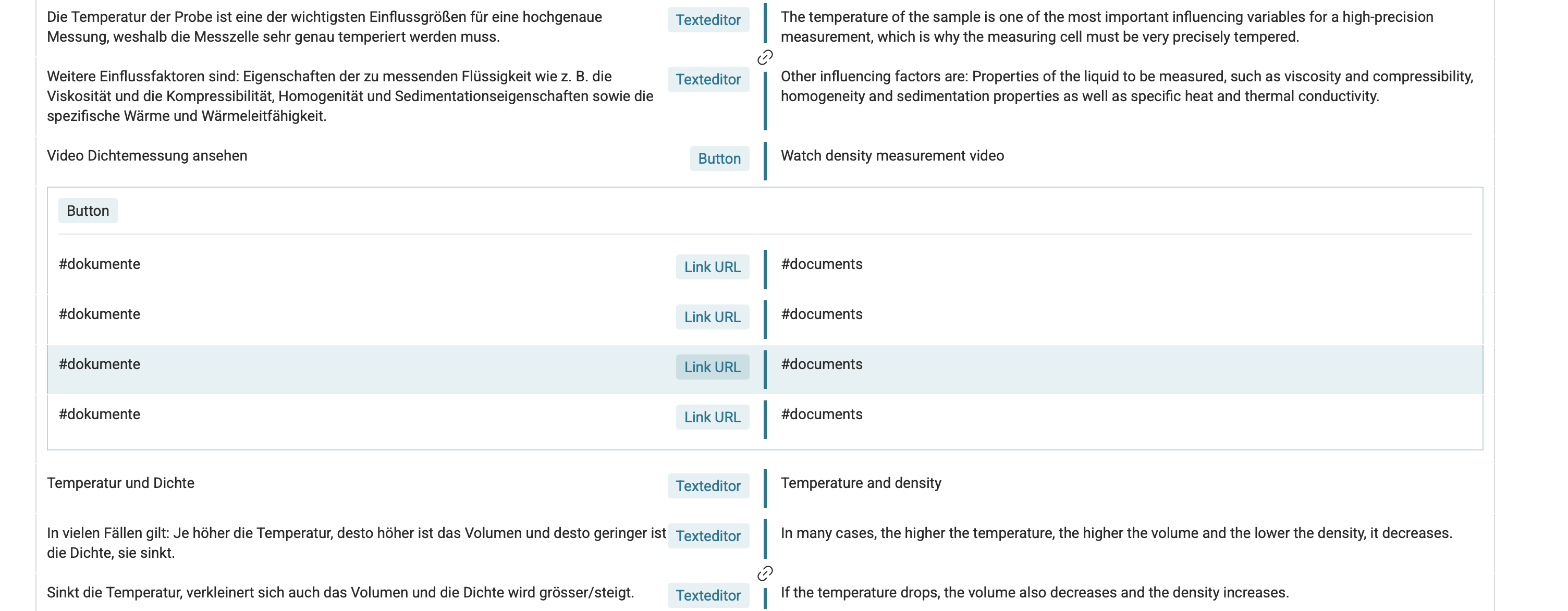

Now go to the English page: hidden link. The menu anchor is translated to #documents. We translated the Button links to #documents. See the screenshot. It's a little bit unusual, that the links are all underneath each other.
Have a look at these 3 Buttons in the page. They all still link to #dokumente, so the translation did not work.
In other pages these translations did work, specially in Product pages.
This is our main Problem. If you like, I can give you access to this site, as it is a copy of our real site hidden link.
