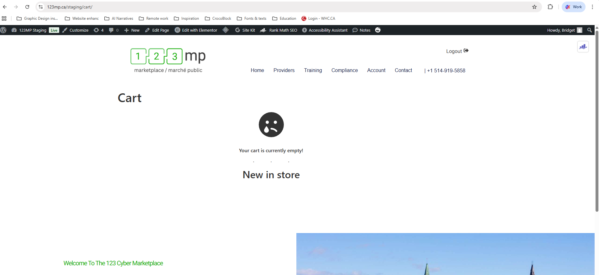

That website had to be reverted to a backup since it’s live. You can review the issue on the staging website: hidden link

I’ve looked into this, and I’m seeing the exact same issue even when all WPML plugins are disabled.
Here are the steps I tested:
1. I used this product to get tickets:
2. It redirected me to the checkout page:
3. If I manually open the cart page (as shown in your screenshot):
—the cart is empty.
The same behavior occurs with WPML disabled.
Based on this, it appears that you’re using the Eventin plugin’s custom checkout flow (/eventin-purchase/checkout/), but then checking the WooCommerce cart (/cart/). These two plugins likely do not share or sync cart sessions, which is why the WooCommerce cart shows as empty.
I hope this clarifies the situation.
