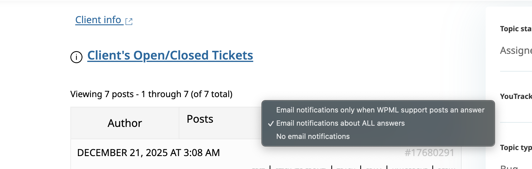

The email notifications are enabled by default, but if for some reason they are not, you can enable them by selecting the option at the top right section of the first question in the forum. (Please check the screenshot.)
