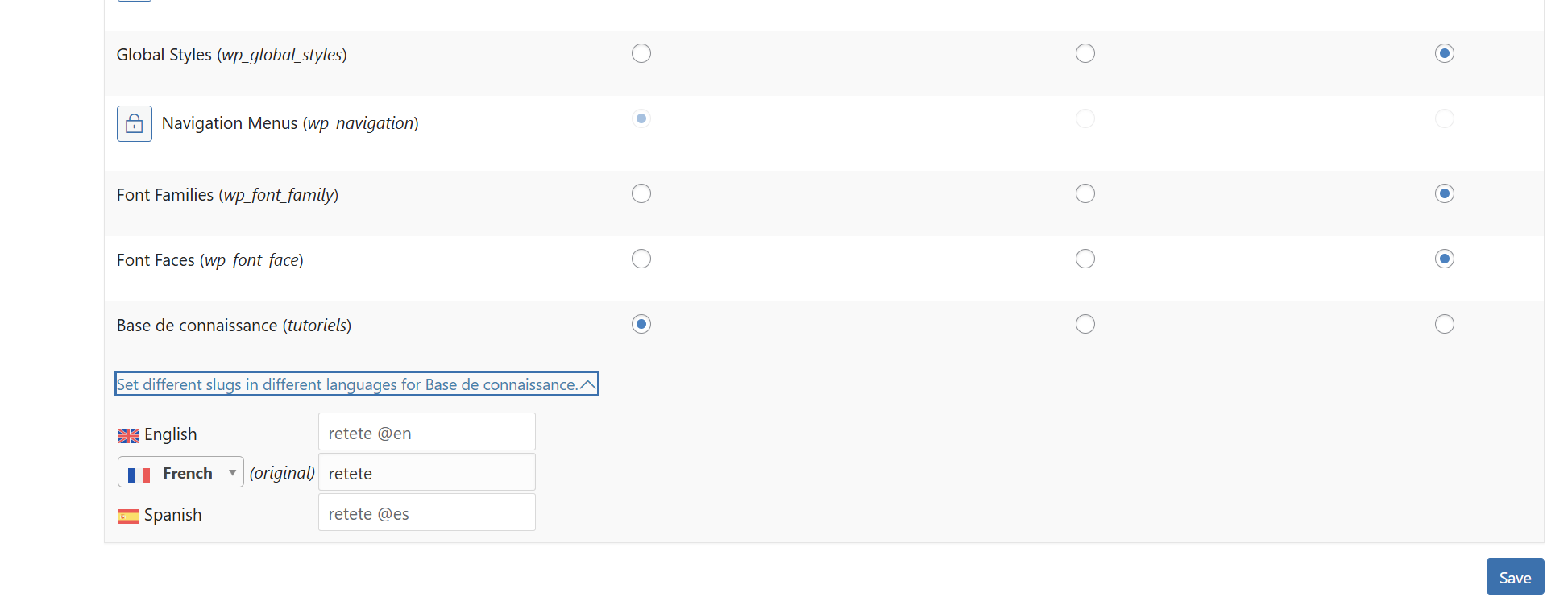

I did notice something surprising : while testing things out, I changed the rewritten slug of the custom post-type to "retete, and then changed in back to "base-de-connaissance" in function.php, but in WPML > Settings > Post Types Translation, the slug is still registered as "retete", even after deleting WPML's cache.

First, regarding the weird thing:
- I went to WPML > String translation.
- Searched for the string "retete" and deleted it
- Then I went to WPML > Theme and Plugins localization and rescanned the theme again
- After that, the slug of the post type is back to Baise de reconnaissance
- I translated it and everything kept working as expected.
