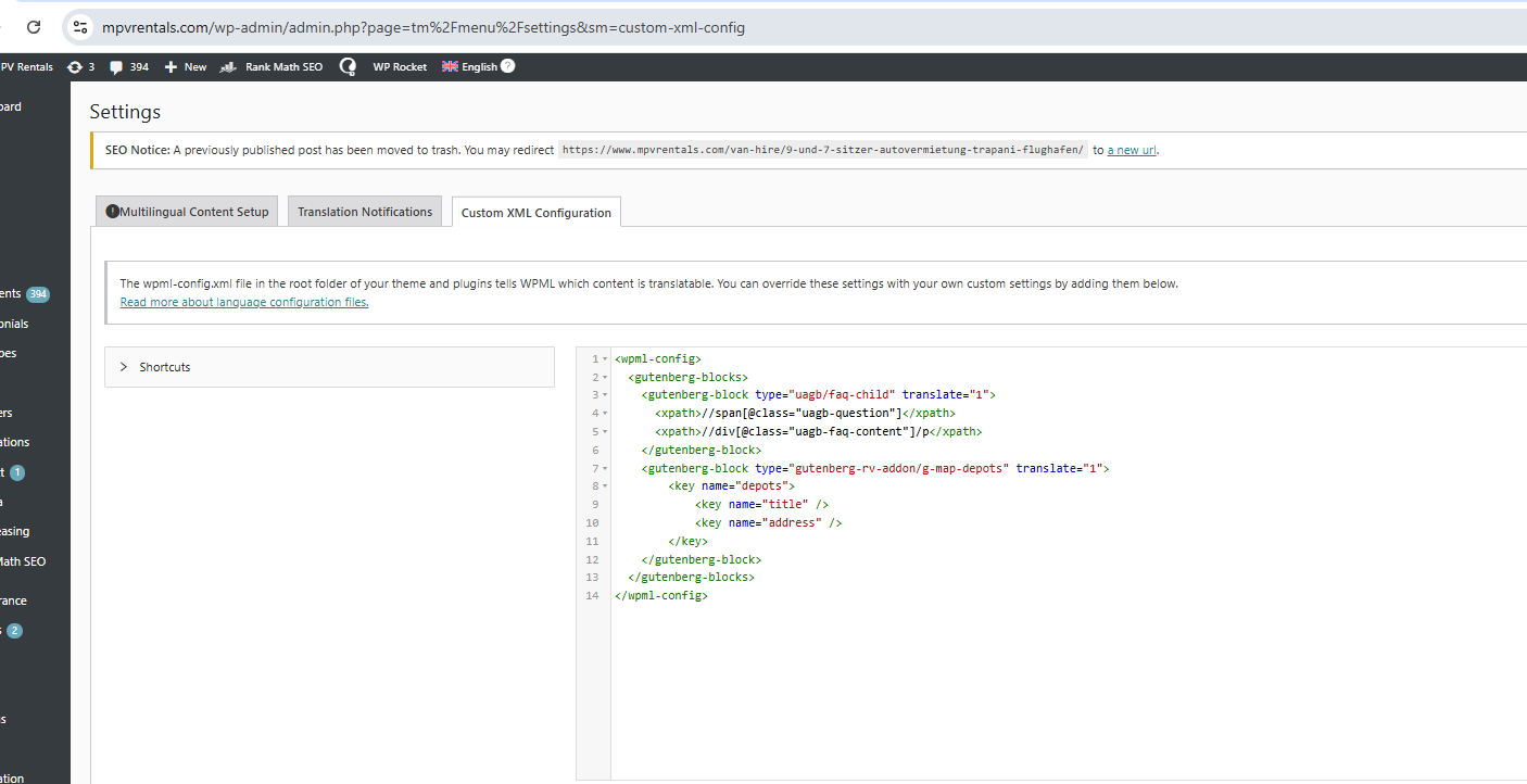

You are working on a site under development and trying to translate the FAQ section using WPML, but the FAQ section is not translated.
We recommend checking your WPML settings for Custom XML Configurations. You might need to add the following XML configuration to ensure the FAQ section translates correctly:
<wpml-config><br />  <gutenberg-blocks><br />    <gutenberg-block type="uagb/faq-child" translate="1"><br />      <xpath>//span[@class="uagb-question"]</xpath><br />      <xpath>//div[@class="uagb-faq-content"]/p</xpath><br />    </gutenberg-block><br />    <gutenberg-block type="gutenberg-rv-addon/g-map-depots" translate="1"><br />        <key name="depots"><br />            <key name="title" /><br />            <key name="address" /><br />        </key><br />    </gutenberg-block><br />  </gutenberg-blocks><br /></wpml-config>
Compare this XML with what is currently set under WPML > Settings > Custom XML Configurations. If this solution does not resolve your issue or seems outdated, we highly recommend checking related known issues at https://wpml.org/known-issues/, verifying the version of the permanent fix, and confirming that you have installed the latest versions of themes and plugins. If the problem persists, please open a new support ticket.

<wpml-config>
  <gutenberg-blocks>
    </gutenberg-block>
        <key name="depots">
        </key>
    </gutenberg-block>
  </gutenberg-blocks>
</wpml-config>

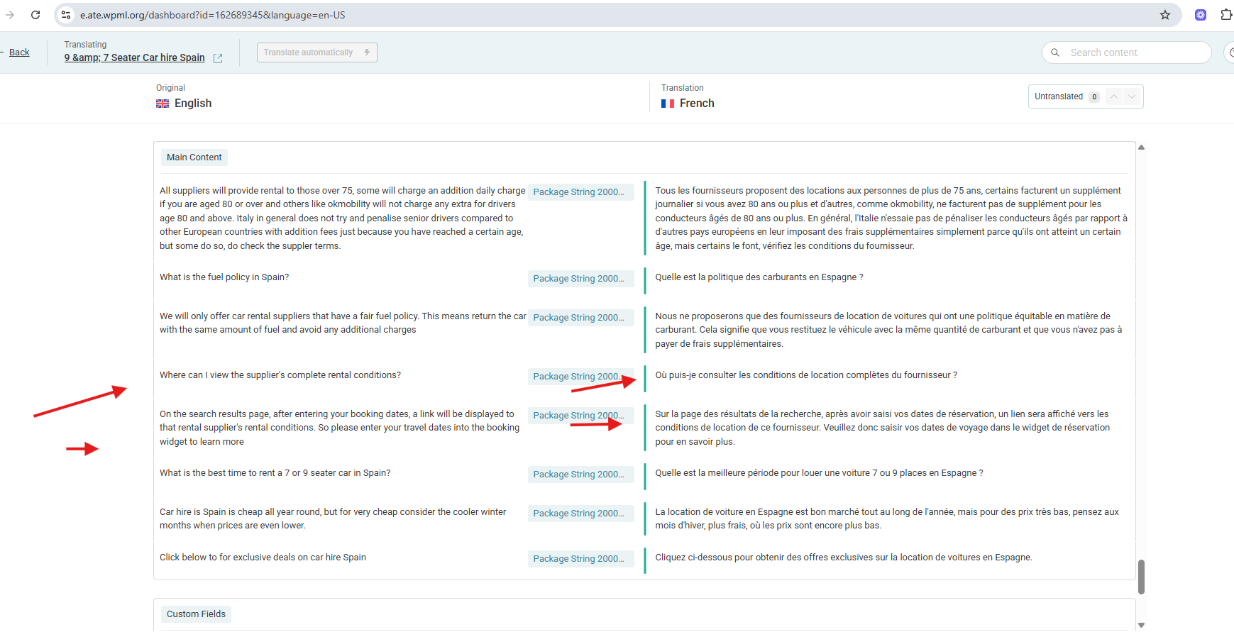

October 7, 2025 at 2:22 am #17462130
eamonnT
I did add the new code and then updated the translation, but the FAQ are still ot translated

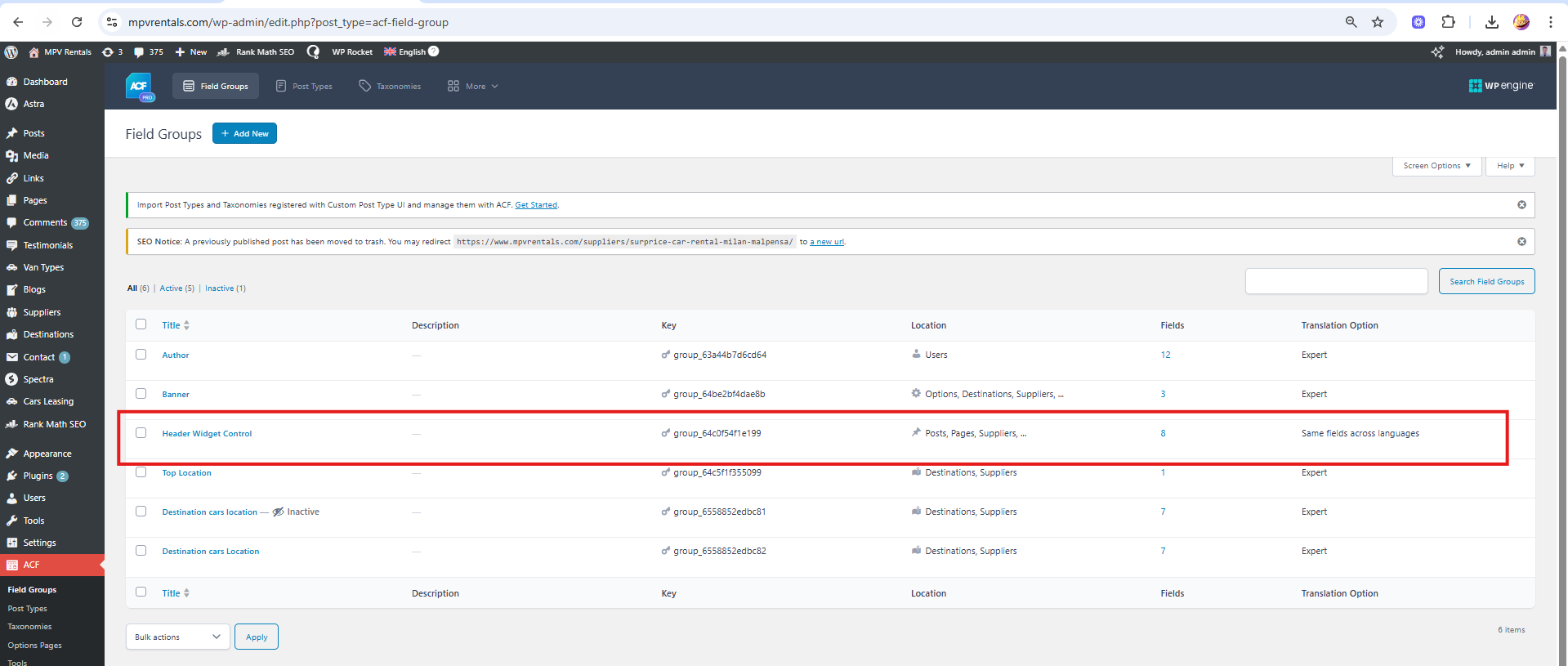

In the backend, it says that this page needs manual translation, because of the different ACF translation options used on this post.
In this case, there are 2 possible ways to proceed:
1. Ensure that the Field Groups used in this post, have the same translation options. You can set that in the Field Group itself. After that, update the original and the translations.
2. Translate the posts manually, using the WordPress editor:
Let me know how you proceeded and also if you had any issues.

October 9, 2025 at 12:51 pm #17471372
Lucas Vidal de Andrade
You can check for all the Field Groups that are set to show on this page, and ensure they have the same Translation preference.
After doing that, update the original and the translations. I'm asking that, because I think it might be affecting how the FAQ block is rendered on the front end. Let me know if that makes any difference. I'll be here to continue support, if it doesn't.

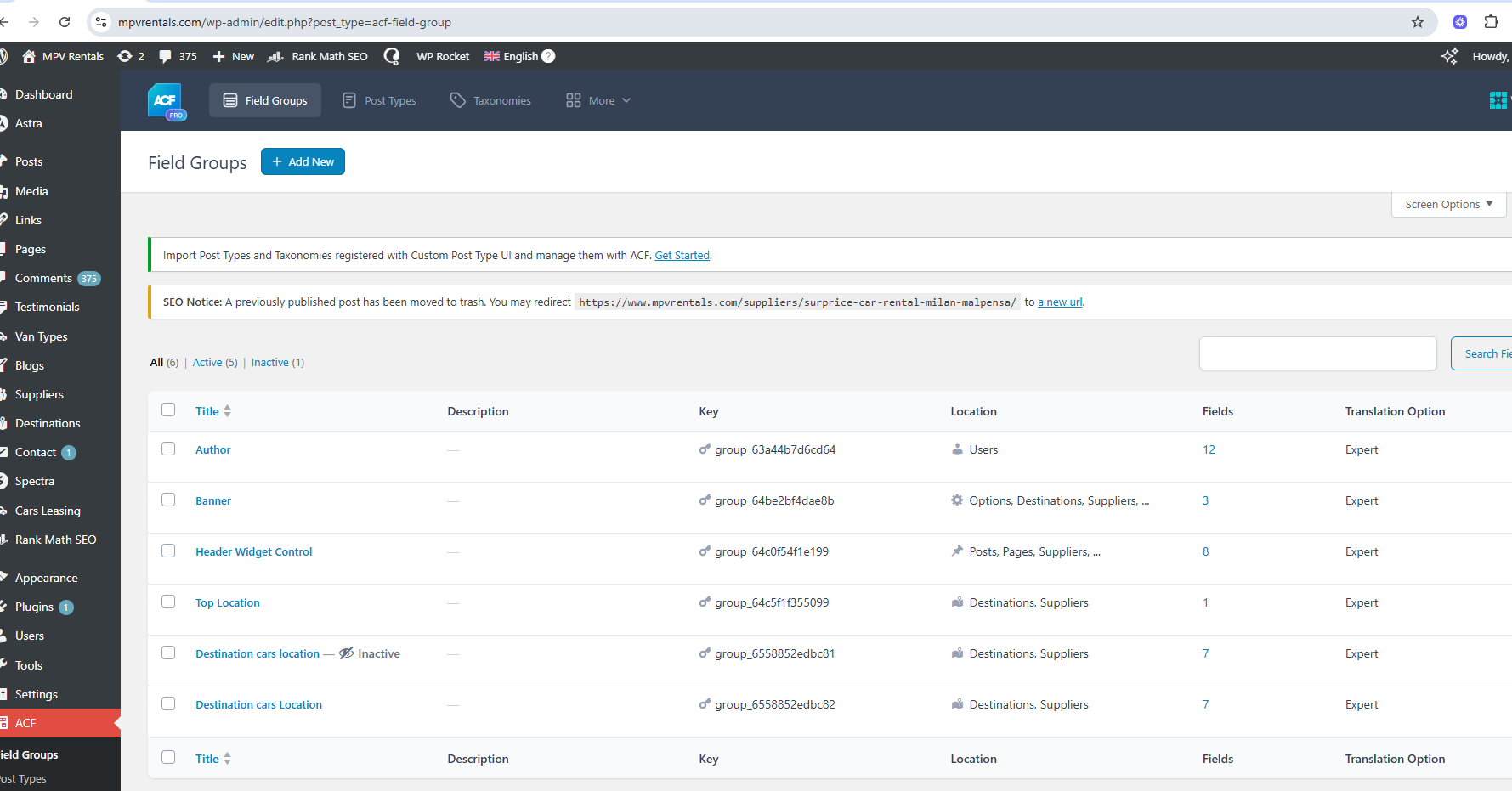

October 10, 2025 at 2:15 am #17473278
eamonnT
I identofied the ACF fields and set to be all the same expert

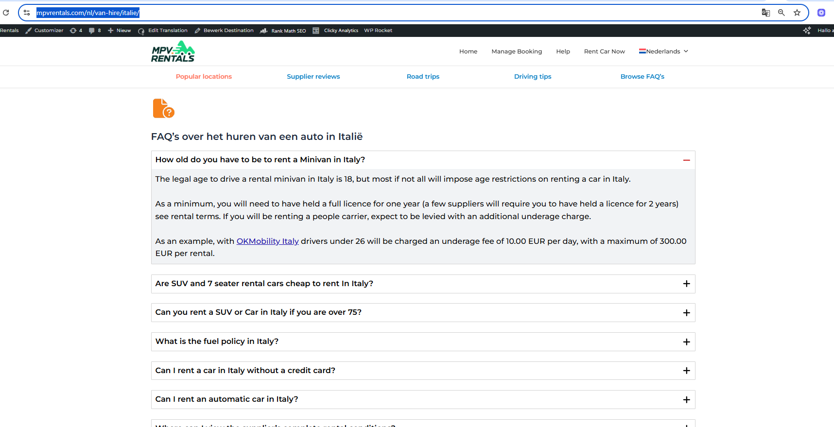

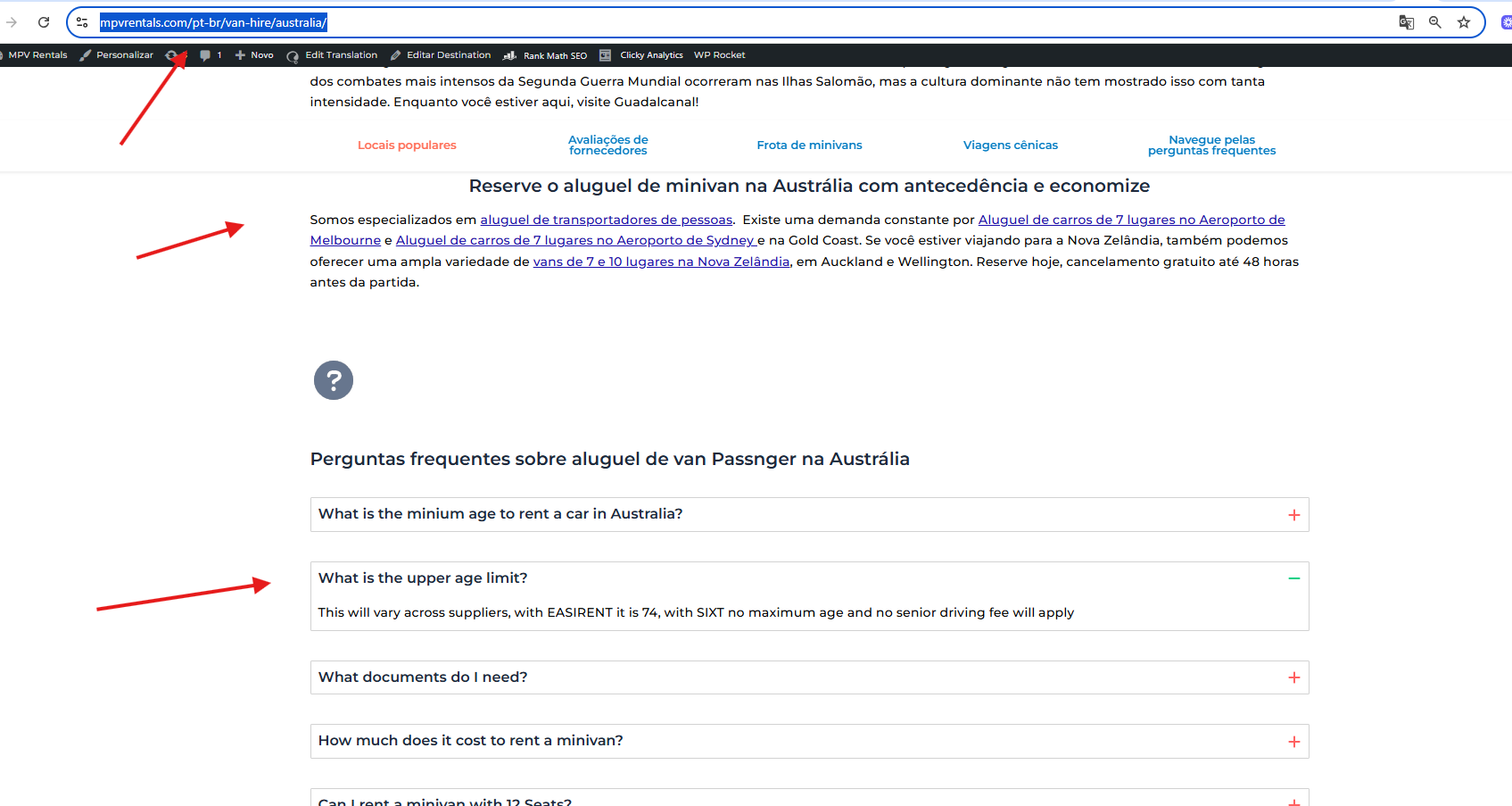

eamonnT

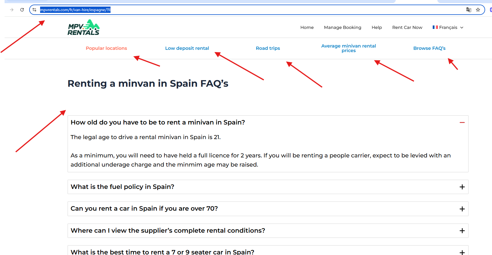

set to expert and then run translation fro French page.... and it seems tobe working as can now see faq being translated, but when I view the page the fAQ still in English ( plus other parts of the page see introduction )
I thoght it may be cache issue but I added some paramaters to url STILL showing in English
Please can u login and sort this out as being dragging on iover 3 days and holding me back... thanks
see
Thank you for waiting. I was able to fix the issue, by dome some tweaking on the custom XML. Everything should be working now 🙂 Can you please confirm?
October 10, 2025 at 8:58 am #17473889
eamonnT
okay wirking now,,,, what did u chnage can u share incase I need in future or make sure that I do not change
THanks for help
October 10, 2025 at 1:27 pm #17474590
There are 2 lines added. You can compare what's on WPML > Settings > Custom XML Configurations, to what's been shared here. Thank you for your patience and cooperation 🙂
