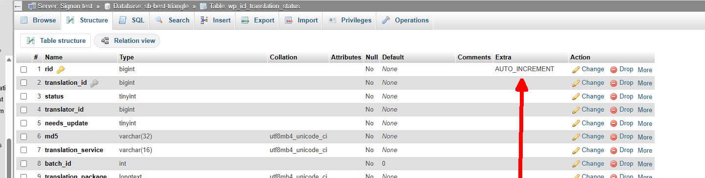

batch_id should be there - see my screenshot on how this table should look like.
You could try adding it through cPanel e.g. or perhaps:
ALTER TABLE wp_icl_translation_status
ADD COLUMN batch_id INT NOT NULL DEFAULT 0;

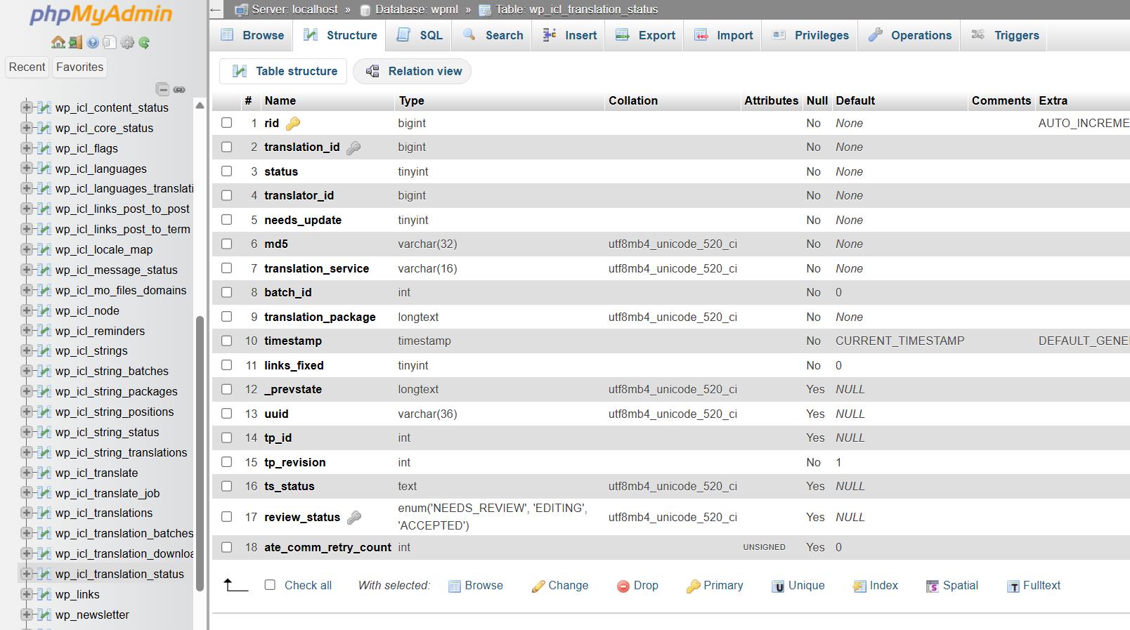

I’ve created a sandbox site for this purpose:
The "WP phpMyAdmin" plugin is available on the site, so you can use it to compare your broken tables with the correct structure and make the necessary fixes.

For the "rid" column within wp_icl_translation_status, is any value 0? If so, delete this row. Also make sure that there is AUTO_INCREMENT set for it (and other icl_ tables as well).
