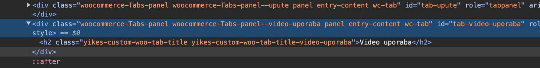

May 16, 2025 at 5:24 pm #17042979
Bobby
Is this issue happening only with Classic 2 or with other products in the Croatian language?
It is interesting because it works OK in Spanish as well as if I add the Youtube Link via iframe in any other part of the product such as description.
I have also tested doing a duplicate of the defautl language into Croatian and it seems to still not show the video under that specific tab.
is there any custom code that would be causing some sort of issues with the product tabs under Croatian?
The HTML is fully missing from the tab.
