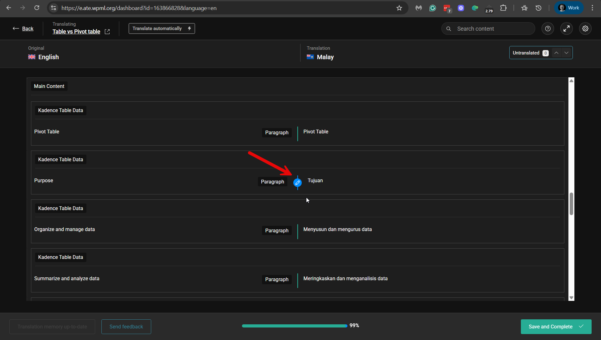

October 18, 2025 at 8:41 am #17495589
jeffreyG-8
I've also noticed that sometimes it says 98% or 99% complete on some pages, but I cannot find any untranslated text and when I click on save & complete, the job is completed.
The latest translation is this - hidden link (English - hidden link)
This did not happen previously with the older versions.

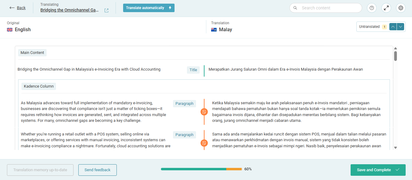

Today, I came across a similar issue with another page, this time 2 lines were flagged for later. Please see attached screenshot.
October 19, 2025 at 6:23 am #17496398
Itamar
I am sorry for any inconvenience you may have experienced.
This issue has been escalated to our Advanced Translation Editor developers and will be fixed in upcoming versions. Meanwhile, as a workaround, please edit those translation jobs and unflag the flagged sections. We will update you here once the version with the fix is released.
For the hidden link, you mentioned that can not be completed, please see that it has one section that is marked as 'Updated content'. Please see the attached screenshot. If you click this section and then move on to the next section, it will change the color to green, and the job will be 100% completed.
Itamar.

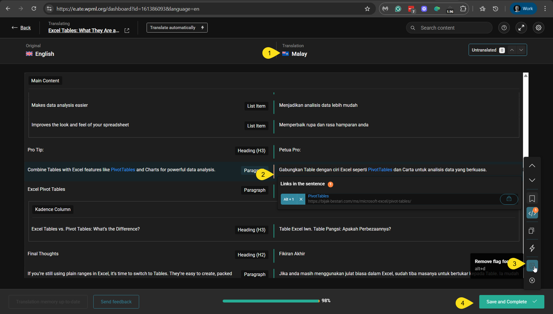

October 19, 2025 at 10:25 am #17496773
Itamar
I've just realized that you mentioned in this ticket two different websites. hidden link and hidden link.
Are you having this problem on both of these websites?
I've checked, from our side, the translation into Malay of this URL:
And I was able to unflag the section and complete the job.
Is it ok now also on your side?
If not, and if you need further help with this, please share the access details to your site with me and tell me which translation to check. I'm enabling a private message for the following reply.
