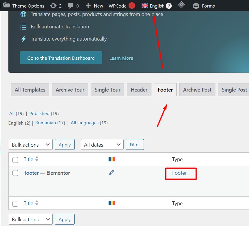

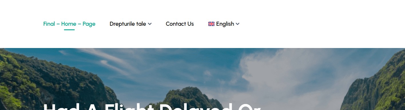

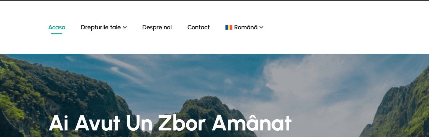

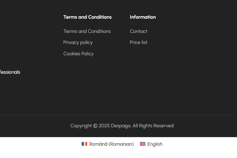

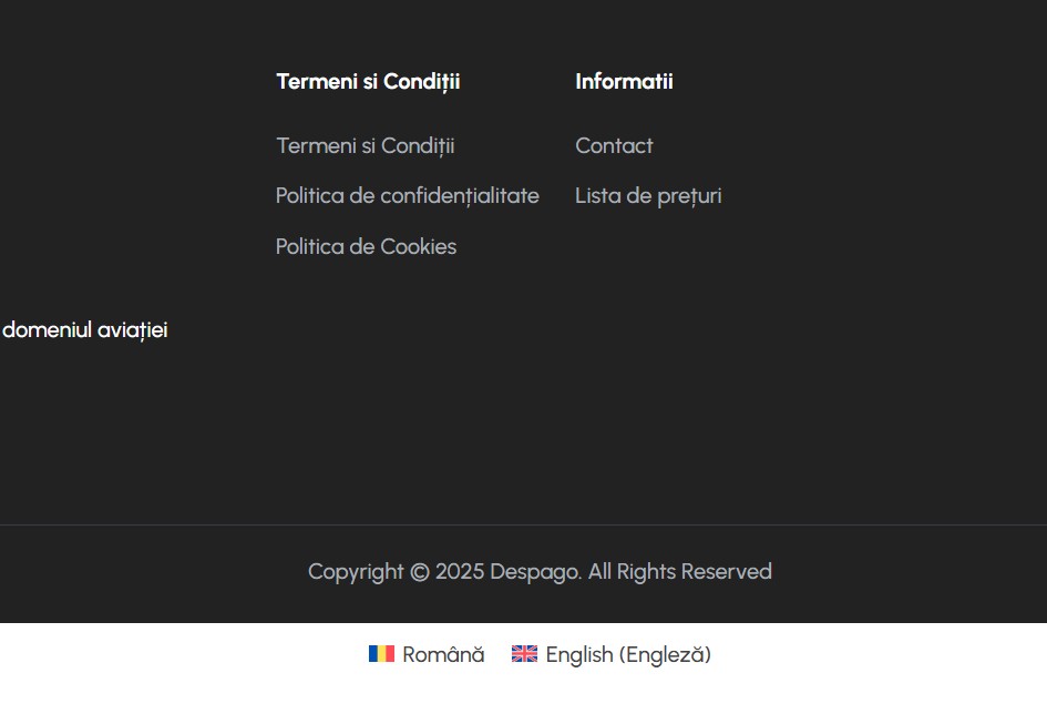

May 8, 2025 at 2:43 pm #17012640
Noman
I noticed that the English header/footer template type was showing as unsupported instead of Header/Footer from Thim Elementor >> All templates > Header/Footer tab. To fix this issue, I followed the below steps:
1. Removed the translated header/footer template by following this doc:
https://wpml.org/faq/how-to-delete-the-translation-of-a-page/
2. Opened the default language header/footer template as Edit mode:
3. Duplicate them into the English language.
4. Edited the translate header/footer templates in WPML Translation Editor and pressed the Complete translation button.
Now it seems to show the correct layout and translation at frontend. Could you please check and confirm?
Thank you
