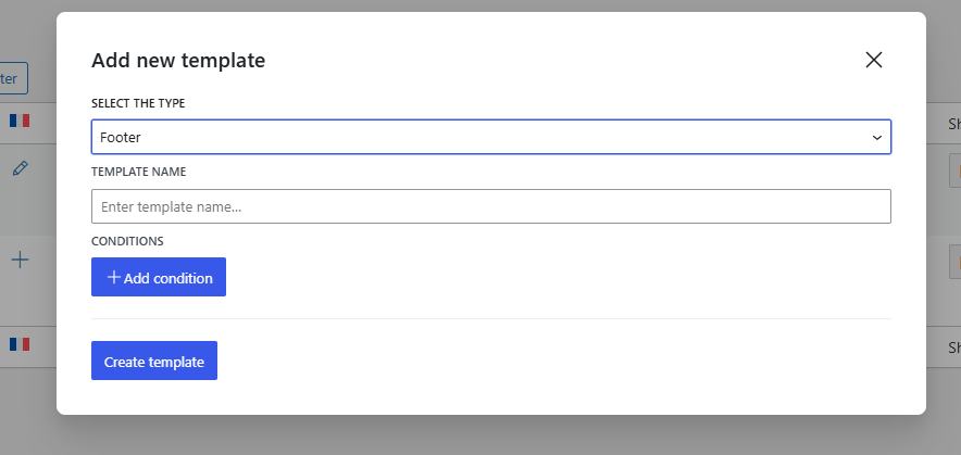

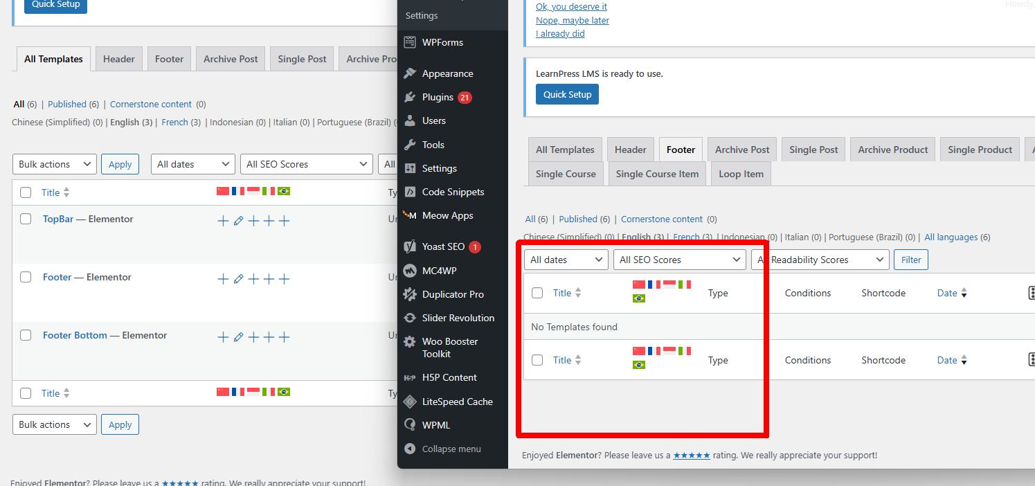

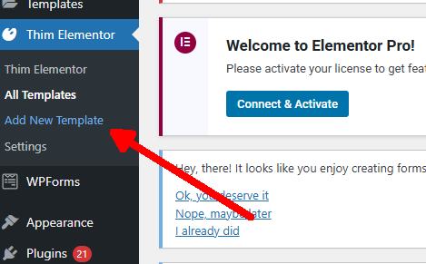

We are unable to determine how these footers are being retrieved on the frontend. Moreover, they don’t appear to be added as Footers within the Thim Elementor Templates (see my screenshot).
What if you create them using "Add New Template", assign them as footers, remove the ones currently in use, and then proceed with the translation?
This approach should work, as it does on the sandbox site.

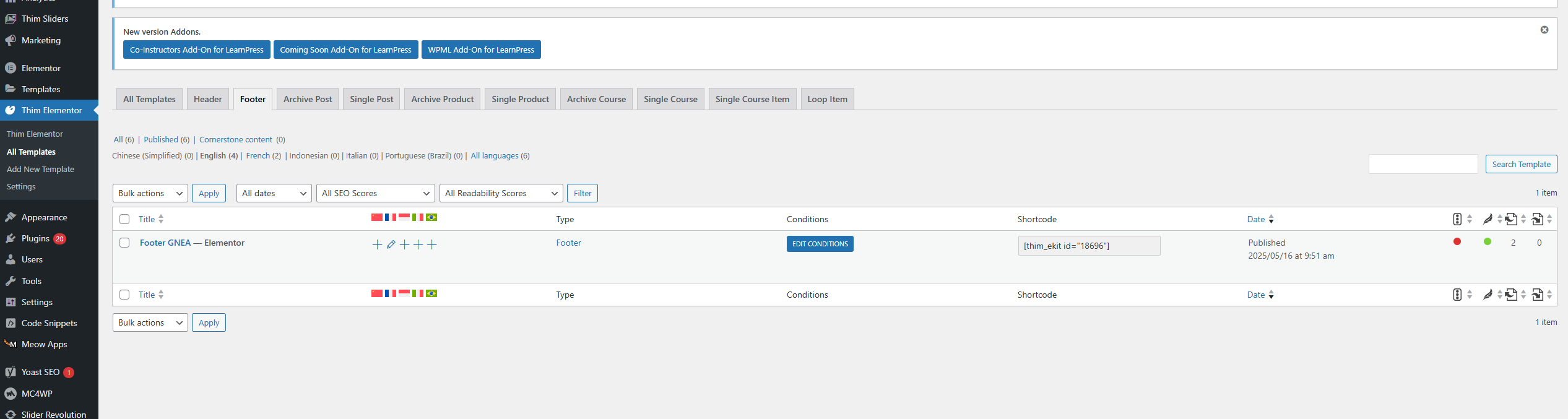

I tried to make the modifications as you said, but it still didn't worked.
I added a Footer through Thim Elementor templates.

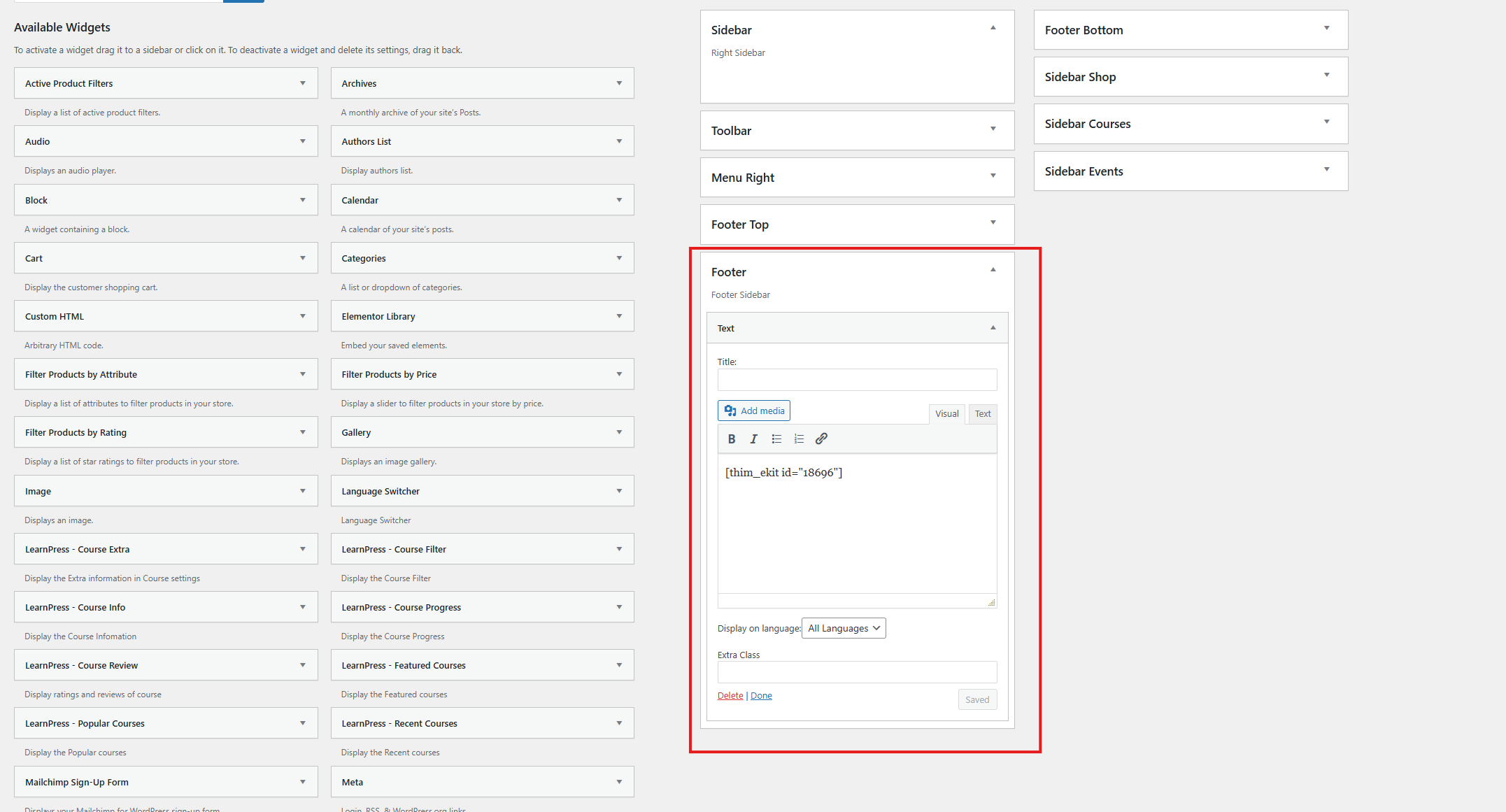

I also just figured out that the footer part was implemented through a widget, using the shortcode of the template into this part of the website.
There is a button that allows me to choose in which language to choose to display the footer. Does this have to do with something ? Should I create 5 different footers and choose for every language ?

Yes, that will work, given that this is how you invoke these templates.
I added [thim_ekit id="15565"] to show on French only and this seems to be working:
