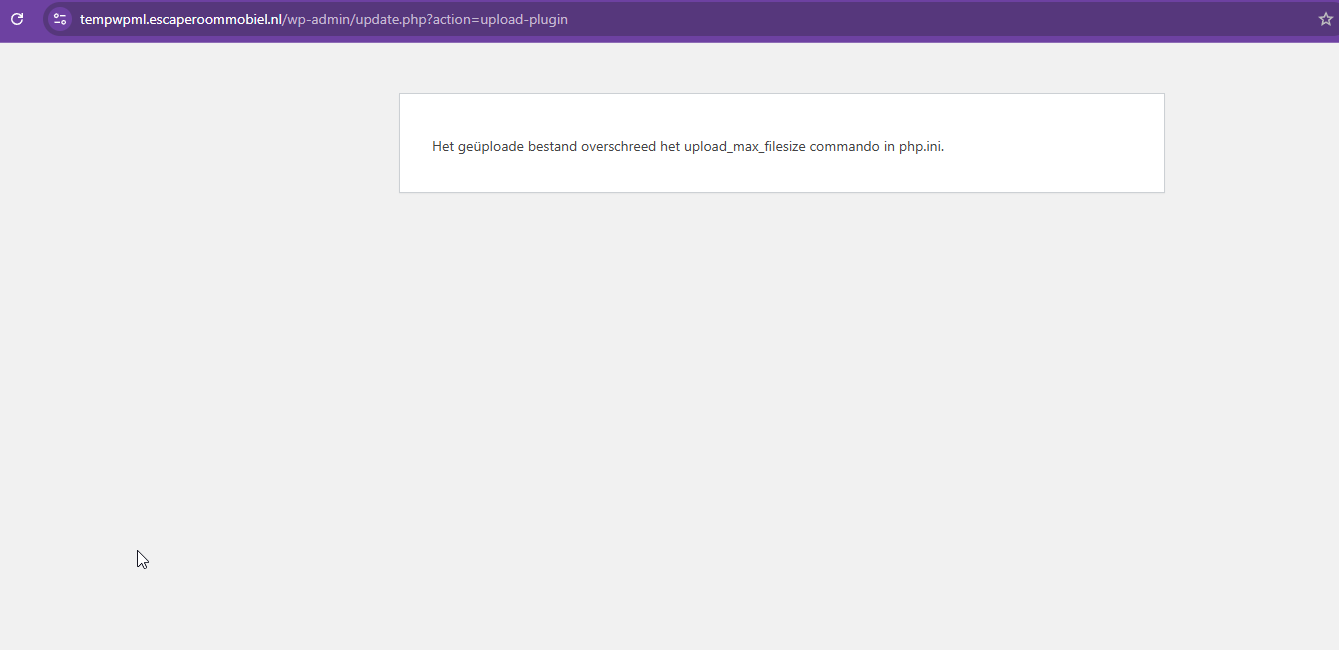

Thanks for your patience. Could you please check your server's PHP limit? I tried to update the WPML plugin to the latest version before escalating the report that I've prepared, but I'm getting "Het geüploade bestand overschreed het upload_max_filesize commando in php.ini." as shown in the attached screenshot.

I've increased the Max Post Size in PHP Settings

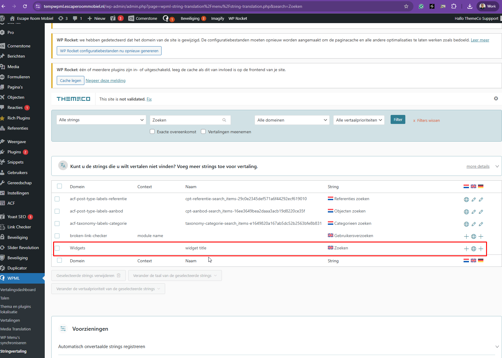

Thanks for your reply. I've checked your footer template, and it's displaying Widgets. Have you tried translating the widgets using String Translation as shown in the attached screenshot?
Also, it looks like the cornerstone templates cannot be translated using the WPML's Translation Editor, as explained here hidden link .
