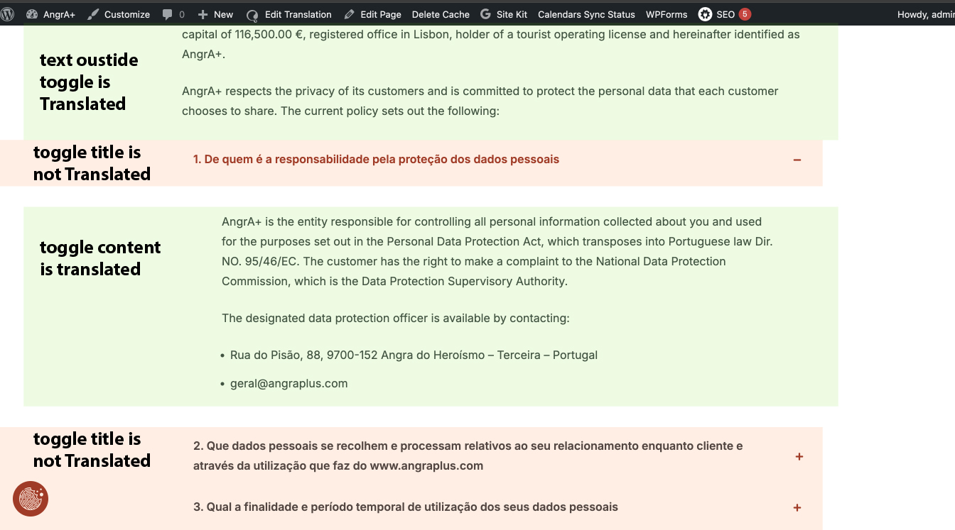

joaoR-15
Hi.
WPML is not translating the string on the Getwid Toggle titles, and I can't find how to do it.
I Attached an image to show the problem.
Translated website page with the problem: hidden link
Translated website page with the same toggle but no problem in translation: hidden link

Hi João,
Thank you very much for sharing the information requested
I have registered the Gutenberg block that shows the Getwid Toggle element as described in this guide: https://wpml.org/documentation/support/language-configuration-files/make-custom-gutenberg-blocks-translatable/ and now you can see the content correctly translated.
I left the Multilingual Tools plugin installed and deactivated, just in case you need to register another Gutenberg block.
