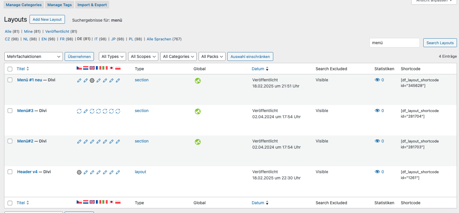

The client was experiencing an issue where the phone number in the DIVI Global Header was displaying in German across all languages, despite previous correct settings. The section to edit this header was also not visible.
We advised the client to check under DIVI Layouts where multiple Global Sections (Menü 1, Menü 2, and Menü 3) might be overwriting the header settings. By opening these sections and searching for the phone number, the client was able to locate and correct the numbers. Additionally, to allow translating numerical values such as phone numbers, we provided a code snippet to be added to the theme's functions.php file:

Meanwhile I could solve the problem with the phone numbers in the header.
Under DIVI Layouts we have 3 Global Sections (Menü 1, Menü 2 and Menü 3). These 3 sections are all part of the header and I think they overwrite what we edit in the header.
I followed your previous instructions and opened for example Menü 1 and searched for "+". All of a sudden the phone numbers appeared!
Let me know anyway how it develops further for the topics above.
Thanks for your help!
Stefano

Thanks for your reply. I'm not sure if I'm getting this. I've checked your menu layouts below, and are you saying that you're able to translate the header phone number when you try to translate the menu layouts?
June 6, 2025 at 3:07 pm #17114423
stefanoM-53
Hi Kor,
exactly,
I had to open the Menü #1 in the Advanced Translation Modus (hidden link) and then search with "+". Suddenly the phone numbers started appearing 🙂
